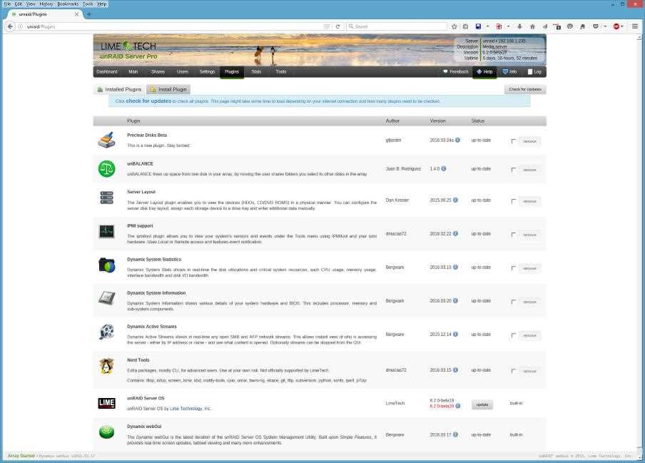

No dockers or anything else setup yet, but I do have a number of plugins (see attached pic 1).

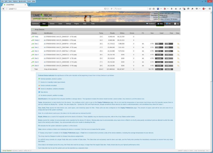

There's nothing from the main page that indicates there is anything wrong with any of the drives (see attached pic 2).

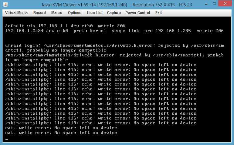

I do have an error message in the console window (see attached pic 3) ;
cat: write error: no space left on device

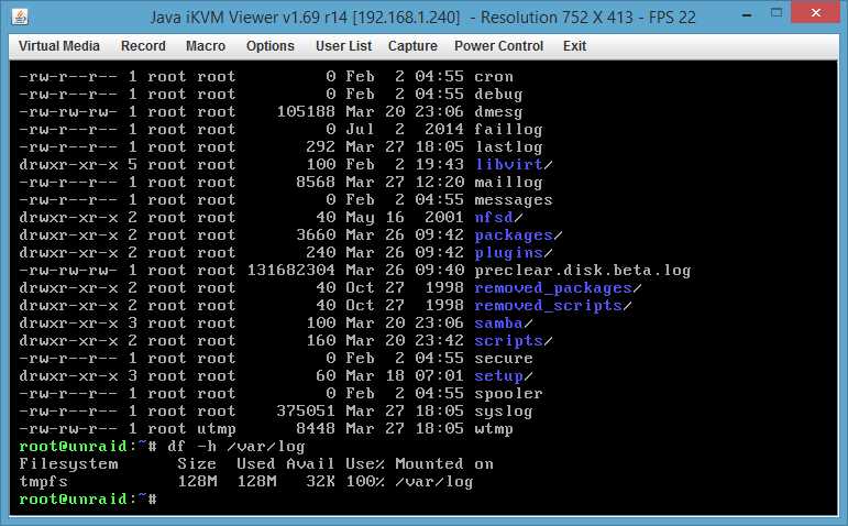

Something has filled up your /var/log folder.
Can you show the output the following commands:
ls -l /var/log
df -h /var/log

Thanks for the response.
I've attached the output of both.
It appears that the Preclear Disks Beta plugin has a 125MB log file.
What's the process of clearing down a log file? (I assume it's likely to fill it up again before its completion, so I'll have to do it more than once)
Is there any way to extend the size of the var/log directory?
So if the log directory fills up that tends to have the affect of affecting the shares?
I'm running the System Stats plugin from 2016.03.19 which is reporting it's up to date.
You can extend the allocated memory by using the following command (in this case it is extended to 256MB from default 128MB)
mount -o remount,size=256m /var/log
When you put this command in your go file as well, then upon each reboot extension is performed automatically.
