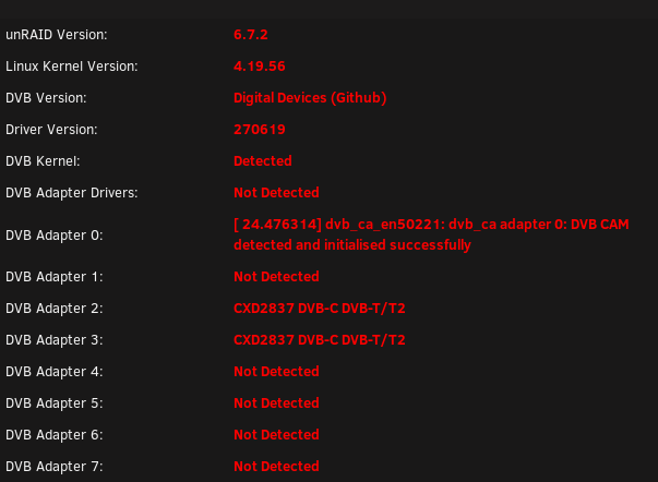

I've installed the Digital Devices (Github) 6.7.2 Image to my Unraid server but it won't work properly it find the adapters but it shows that the 'Adapter Drivers' are not detected. Also tried to reverting back and reinstalling/downloading the image.
I'm running 2 Cine CT V6 (one in the PCIe slot and one extension card attached to the Cine CT V6 extension port) and a Octupus CI Duo (in a PCIe slot).
I've also added 'ddbridge.msi=1' to the syslinux.cfg otherwise only one card is detected. Got it to work by removing it from the syslinux.cfg
Am i missing something or do i have to remove the Octupus CI Duo card?
Edit: Got it now (still doesn't detect the Adapter Drivers but it works now with the TVMosaic Docker) but only works partially only 2 of the 4 tuners are available and the CI interface is not showing up, can somebody help me out?
Edit: Got now 3 of my 4 tuners working but the DVB Adapter Drivers still says that it's not detected but it works with the TVMosaic docker. The only question that i have is why are only 3 of my 4 tuners are detected?
