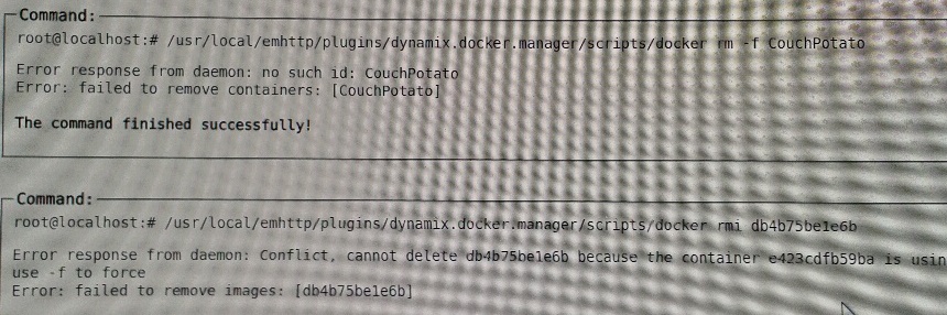

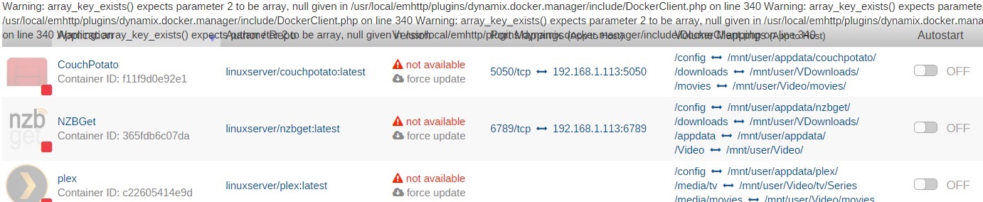

I installed the filebot docker and now I have this:
How can I kill the container?

Thanks, I rebuilt all of the containers, which worked well, except CouchPotato. Apparently CouchPotato was cohabiting with FileBot.  :o
So I ended up with two CouchPotato containers, except one wasn't really CouchPotato, as I could not kill it by name. But I could see it's ID on the screen, so I killed it from the CLI. Then recreated the real CP.
Everything seems OK now.

Other than the picture I posted with the Docker error, I have a picture of the container error. But I did not take a picture of the two CP containers.
I don't think I selected a proper template so that's what caused the issue.
It was container e423...... that I killed from the CLI.
