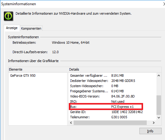

After running some benchmarks it seems that my GPU is not even at 50% of its nativ performance on bare metal.
Cine bench (OpenGL part):
    nativ: 90-95 FPS
    VM: 33-40 FPS
I looked a bit closer and found something suspect in the nvidia systeminformation. The GPU seems to be passed through
as PCIe x1 instead of x16 (see screenshot) which would be a perfect explanation of my performance issue.

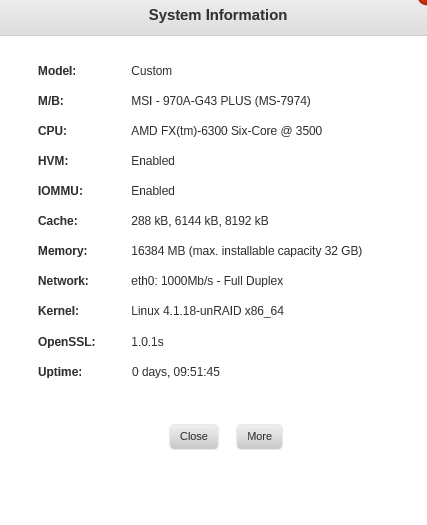

Mainboard and CPU can be found in the unRAID system info below.

What does GPU-Z say for its Bus Interface?
And what about physically?  What slot is the GPU plugged into? Other pcie devices on that system?  Any BIOS settings you can toggle for pcie link speed?
It's more likely a problem with nvidia's utility.  I had the same issue and was chasing my tail a bit..  Try downloading lspci for Windows and see what it tells you.  Nvidia told me 1x no matter what I did, but lspci (and gpu-z, I think?) showed the correct number of lanes.
First of all thank you for your quick response!
@ fatalfurry: GPU-Z told me that the GPU is connected over x16
@ jonp: The card is physical on a x16 port (same port during in bare metal test).
There are no other PCIe devices in my system and no speedlimits set in the BIOS.
Maybe the NVIDIA software is just wrong and the device is
indeed passed through as x16 (as told by GPU-Z) but where the hack is the performance
gone?
About 95 % of the native performance, as its told in nearly every threat about this topic would be absolutely perfect.
Have you any other ideas where i loose such a big chunk of GPU power ?
Big thanks in advance
Martin

Was it really running at 1x causing low performance, or was the Nvidia config just reporting the incorrect number?
I don't know what fatal combination caused it, but it was on my test machine, and its running 6.2 now so i don't want to go back :) Actually 6.2 fixed many issues for me, including SSD performance...
You're using the i440fx emulated chipset, so you dont actually have to define another pci bridge/bus. It can sit on the root PCI bus without issue. Some drivers may complain about it, but the NV ones dont seem to. The bus configuration for windows is more about managing DMA memory space and for i440fx it seems to do it just fine on the root bus. Adding more bridges/buses windows is more likely to mismanage DMA space and not assign enough for the GPU. This can be a silent killer and slow down access to the GPU preventing it from performing to its max.
i would remove the ioh3420 device, as well as the bus fields on the passthrough devices.
GPU-z is also better at showing the PCI speeds because it shows both the max and current connection speeds. Newer GPUs will reduce their PCI spec for a power-saving effort, so you might see a max of 3.0 x16, but current of 1.0 x8
I´ve found out that the NV sysinfo is indeed wrong about the number of pci lanes the GPU is connected to.
After upgrading to 6.2 the tool consider that the card is connected over x0 lanes  :o
