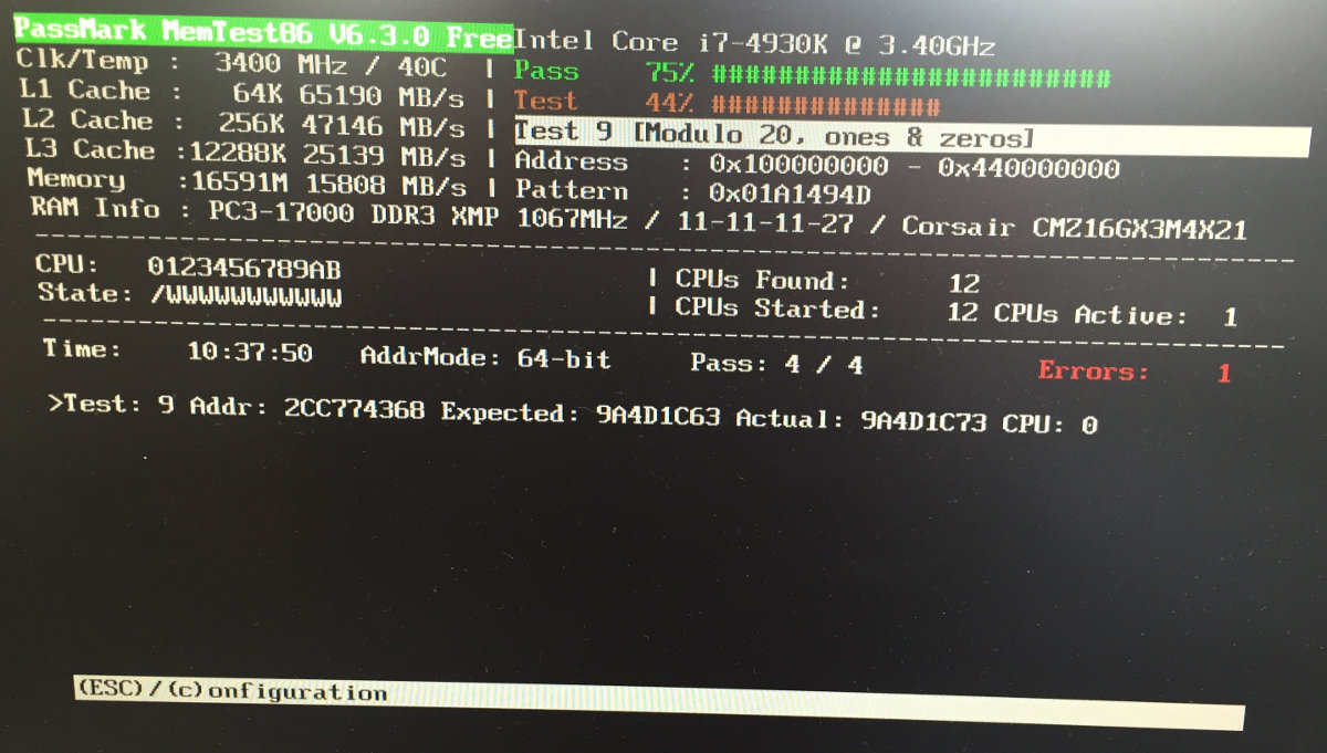

setup UNRAID6 plus, all went well. The server started the parity sync. this is where things got odd. around 10 to 20% the system would hang, for 2 mintues. then just shut down.
so i read the Marvell Sata chipset was a bad idea. so i disabled these. got the sync to do its thing.

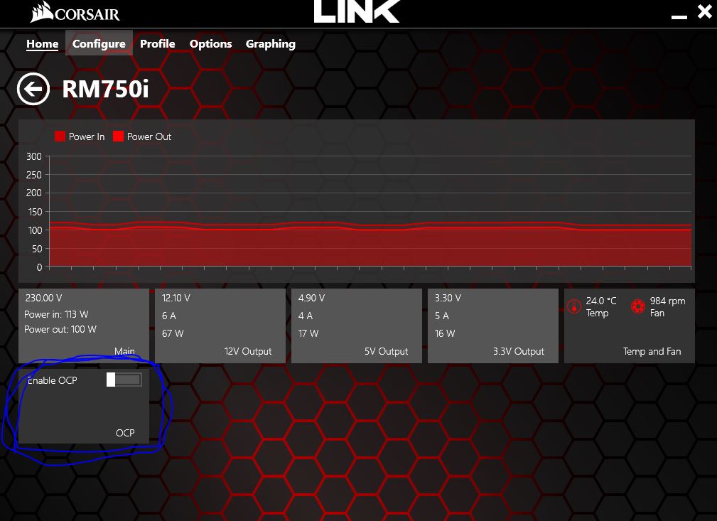

woke up this morning and the unit was off again?  :'(  the CPU/GPU is not overclocked and is currently cooled by a Corsair H100i V2 AIO Hydro/Water cooler and 2 front intake fans and a rear exhaust fan. So i dont think it is a cooling issue.
What i would love, is for some help to point me to a way to try and find out what is causing UNRAID to be unhappy.

So got home, updated the ticket as per the guide lines,
booted up the unit and started the array.
ERROR: error removing the device @missing@ - unable to go below two devices on raid1
however all drives were showing in dashboard and the parity scan started to run again.
But then again, lost all connections both my SSH and telnet connections dropped. GUI hung and webpage not available.
Then again, the system just shuts down.
No VMs started nor any dockers
The VM I currently have setup is a  WIN10 Vm with GPU pass through. (sea bios)
The only diff i can think of since my testing phase on the UNRAID trial, is there are more disks now with the licensed UNRAID 6 plus, and instead of a WIN7 VM i have a win10 VM.

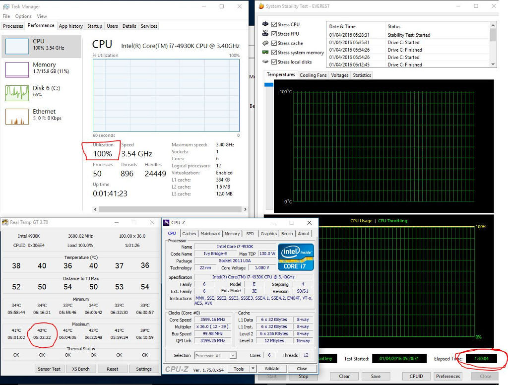

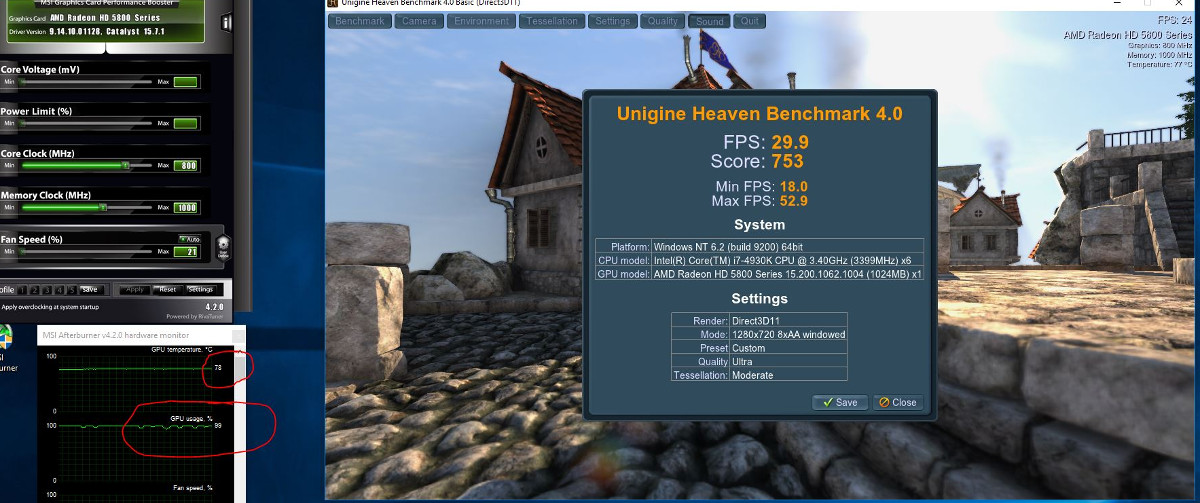

Never heard of a system just shutting down unless there is a hardware issue.  It is typically due to the CPU overheating and the system auto-shutting down to protect it.  However you seemed to be reasonably certain that was not it.  Is there any other critical fan that might have stopped working?
Currently running a tail -f on the GUI and in telnet and SSH putty sessions. Lets see if i can grab anything useful.
As for the cooling, The only fan i have not checked would be the GTX745 GPU.
If the server hangs up again, i will pull that card and boot and server with only the HD5830 GPU and re-test.
So here is the tail log, the server ran all night without problems. got home today... server off!

Made a window10 usb boot drive. Booted the UNRAID box into win10.
1. Stress tested the computer at full load over the 6 cores (12 threads) for more than an hour and half. max temp seen on any core was 43'c - PASSED
2. loaded MSI afterburner and Unigine Heaven. let Heaven to run on max setting in a windowed 720p res until the temp of the GPU temp settled, then run the benchmark - PASS
3. created a USB boot flash from Memtest86, boot the computer into memtest last night and let it run. This morning it was 75% done with the final memtest pass. (10 and half hours later)
showing 1 error in 10h30min - in my books - PASS for non ECC ram
so what now?

Ok, so i have finally had some success.
Turns out the Corsair PSU RM750i (these full mod and digital PSU) have a safety feature that is meant to safe hardware if it detects any issues. However i think this setting is a little to safe!
these unit are also meant to be silent, and the fan only comes on around 40'c.
so i have set the fan to 50% all the time and turned off the OCP setting (the odd save the hardware if anything odd is detected setting)
So after all this the server run for 3 days and 2 nights, under real load. copying 1.5TB into the array and plex doing its thing.
I have re-add the 2nd GPU and the Sata controller card.
Now i will check the unit , leaving it on and see if the server stays stable and running.
Corsair PSU was the problem.
If you have issues with your UNRAID server and have a digital corsair PSU.
Plug the corsair link cable to the PSU and a laptop and install corsair link.
If your unit is one of the newer version , if not you might need to do a windows 8/8.1/10 USB drive install [http://www.easyuefi.com/wintousb/index.html] to use the non standard USB cable to the USB header on your motherboard.
Turn off the OCP setting and set your fan to run all the time. 50% is almost silent and keeps the PSU under 30'c is my rig.
