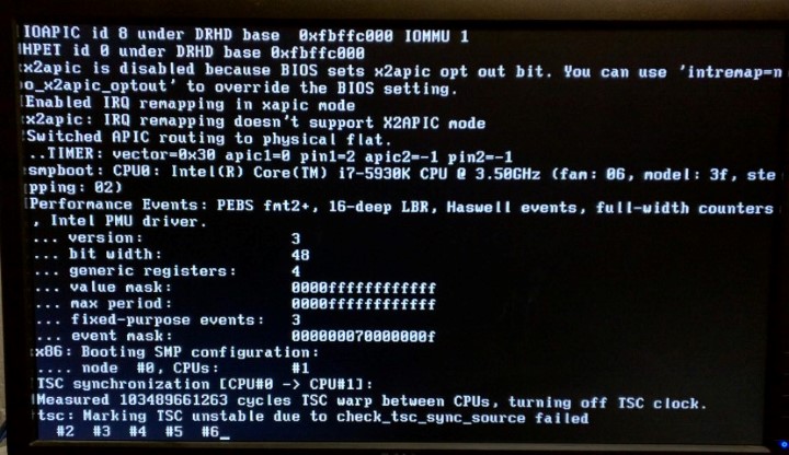

Anyhow, whatever, boot into UnRAID and sometimes it gets stuck loading at the attached screenshot screen. I let it sit there for a good 5 minutes, and it is stuck. Reboot server (button press) and it will likely load up the next time.
Continue on, but have an error in the syslog about the clock or HPET being off, and it complaining (all settings in BIOS are correct, time is correct, not sure the exact message). I then start to get a couple of these over a short period of time:

I cannot think of anything else that would be more likely than the CPU for the TSC clock sync error, and that it at times freezes at that one point (maybe this new MB I am using temporarily is partially defective, it would be unlikely, but at this point I don't know).

Also the TSC timer issue seems to be broken in some Gigabyte, and also Asus boards from my research.
This may have always been the case (minus the lockup), however I never gave it much thought.
Since I had all of these issues I'm much more critical of things looking out of place in the syslog.
I think the pcierror's I received are also related to the XMP setting that I have always used on the other (exact same) MB, and not knowing it didn't work quite right with this one.
Since disabling it, running the Memtest, and then booting up UnRAID (going on 12 hours here) that message has not returned!
So I may be out of the woods soon, and my trigger finger may need to be relaxed from picking up the HX850i I have my eye on (currently on a pretty good sale) here: http://www.newegg.com/Product/Product.aspx?Item=N82E16817139083
Edit: Found an old syslog from my previously good working board..
Same exact TSC message, just never noticed. So with that, I think the CPU is fine.
