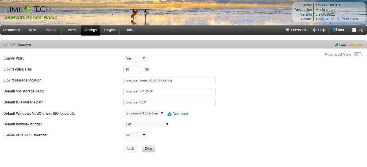

I just upgraded to 6.2 and made sure my 'auto start' was turned off for my two VMs. However, now the VM Manager says that it's stopped and I can't turn it on :/

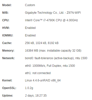

Tried that several times. Even tried resetting the whole OS. Nada. The specs say everything is compatible/enabled. Any ideas?

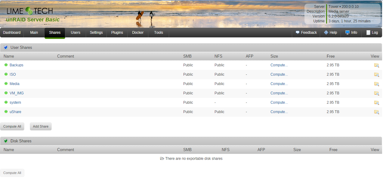

Create a share called "system" and all will work.
Cycled the VM Manager, here's the diag.
I tried adding a share called 'system' twice, and then cycling the VM Manager, but it stayed 'stopped'.

First thing I would do is update to the latest beta just to rule that out
Under default storage path for both ISOs and virtual disks, please remove the trailing slash and try applying.
Thank you both.

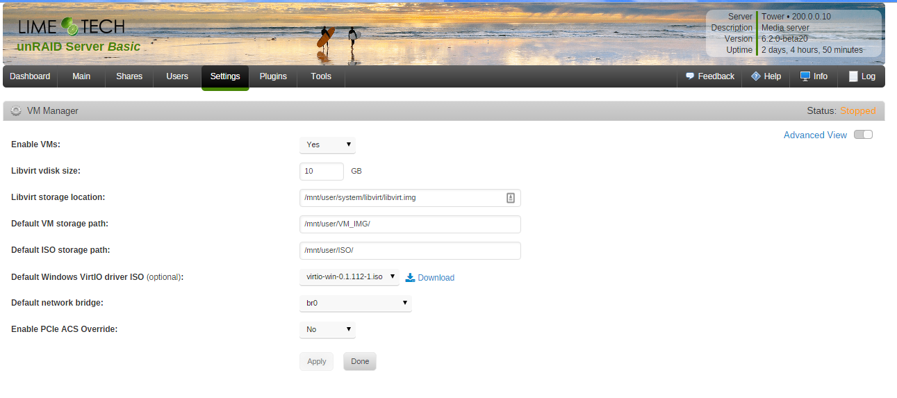

I updated to the latest "beta" .21 and tried removing the trailing slashes. After removing them and clicking "done" it re-added them.
Thank you both.
Change libvirt storage location to read this:
/mnt/user/system/libvirt/libvirt.img
Sent from my Nexus 6 using Tapatalk
Same result :/ I removed the '/' on the end of the others as well, and it replaced them.
I get the feeling that it's something really small and stupid...but I can't figure it out  :-\

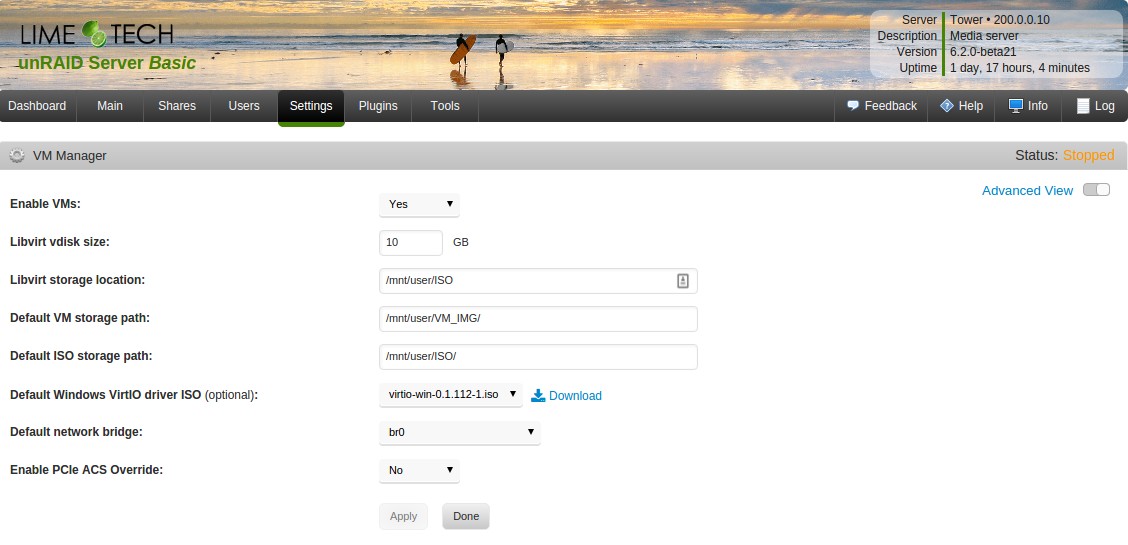

Change your libvirt,img path
I had the same problem, moved libvirt, now I can see the VM tab and the Libvirt volume info appeared in VM Manager :D
Ok! So!
I didn't realize you had to enter an actual file name...
+ Create 'system' share
+ Entered "\mnt\system\libvrt.img"
voila, it works!
