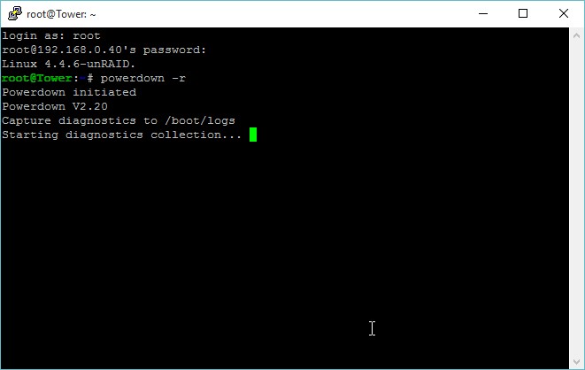

For a second time now I get the server runing 6.2b21 locked while running SyncBack between two unraid servers.
Source is running 6.2beta21 and destination is running 6.1.9.
The system GUI freezes, Dockers and VM's are not responding, ssh is still working but when launching powerdown the command freezes at: "Starting diagnostics collection..." see picture attached.
Luckily the cp /var/log/syslog /boot command worked so I can share the syslog file attached.
Some comments, many probably unrelated to your issues, but ... -
* Several devices report only 32 bit DMAR, r8169 (your Realtek NIC) and certain USB ports.  I'm not very knowledgeable in this, but I don't believe that's going to work correctly, especially virtualized.
* NerdPack reports installing Python 2.7.9.  I believe you need 2.7.11 for 6.2 betas.  Edit: Later 2.7.11 is installed also.
* The packages libevent-2.0.22-x86_64-1 and ncurses-5.9-x86_64-4 are already installed, but the Preclear beta *upgrades* them with /boot/config/plugins/preclear.disk.beta/libevent-2.0.21-x86_64-1.txz and /boot/config/plugins/preclear.disk.beta/ncurses-5.9-x86_64-2.txz.
Apr 19 02:36:57 Tower kernel: DMAR-IR: x2apic is disabled because BIOS sets x2apic opt out bit.
Apr 19 02:36:57 Tower kernel: DMAR-IR: Use 'intremap=no_x2apic_optout' to override the BIOS setting.
Apr 19 02:36:57 Tower kernel: DMAR-IR: Enabled IRQ remapping in xapic mode
Apr 19 02:36:57 Tower kernel: x2apic: IRQ remapping doesn't support X2APIC mode
* Don't know if it's important but kernel people are recommending the options above.  You might also check the BIOS settings, and check for a BIOS update.
* Strongly recommend you switch to static IP (192.168.0.40).  That should clean up some of the errors.  The first renewal does not seem to proceed completely correctly when virtual networking is involved, not the first time I've seen that.  Can't say it caused your problems, but it would be interesting to see how it behaves when changed.
* USB devices were disconnected near the end.  That's fine if you did it, not good if you didn't.
* Powerdown started but got nowhere.  What ever the first actions, they didn't happen.  Possibly user or system kill scripts to stop VM's and Dockers?
