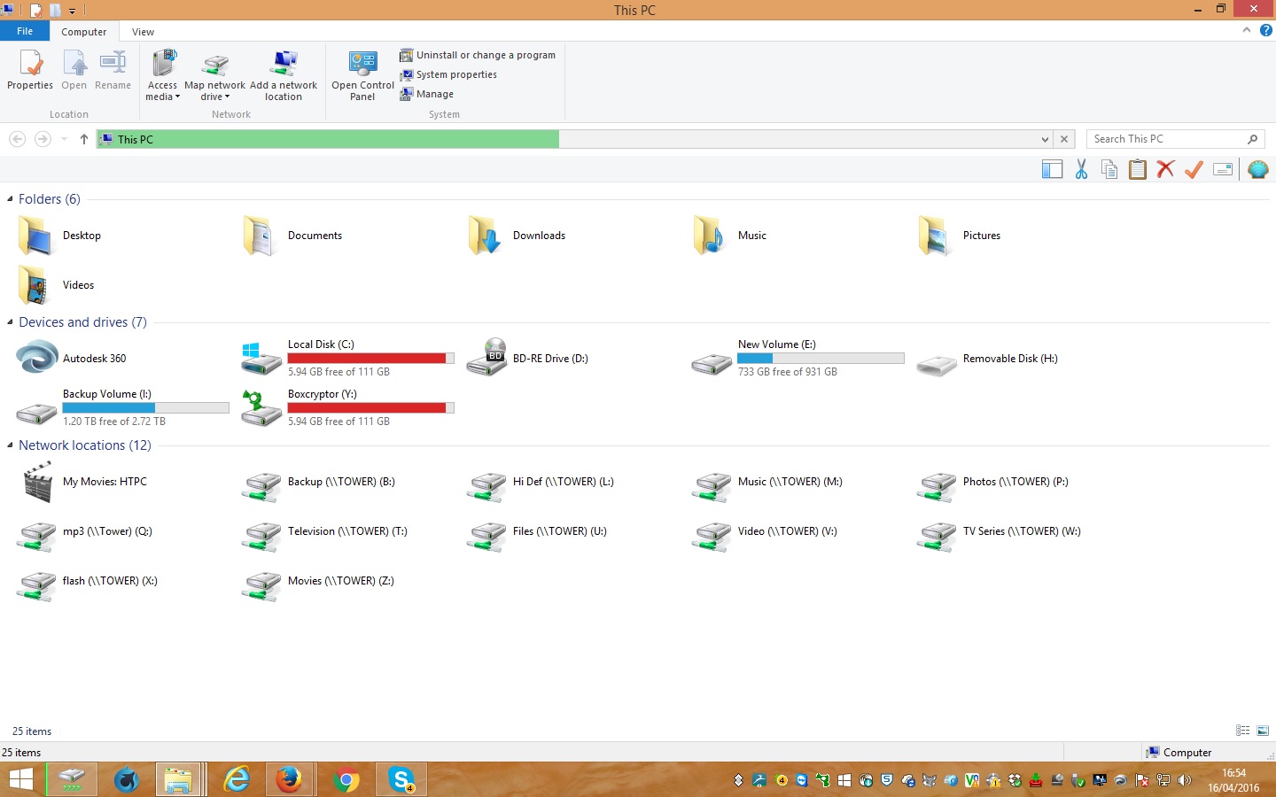

My array had behaved itself for a number of days OK running 6.2.0-beta21, and I was able to copy files to it OK.
However this afternoon, whilst copying some files to a mapped drive, access to the drive suddenly disappears & Terracopy / Windows Explorer both hang
Please find attached diagnostic file
I fully appreciate that LimeTech are looking into this issue, as I understand that other people are having similar problems too.
I am seriously considering stepping back to 6.1.9, but I would loss access to the second parity drive which I have just installed.
tower-diagnostics-20160416-1619.zip
Further to the above post, attached is a screenshot which shows that all mapped drives to the array have disappeared.
The green bar travels across the screen, but the mapped drives do not reinstate themselves

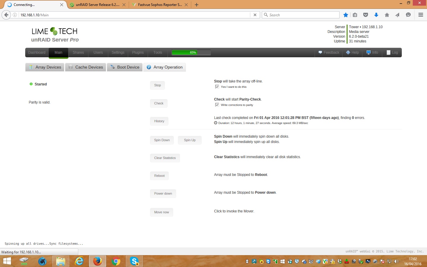

Here is another screenshot, showing that after the array hangs, I have tried to stop the array.
The GUI reports that drives are being spun down, however the GUI is not refreshed when the array has been stopped, with the result that I have to reboot the array manually.

Another issue I have just found is that after rebooting after the initial hanging issue this afternoon, I then tried moving files in smaller amounts.
I copied the first batch of files, Terracopy confirmed that they had copied OK, and I manually checked that they had moved to the array.
I then tried to move the remainder of the files, and the array hung once more.
On rebooting I found that the first batch are now not shown???
Just to confirm, the share which I am copying to is not using a cache drive, so I can't see it being a cache drive problem.
PS Now just to confuse matters, I have just made Windows Explorer the default for moving files instead of Terracopy
Touch wood & cross fingers - so far I have been able to move files without the array crashing??????

I have had problems in the past with Terracopy copying files.  It was usually related to files which required Administrative privileges and Terracopy just failed in some manner (I don't remember the circumstances) to finish.  The Windows Explorer copy would display a popup which had a 'button' to use administrator privileges.
I have just copied an 8GB file to the share that uses the cache drive
The file moves from the cache drive to the array share drive correctly, and the array is running normally
I have used Terracopy for years with no problems, I have seen the array crash using Terracopy to 2 different PC's, so it is not a problem with a single copy not behaving properly?
Syslog shows a fine system, no apparent issues at all.  I have to wonder therefore if the issue you had isn't on the Windows side.  If it happens again, you may want to try a third machine, see if the unRAID server appears correctly, just to determine if your problem is on the unRAID or Windows side.  I *can* say that your User Share system is using the lion share of the CPU by far, but don't know the significance of that.
