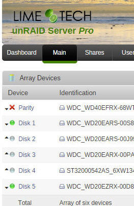

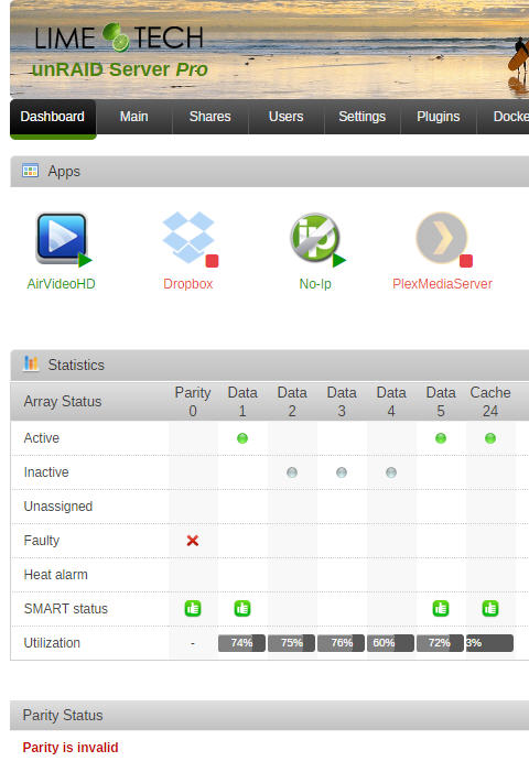

Hello,
About 2 weeks I noticed that my parity drive (WD 4TB RED, nasware 3.0) was listed as "Faulty" and the parity drive had been disabled. I assumed it to be the drive, so I contacted Western Digital and they quickly sent me a new drive. I put the new drive in, re-built the parity and had no issues for a couple of days, but now I see again that this new parity drive is listed as "Faulty" and the parity drive has been disabled again. I have no idea what's going on.
A link to my syslog is here (was too big to post.)
personal.pixelgraft.com/ExternalFiles/syslog.1.zip
Reading other posts, maybe it's the controller card going faulty or file system issues? Any advice is appreciated! At the moment, I can't write anything to the array, as I am also receiving Access Denied alerts.
Screenshots attached.

Attaching a diagnostics file I just downloaded. I ran smart tests on the drives and all came back as completed with no issues. I did "new config 2 nights ago, re-ran a parity sync and all was well for 1 night, then again, the parity drive shows as "Faulty" yesterday morning and lists the parity as invalid. I also disabled my cache drive at the moment, as someone mentioned seeing errors on that.
Could someone take a look at files and see if they can find what keeps causing the parity device becoming disabled? I did check all cables and swapped out the sata cable on the parity with a new one. The parity is connected to a 2 port sata PCI-e. I did buy a new card today, but appreciate if anyone can glean data from my diagnostics. Thanks!
