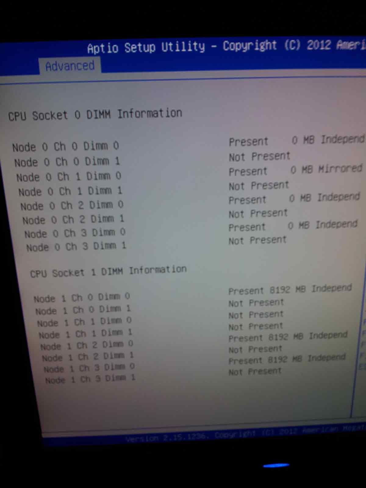

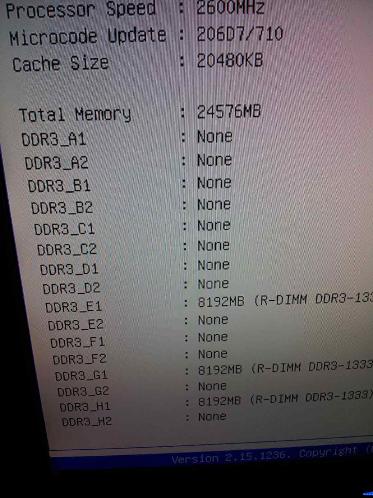

The problem is: Half of the ram is recognised in bios, but it is not working.
Every ram-module in the slots on the left side (e, f, g and h) is doing fine, but for every ram-modul installed on the right side (a, b, c und d) i get the report that the module did not pass the cpu memory test.
I rearranged the ram-modules, i tried to use only the white slots, only the blue slots,... every different module is doing fine on the left side. I also switched the cpu's but this didn't help too.
So please: Have you any advice for me? Anything to narrow down which parts may be broken? Or do i need to change something in the bios?
Thank you very much for your help in advance!
Please note that in the pictures the ram-module in f1 is missing - i didn't installed it right, i already fixed this. All the other modules are installed in the right way.
