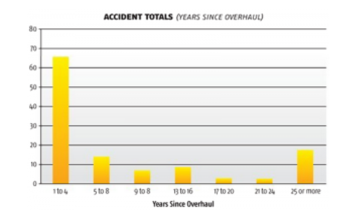

Also noted in WWII, something called Waddington effect. Basically, repair/touch anything and it will increase failures.
http://blog.aopa.org/opinionleaders/2014/01/14/the-waddington-effect/
