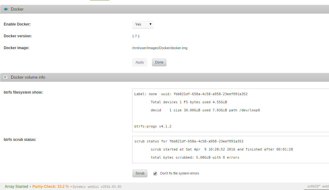

All those BTRFS (loop0) messages indicates either a corrupt docker.img file or your docker.img file is 100% full.    Settings - Docker will show the usage of the docker.img
Nothing looks out of place that I can tell from Docker Settings, see attachment.
