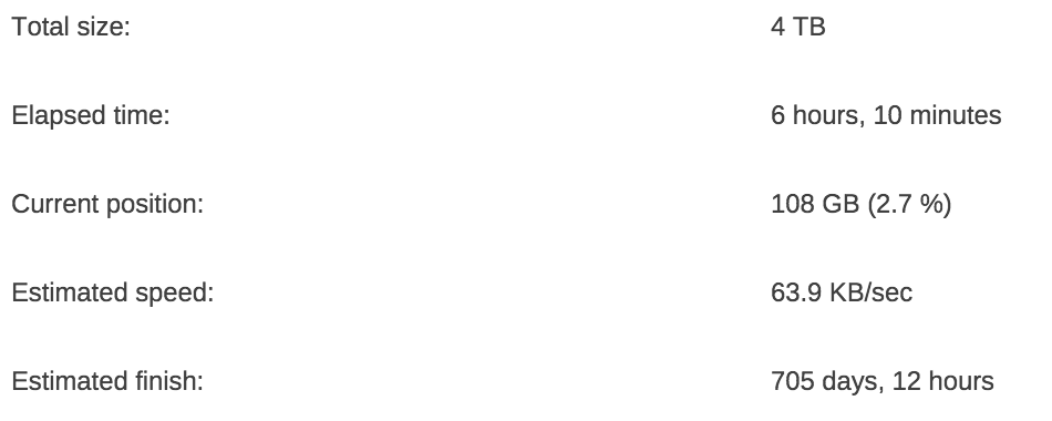

Here is another diag. The parity rebuild is showing a crazy amount of time. All disks are spun-up.

I also noticed that the disks are all spun-up but the parity sync time is now at 66 days, 23 hours, 18 minutes. I hope it doesn't take that long.

Figured I would update this. My server is now working running 6.1.9. I hope you guys can figure out what the bug is in the beta.
Have you tried a parity sync on 6.1.9 since you downgraded?
Yes it finally finished.
And completed in a reasonable time?  Just to clarify, above you stated parity rebuild, but I'm assuming you meant parity sync?
You know, I'd be tempted to try the beta again...
It did complete at a reasonable time frame. It was a full rebuild. I did a new config setup thinking that it might have been related.
I think I going to hold off for the next release before I try again. Wife didn't like server being down.
