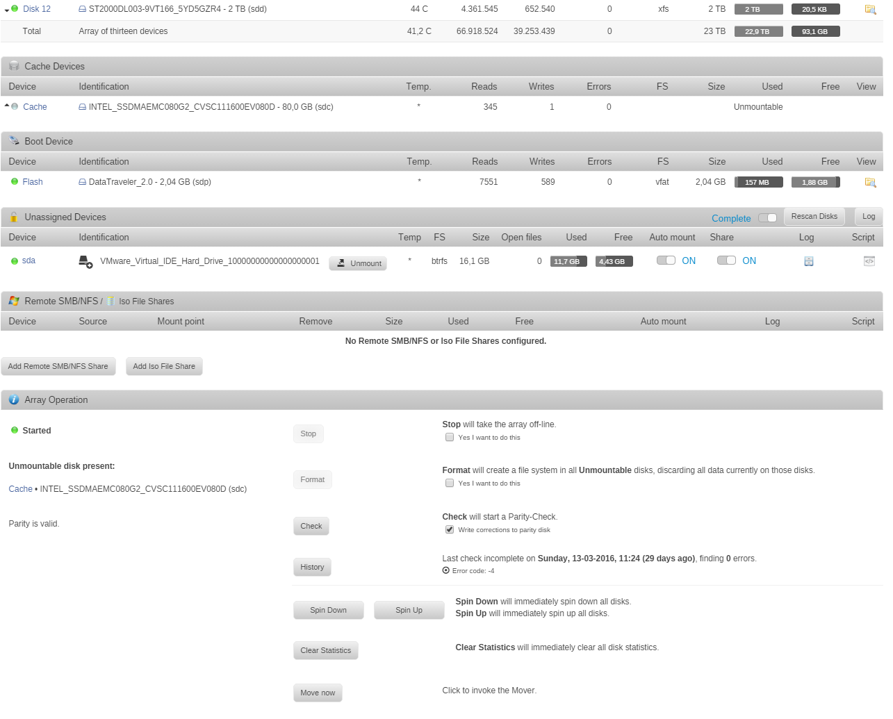

I recently swapped my laptop mSATA, so I took the old one, put it into a SATA adapter and added is as a cache drive. In the same operation, I moved the Docker file to the cache, and have the working directory ".appdata" there as well.
Now I have hust realised, that the cache drive is displaying as "Unmountable" in the UI. Looking in the logs, it says "shfs/user: cache disk full".
I don't know if the two are related, but I suspect they are.
If I look at the Docker, it still works. If I browse from Windows to \\tower\cache I can see approx. 40GB data (of the 80), but it reports 80GB occupied - can't see the rest of the data.
I don't understand that it reports unmountable, but can still be browsed to.
I also don't understand how the docker can continue working if the cache is unmountable

Logs and selected screendumps attached (had to separate syslog1 out due to size constraints).
tower-diagnostics-20160411-1801-after-stop-start.zip
syslog1.txt
syslog.1.zip
Web-UI reporting unmountable.
