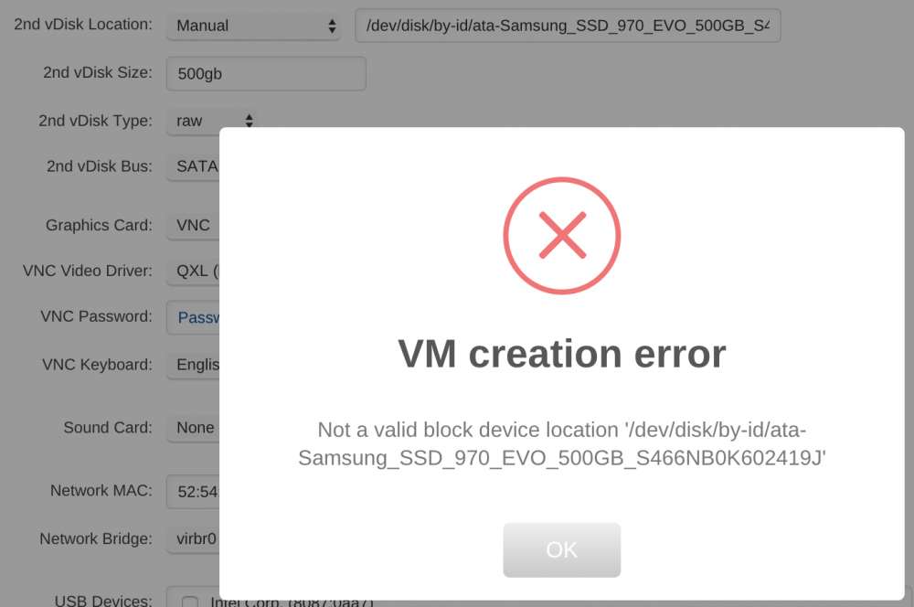

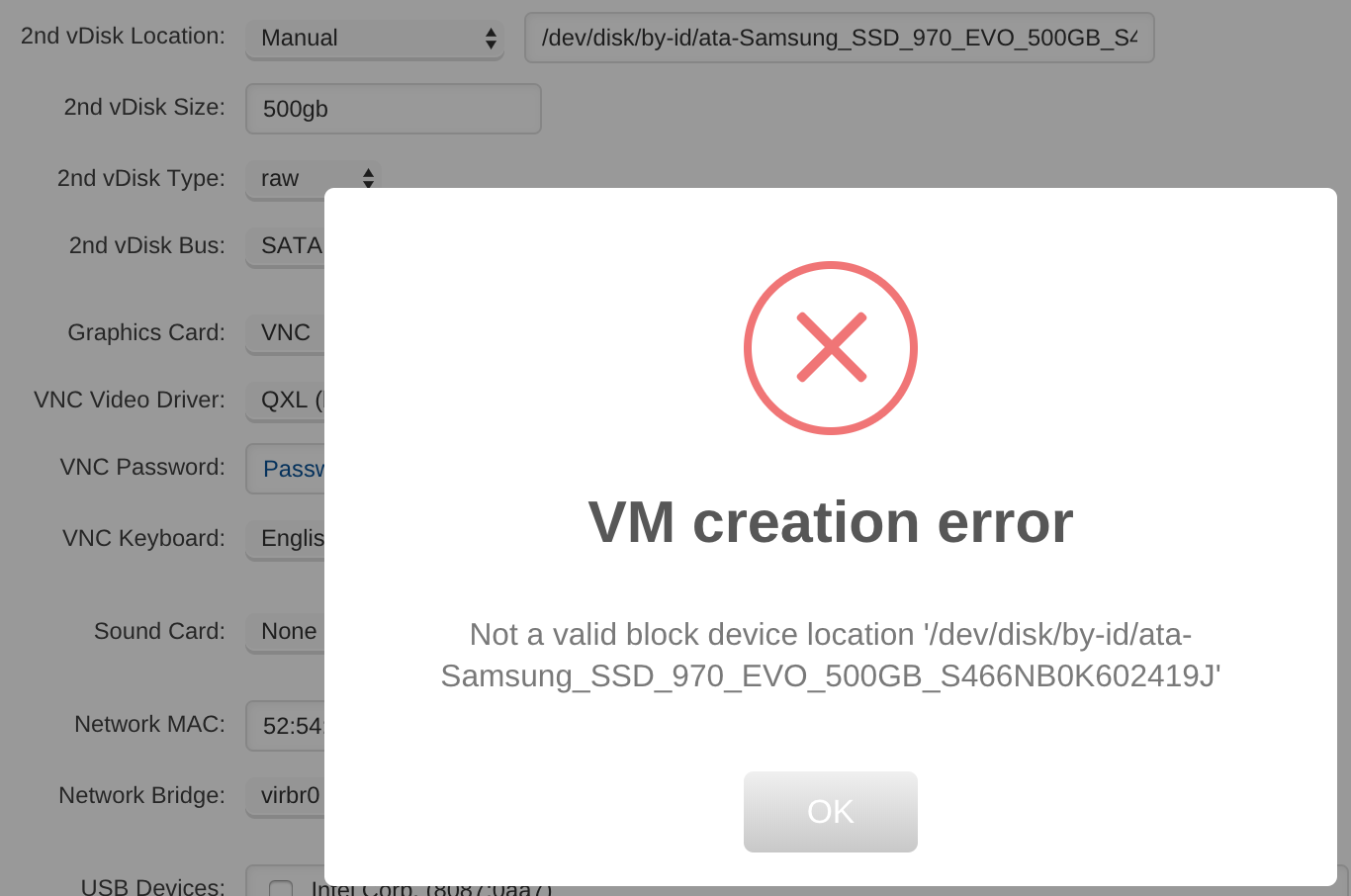

any ideas what i could have done wrong?
For nvme drives, you need to pass it through via PCIe passthrough for best performance. It's not a SATA device.
