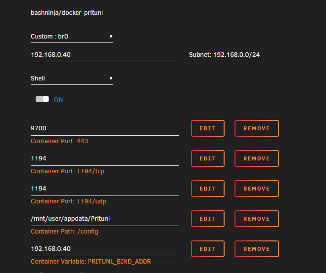

I pulled your pritunl docker image and manually installed it on Unraid. When I start the docker, the initialization process gets stuck. See the docker log as below:
As for now, I cannot access the pritunl web gui. My /config is mapped to unraid appdata folder, and when I checked all the necessary files are created.
I am on unraid 6.4 and running pritunl docker on br0 mode and setting a static ip for the docker to prevent port clashes with my openvpn-as docker.

@hus2020
I have not tested this on 6.4 yet, as I haven't upgraded. But it's working as intended for a few other machines I've seen.
That "No handlers could be found for logger" error appears for every user, but it still works just fine. You probably need to check your port mappings. Here's an example of mine:
You don't need to add this docker manually, as it is in the community applications as a beta container.

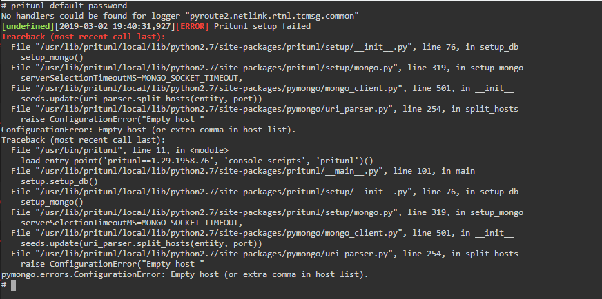

Hey
Could you take a look at Pritunl when you find the time?
I have tried installing it and it keeps throwing all kinds of errors about ports being in use although I tried the docker in br0 as well as other modes and ports are 100% not in use.
