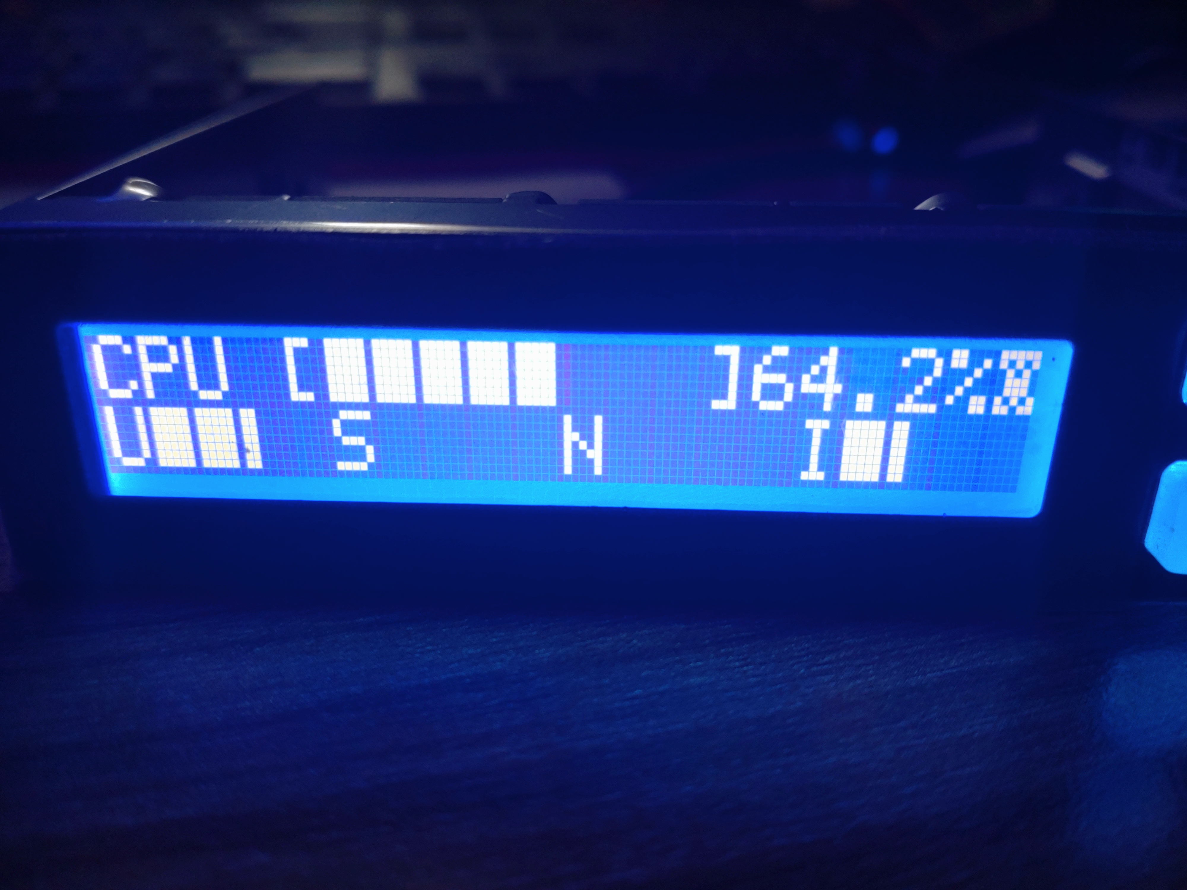

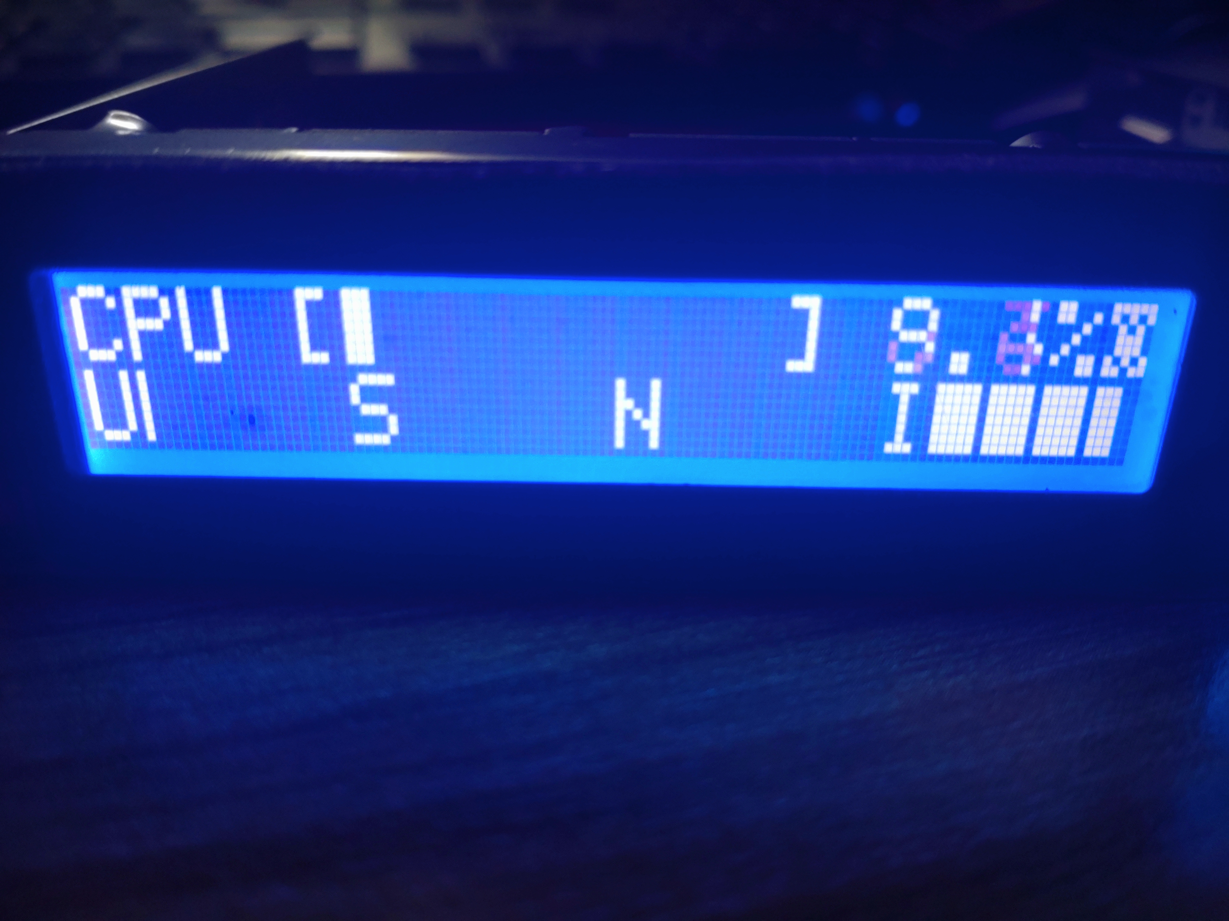

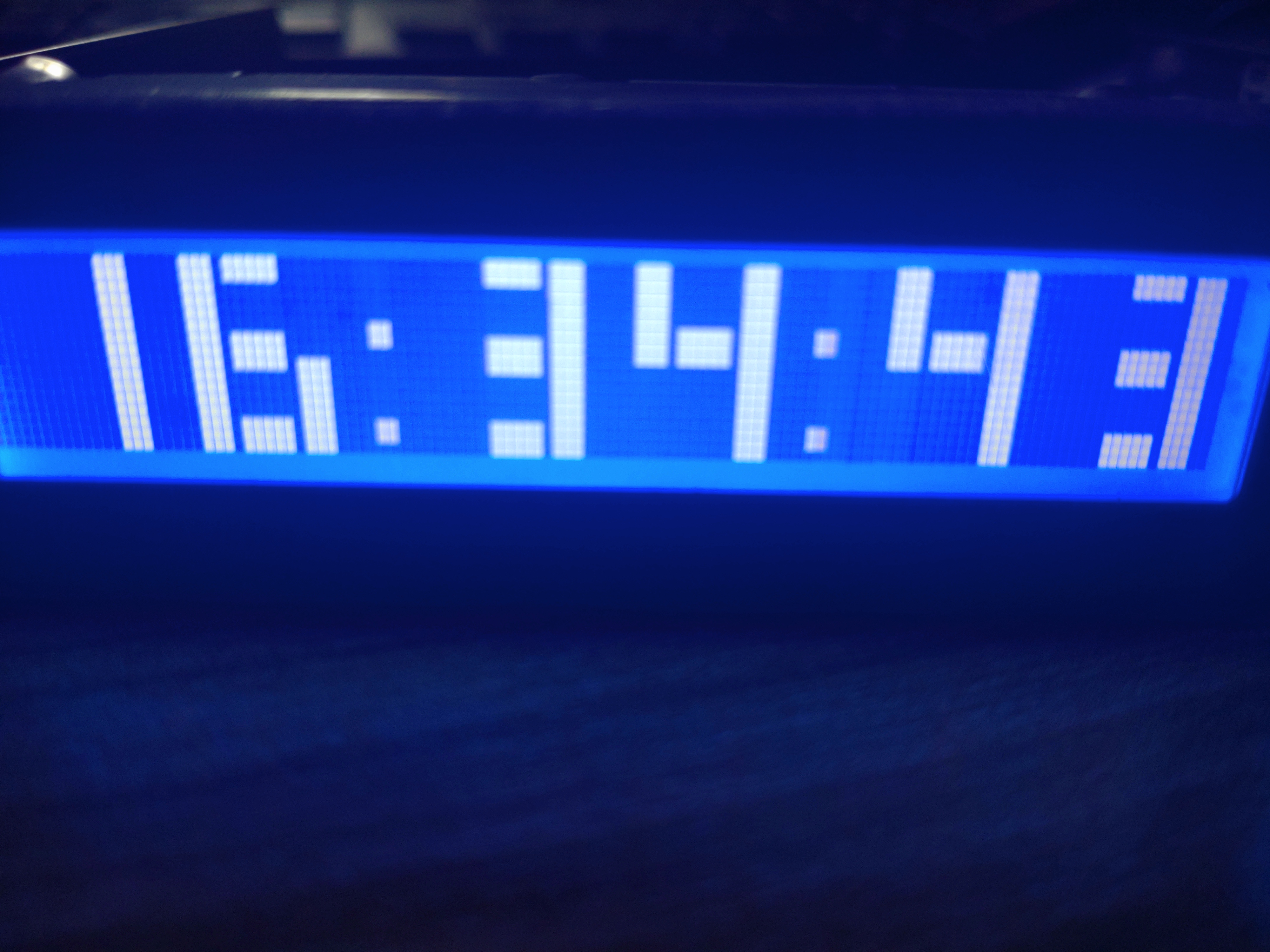

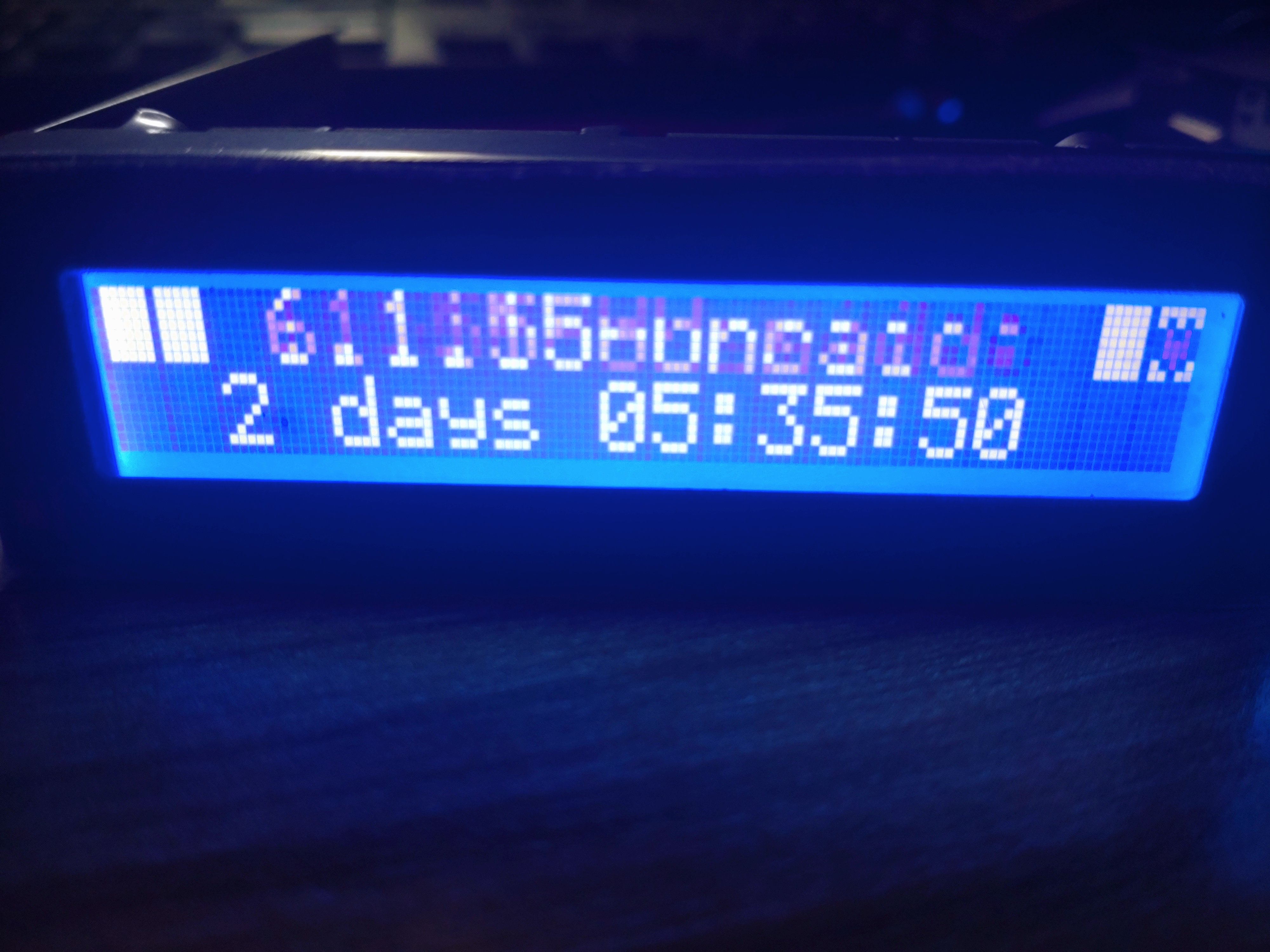

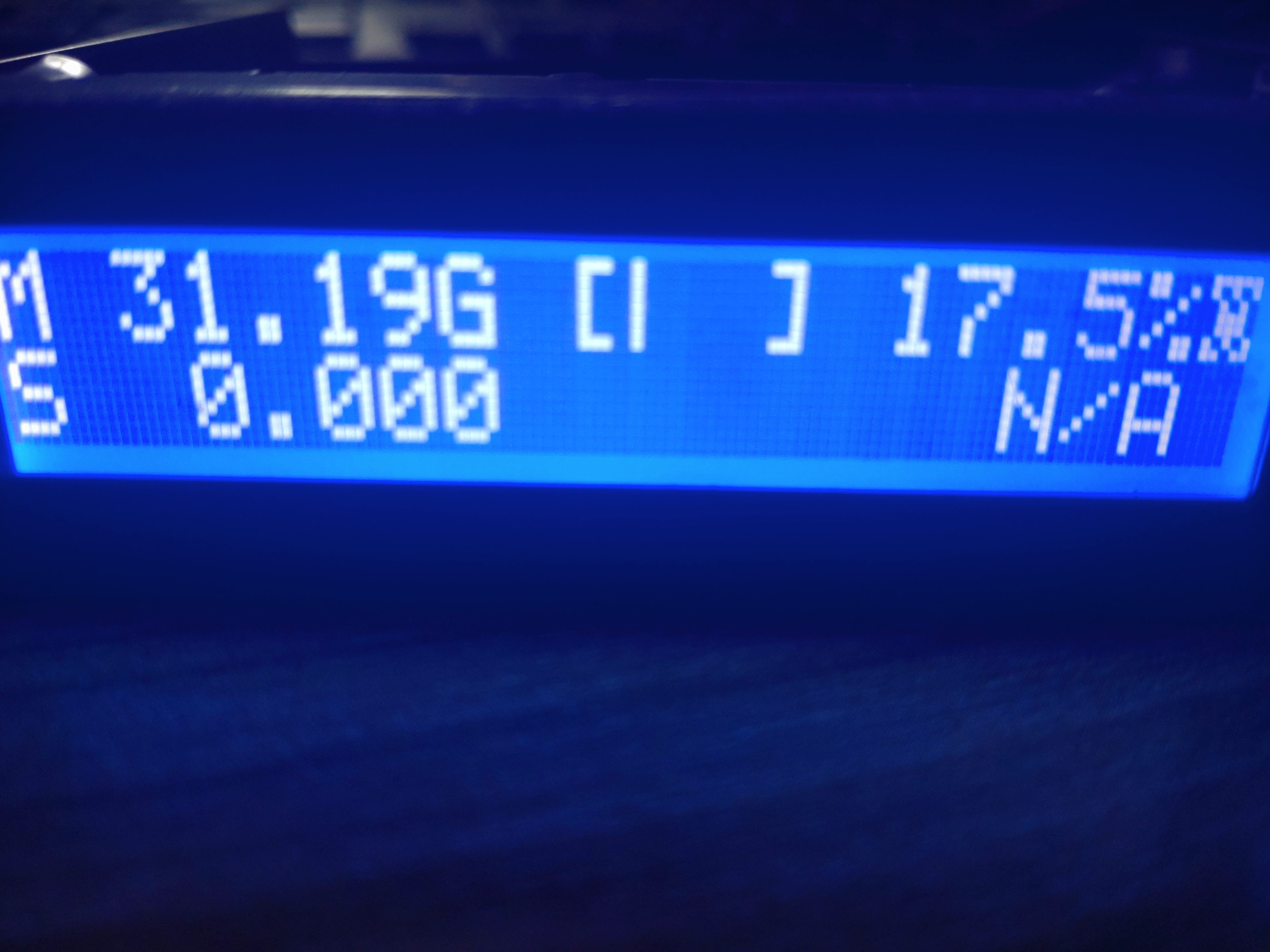

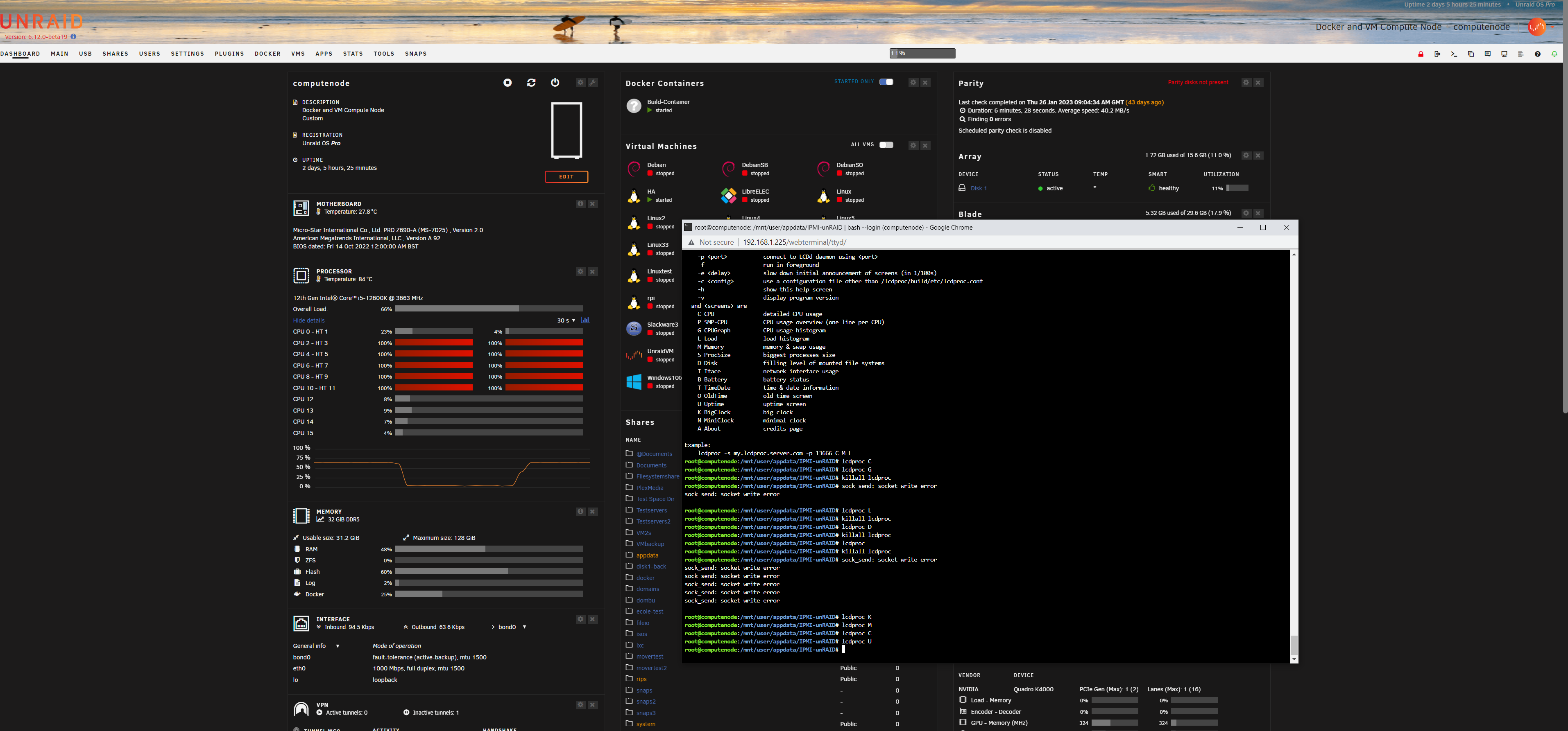

March 10, 20233 yr What are people looking for from lcdproc. I have it working on my unraid servers so will look to create a plugin, may be basic to start with. root@computenode:/mnt/user/appdata/IPMI-unRAID# ps -ef |grep -u lcd grep: warning: --unix-byte-offsets (-u) is obsolete nobody 7662 1 2 15:55 ? 00:01:05 LCDd -c /mnt/user/appdata/lcdproc/etc/LCDd.conf root 13476 24230 0 16:49 pts/3 00:00:00 grep -u lcd root 15217 1 0 16:20 ? 00:00:00 lcdproc K root 15699 1 0 16:20 ? 00:00:00 lcdproc M root 16557 1 0 16:20 ? 00:00:00 lcdproc C root 25209 1 0 16:22 ? 00:00:00 lcdproc U Edited March 10, 20233 yr by SimonF
March 16, 20233 yr 19 minutes ago, Paul_Ber said: I gave up a long time ago I have the command compile and working on the host. Will start creating a Plugin, but I only have CrystalFonz Display to test with.
