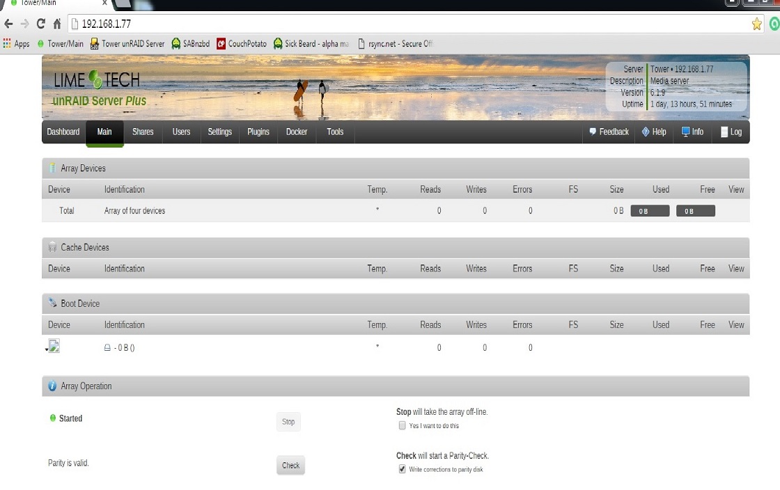

Hi Guys.  I have developed an issue with my unraid server.  The system works fine for about 1 day after a reboot, and then strange things begin to happen.  The first thing i notice is that the main webpage looses some information such as drive size and details.  Please find attached screen dump.  A few hours after this i then start to have issues with accessing the docker which runs Sab, couchpotato and Sonarr.  A few hours after that i cannot access anything on my server at all and i need to go to the server and type powerdown and then reboot it.  There is a message on the console about their not being enough memory or space?  I can note exactly what that says if it will help.

And the screen dump from the GUI when faulty.
First thing would be to uninstall Checksum, then see what happens
Bingo! I removed the plugin and the gui started working again even without a reboot. I will leave it a few days and report back what happens. Thanks des.
