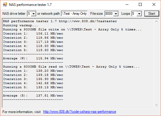

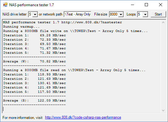

Turbo Write (or in 6.2.0 beta 18+ language: "reconstruct write") helps a lot.
See my 2 attachments:
Turbo Write gives 60% improve in speed (caveat: I'm testing unRAID in VMWare Workstation so the disks are all virtual but each disk is located on a separate 7200rpm physical HDD so performance should be representative of real life).
Cache drive, in my opinion, would only work on an established array (i.e. most data is already there, so daily activity is just the "delta"). When you just started, it's likely you will need a massive amount of overnight copying. So 60% diff for me is a 5-hour difference.
And it's not like the cache will stop the slowness. It just delay the slowness into the night.
