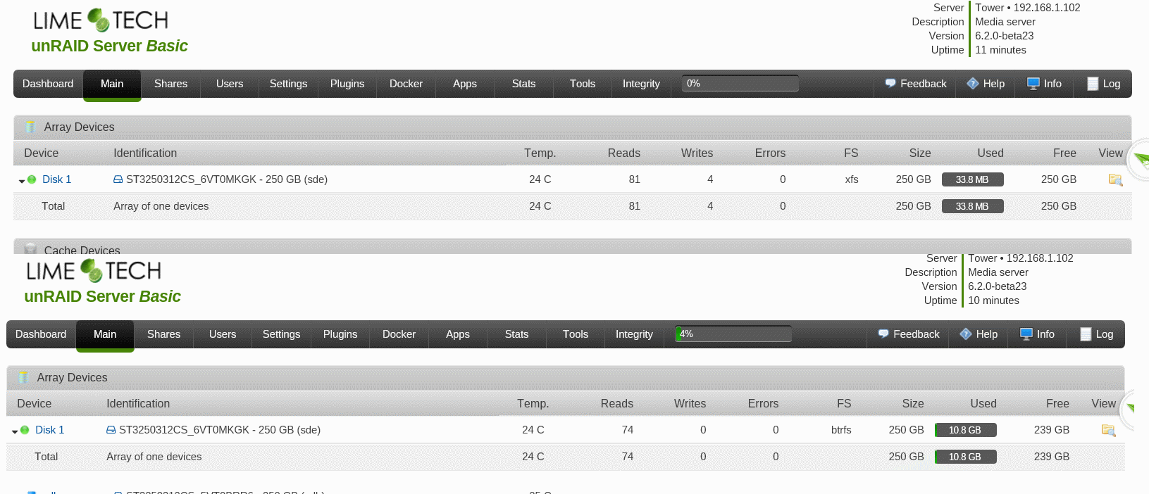

This happened to me when using a disk that was formatted with xfs was then formatted with btrfs, somehow that disk mounts with fs set to btrfs or xfs, with auto it's unmountable because unRAID detects more than one filesystem.

Wow!  Yikes!
Clearly one or both are not clearing out the initial sectors on format, their signature locations do not coincide, their 'superblock' locations do not coincide, and one or both are not validating very far AT ALL!  Did you try an initial root folder access?
Wow!  Yikes!
No, I formatted to Reiserfs and than back to BTRFS and this time worked as expected.
Perhaps Tom should add a line to zero out the first megabyte, before formatting to XFS or BTRFS.
That's a good idea, looks like this can also be an issue to users coming from ZFS, the quick XFS format dosesn't clear the ZFS info and disks fail to mount in "auto".
