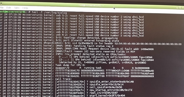

Intel Corporation 82801JI (ICH10 Family) HD Audio Controller DMAR Problem
Model: unRaid 6.2 Beta
M/B: ASUSTeK Computer INC. - Z8PE-D12X)
CPU: Intel® Xeon® CPU X5690 @ 3.47GHz
GPU:  ASUS GTX-680
HVM: Enabled
IOMMU: Enabled
Cache: 384 kB, 1536 kB, 12288 kB
Memory: 32768 MB (max. installable capacity 96 GB)
Network: bond0: fault-tolerance (active-backup), mtu 1500
eth0: 100Mb/s, Full Duplex, mtu 1500
eth1: not connected
Kernel: Linux 4.4.6-unRAID x86_64
OpenSSL: 1.0.2g
Sound:  Intel Corporation 82801JI (ICH10 Family) HD Audio Controller
Dockers: None
VM: 1 (Windows 10 Pro)
When I pass through the sound card at random times it causes everything to lock up.  As long as the sound card is not mapped, no issues.

Any suggestions?
Thank in advance

So should I be able to pass the system sound card or is this not going to work.

I am also trying a PCI-X sound card which is not working apparently because the PCI Bridge is in the same group.  This just sucks!
http://lime-technology.com/forum/index.php?topic=45450.0
04:00.0 PCI bridge [0604]: NEC Corporation uPD720400 PCI Express - PCI/PCI-X Bridge [1033:0125] (rev 06)
04:00.1 PCI bridge [0604]: NEC Corporation uPD720400 PCI Express - PCI/PCI-X Bridge [1033:0125] (rev 06)
06:01.0 Multimedia audio controller [0401]: C-Media Electronics Inc CMI8788 [Oxygen HD Audio] [13f6:8788]
  • 4 weeks later...
I resolved this issue but giving up using the motherboard sound card and using a ASUS USB based sound card that is plugged into a USB3 pci express card that is mapped to the virtual machine.
