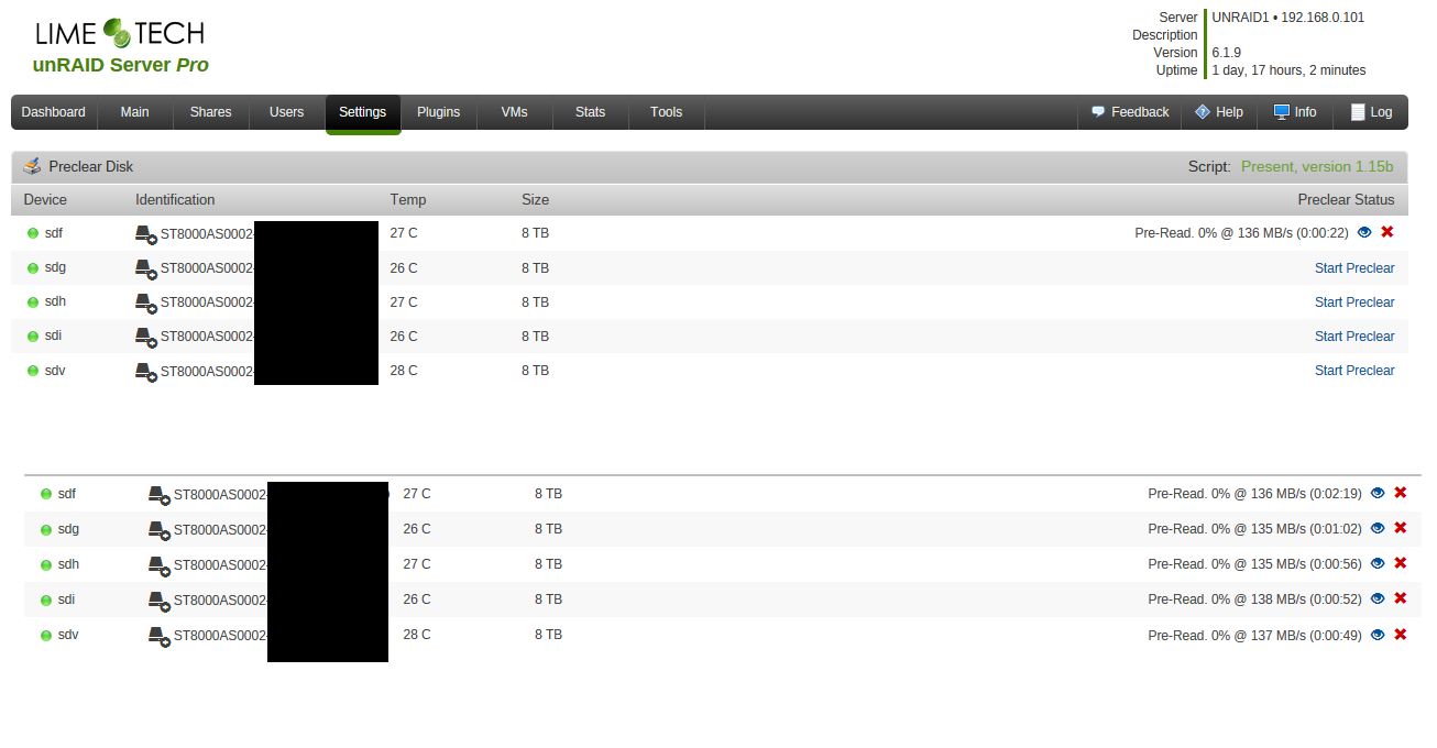

Brand new drives, no data. They are connected to a SAS2LP controller and Norco 4224 hotswap bays. Correct me if i'm wrong but I should be seeing about 200MB/s initially based on other results i've seen. What do you guys think?
EDIT: If I click the eye, it shows a more reasonable 150-170MB/s for each drive, not sure why the WebUI claims slower.
Update: They are still going 150-160MB/s at 27% (4 1/2 hours at this point), barely any speed loss. I guess I was expecting their speeds to reduce much quicker than they are. Seeing most people in the Seagate thread getting ~20hr pre-reads so this seems about right.

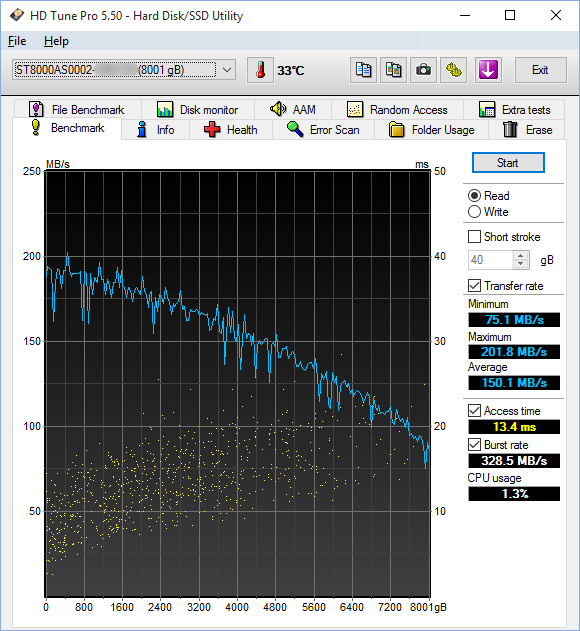

8TB Seagates performance curve looks like this:
You must have a really good sample.  :-\

It's the same speed whether I preclear 1 or 5, but it's not the 130-135MB/s the webUI is claiming. It's was ping ponging between 150-170MB/s when I went into the details, and right now at 35% it is ping ponging between 145-155MB/s.
Doesn't seem that far off from testdasi's results, so I think it's probably good enough.
My guess is this has something to do with you running 6 at a time! ;) It perfectly explains the lack of speed loss as the controller was the bottleneck up until this point.
The first screenshot was with only 1 going, the second was with all 5 going. I wanted to show the speed was the same regardless of how many preclears I was doing. Sorry for the confusion!
