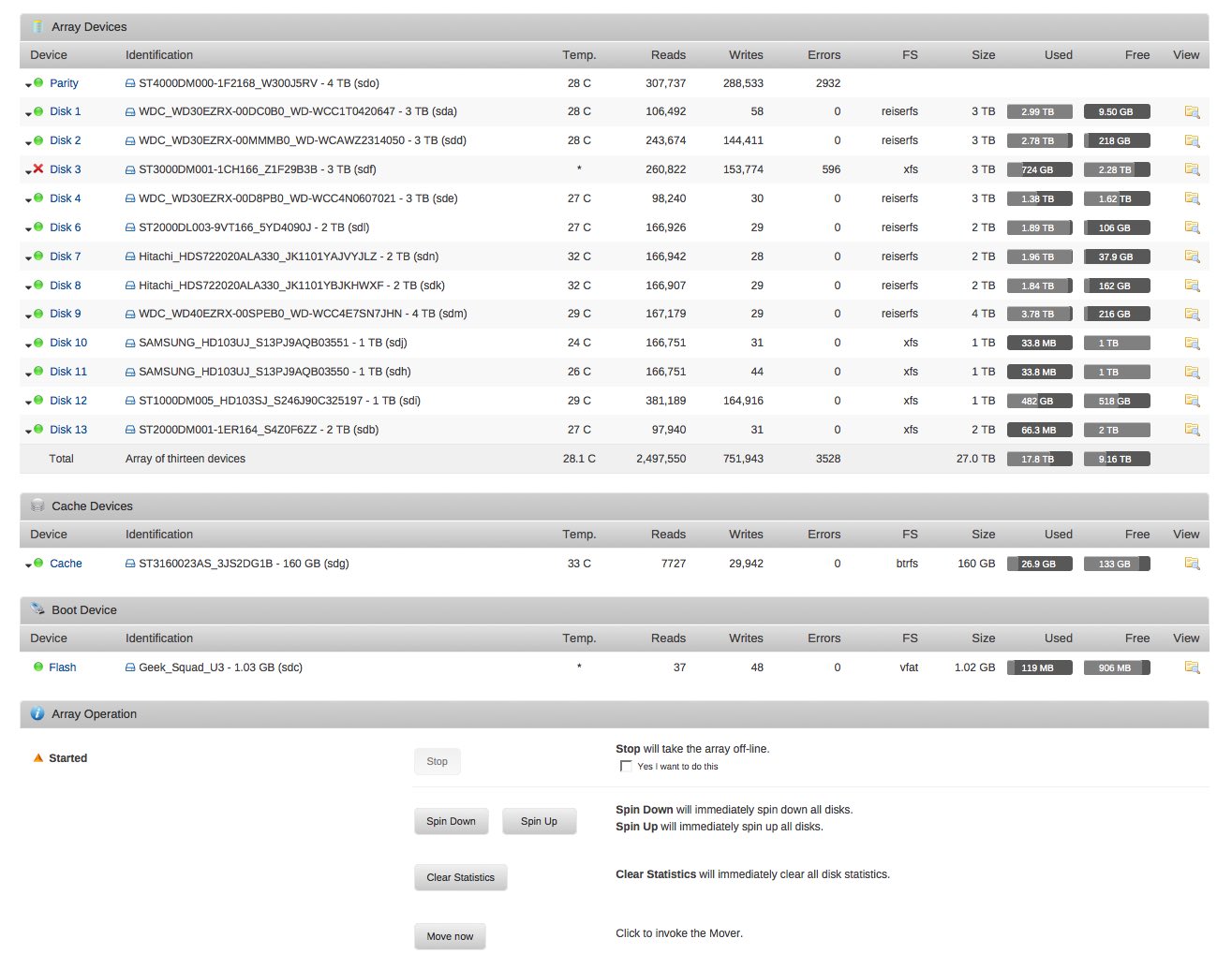

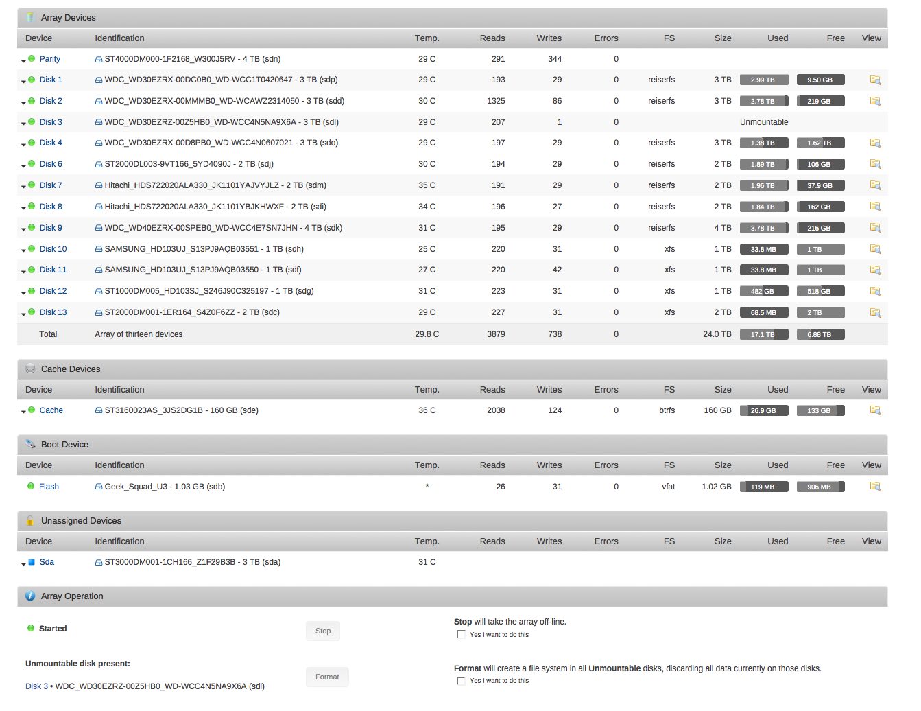

Drive rebuilt with no issues but it now shows as unmountable. see screenshot. any ideas?

yea i saw that. but why would raid rebuild the disk then want you to format it afterwards and wipe it out then have to rebuild it again?

original drive was xfs as well. see attached screenshot.
That's really strange. Definitely would not hit the format button, might be a corrupt filesystem or something. Hopefully someone who has seen this before has a solution.
One thing that strikes me is I see no "Parity is valid" or even a date of your last ran parity check. Were you doing monthly parity checks? Are you position your parity was valid? You have errors showing on both the parity drive and the failed disk in that second screenshot.
i was in the middle of doing a parity check when drive3  went offline and became unmountable.
You should post diagnostics, ideally from before the reboot, but at first sight it looks like a corrupt rebuild due to parity disk issues or from the parity being incorrectly updated if you were running a correcting parity check when the disk failed.

So the original disk was unmountable then? Rebuilding an unmountable disk will just result in an unmountable disk. You need to try to repair the filesystem. See wiki for Check Disk Filesystems.

Disk is mounted on the screenshot after it was disabled.
that was the screenshot previous to rebooting. after i rebooted the drive changed to unmountable.

You have to remove the "-n" flag and run it again, or it will only check and not repair.
