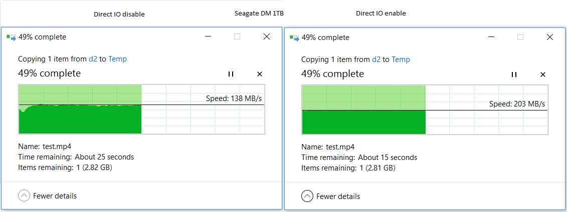

Make sure you enable direct_io (settings -> global share settings), makes a big difference for user shares read/write speed.
Wonderful, I just wanted to make sure I wasn't missing.  I will look into the direct_io when I leave work
