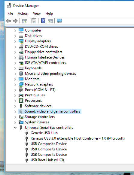

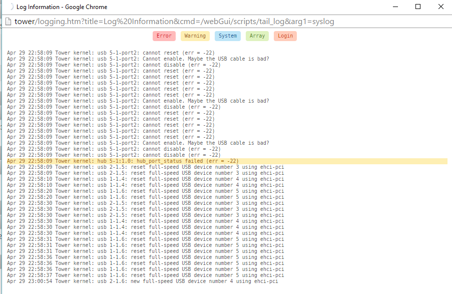

I am running unraid 6.2 beta 21 and current have the wireless xbox dongle passed through as a device (simply by checking the checkbox during vm creation). On a fresh boot of the host machine I can load up a game and use the xbox controller fine for a random period of time (sometimes couple of minutes to ten minutes) before the light on the receiver turns off and it is no longer recognised by Windows 10.
Other usb devices like my microphone, mouse and keyboard however don't exhibit this behaviour.
What I have tried:
- Restarting the vm. Doesn't appear to help, requires a full reboot of the host to get it back
- Changing the usb mode when starting the vm; 2.0 (EHCI) / 3.0 (XHCI)
- Tried different usb 2 and 3 ports on the machine
- Disabling / Re-enabling the xbox controller in device manager (says it requires a restart but and cosequently restarting doesn't help resolve the issue)
- Removing and re-inserting usb into same socket (hot-plug doesn't look like it works)

Can anybody help with the usb controller passthrough?  On a clean vm installation with vnc the controller shows up correctly for pass through and I was able to install a fresh copy of w10. Once I got into windows I shutdown the system and clicked edit to change vnc back to passing through the video card with associated hdmi audio. I then edited the xml to ensure the manually added usb controller passthrough was set correctly. From this point firing up the vm I just get a blank display. Everything i have tried has not allowed me to pas this usb controller through with gpu passthrough enabled.
My wireless xbox dongle is slot '0x1a'.

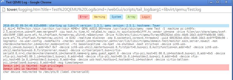

I have also tried creating a fresh vm and only ticking the logitec g5 mouse device as it is on another controller that is not passed through ( couldn't get it to work when it was plugged into the passed through controller). The mouse would freeze in unraid as soon as unraid loaded even know the vm wasn't even started.
I then manually edited the xml and adding the following to pass through the usb controller the other devices were connected too
      <driver name='vfio'/>
      <source>
        <address domain='0x0000' bus='0x00' slot='0x1a' function='0x0'/>
      </source>
    </hostdev>

Still getting a blank screen. I have attached he vm log.

I have stubbed  the controller as above and it does show up for passthrough when editing the vm. I removed  the manually entered entry and then re-saved the vm with the pci stub device to be passed through (still had gpu 2 selected at this point). Appears to lock up the system.Even though my mouse is not on that controller, the screen for the web gui appears to freeze and and I can't move the mouse by changing it into any usb connection. Additionally, the vm display never turns on from gpu 2.
So so far I have been able to:
- Enable acs_override
- Manually pass through the controller bus by editing the vm
- Pass through and start the vm on gpu 2:00:0
This worked flawlessly and I played an hour of the witcher 3 on my xbox controller last night :)
Since then I have stubbed the usb controller on boot and tried to start the vm on either gpu and nothing works. Is there anything else wrong with my devices or groups?
