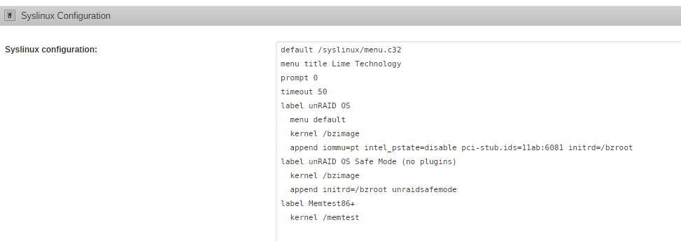

If you add a stub to Syslinux.cfg (click on the flash drive link).  My Syslinux.cfg looks like this:

Correct add the following to the syslinux.cfg file editable from the GUI when you click on the word "Flash" on the main tab in the unRAID GUI.
pci-stub.ids=8086:1010
So your syslinux.cfg might look like this if you only make this one modification:

What it should do is hide the network controllers from unRAID.  My assumption is that your 10GB nic is a Mellanox controller anyway.
Attached are some pictures.  Click on flash on the main tab in the unRAID GUI then scroll down until you see the syslinux config.
