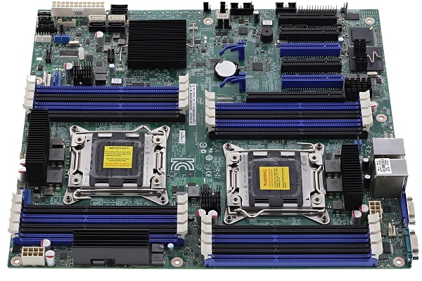

May 2, 201610 yr I was going to order one of the packages from here: http://www.natex.us/product-p/intel-s2600cp2j-128gb.htm and had planned to put two video cards into it thinking Gen 3 x8 will be fine. I'm a bit worried about the location and clearance however of other components on the motherboard in relation to the pcie slots - The two blue pcie slots with guides look to be possibly obstructed by cpu's 2 memory slots (It's hard to tell from the photo) - There is a blank heatsink on one of the motherboard chipsets. Will the pcie cards sit higher than this? Most non gpu's cards aren't that long so should *probably* be ok Most modern mid range and up video cards are dual slot due to their cooling. This would prevent me from slotting anything into the black pcie slots following the graphics card meaning I would lose 2 very valuable pcie slots. Considering server motherboards are light on features, I need these for sound cards and usb expansion cards (two things this board doesn't have). I know there are a few people on here that have ordered natex.us mobos. Can anybody speak to this? What video cards have you managed to put in, in what slots? Anybody running two video cards?

May 3, 201610 yr Author Just jumping on the thread to see how you get this going. I'll also be ordering a natex system in the future also. Which graphics cards are you going to grab up? I was thinking about going with 970 would prefer to get two but probably try to make it work with one. Addons I would like to add on to the natex board would be usb3 and/or usbc connection You might be able to skip the sound card and get audio via your graphics card over hdmi or displayport I currently have 2x 280x (https://www.asus.com/au/Graphics-Cards/R9280XDC2T3GD5/) but plan to replace one with a smaller more efficient mid range Polaris 10 card when they come out in a few months. But due to the double slot cooling it has just occurred to me I don't think you can get two video cards into this board. I don't have any monitors with speakers to plug in headphones. Just hdmi video. I had planned to run - Xonar DGX - https://www.pccasegear.com/products/21183/asus-xonar-dgx - VM1 - Video Card (VM1) - blocked - Video card (VM2) - blocked - 7 port usb 3.0 expansion (http://tinyurl.com/j3vnp4k) - VM1 - 7 port usb 3.0 expansion (http://tinyurl.com/j3vnp4k) - VM2 (no room)
May 3, 201610 yr Author This configuration may work but the question remains with the length of video cards and whether the first blue slot with guide is blocked by memory slots. Would love ot hear back from anyone that owns this board. - 7 port usb 3.0 expansion (http://tinyurl.com/j3vnp4k) - VM1 - Video Card (VM1) - blocked - Video card (VM2) - blocked - 7 port usb 3.0 expansion (http://tinyurl.com/j3vnp4k) - VM2 (no room) This HDMI to HDMI +Audio Extractor 2CH/5.1CH SPDIF 3.55mm looks like it will do what I want. http://www.ebay.com.au/itm/HDMI-to-HDMI-Audio-Extractor-2CH-5-1CH-SPDIF-3-55mm-Stereo-HDTV-Toslink-Coaxial-/201097268368?hash=item2ed254cc90:g:odwAAOxyyq5TNQ1x Update: My current thinking to potentially get around the problem with long video cards and the ram slot obstruction is to relocate the card onto another x8 lane using a pcie riser (http://www.ebay.com.au/itm/NEW-PCI-Express-Riser-Card-x8-to-x16-Left-Slot-Adapter-For-1U-Servers-/350958132910?hash=item51b6bc1eae:g:-ysAAOxyOlhSso9z). Have a different problem of not being able to screw it in quite as easily but it might be possible with a longer thread.

October 7, 20169 yr Hello I came here because i also bought a S2600CP board , and was trying to fit a x16 size gfx on the x16 slot on the board , and it does not fit because of memory right next to it , that started to make me worried so i found this thread later with closer inspection i discovered that the 2 x8 blue pci slots on the board can handle x16 size gfx because they are cut on the back they have some supports right next to them to accommodate x16 sizes , regarding the speeds i cannot comment i have not finished the build. so dont worry you can fit at least 2 x16 sized gfx cards , no problem (what a relief ) Cheers
October 8, 20169 yr Author Hello I came here because i also bought a S2600CP board , and was trying to fit a x16 size gfx on the x16 slot on the board , and it does not fit because of memory right next to it , that started to make me worried so i found this thread later with closer inspection i discovered that the 2 x8 blue pci slots on the board can handle x16 size gfx because they are cut on the back they have some supports right next to them to accommodate x16 sizes , regarding the speeds i cannot comment i have not finished the build. so dont worry you can fit at least 2 x16 sized gfx cards , no problem (what a relief ) Cheers You don't really need to worry about the speed of these blue open ended 8x slots. For gaming it makes almost zero difference to frame rates. The bandwidth is more important when you consider things like hard drives.
