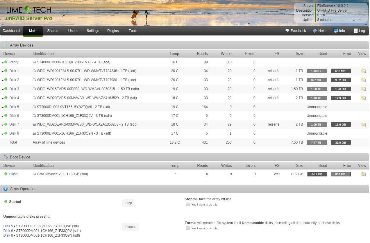

Sorry for the late reply. I have procured another 2TB drive and attempted the instructions you linked to, but ran into a problem.
The new drive shows as unmountable, as expected, but so do two of my other good drives. The 2TB assigned currently as Disk 5 is the one I am using to replace the failed drive, but I haven't had any problems with mounting the other 3TB drives in the past.
If I recall correctly one of the 3TBs was XFS, if that makes any difference. The slots they're assigned to don't matter as long as the correct parity disk is selected, correct?
fileserver-diagnostics-20160520-1714.zip
It tried to mount them as ReiserFS, which they apparently aren't,  so stop the array and change their file system to the correct one for each.
In the disk properties, one was set to RiserFS and one was set to XFS, as expected. I switched the RiserFS to XFS, and the XFS to RiserFS, and that did the trick. So somehow they were just mixed up.
I'm starting the rebuild to the 2TB now. Thanks a lot guys!
