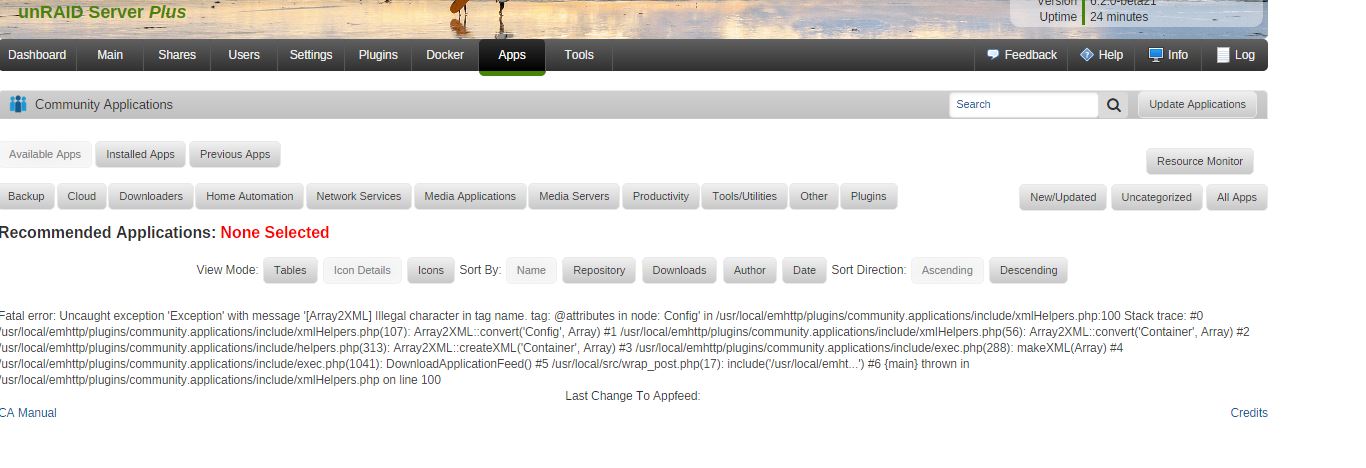

From a performance perspective, the only thing I've really noticed on the system is that if I (going by memory here since I have no GUI at the moment) go under applications, and try to use one of the default searches, it throws an error that lists about 5 lines of code. Which is obviously not all that helpful without my having the code to share.

...also, I've now got a screenshot of the weirdness with Apps.
Alrighty, updated CA and that took care of that. There was an update available for Powerdown so I got that updated as well.
