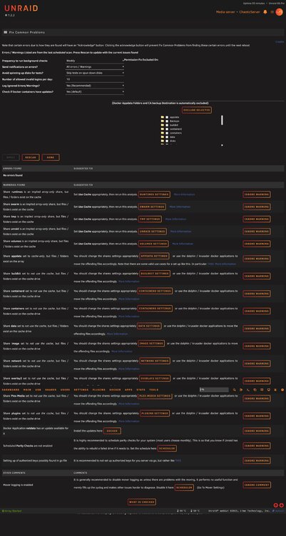

I've just got /var/log full error from FCP plugin. Attached here as per your instructions the exact error message and the diagnostics.
Hope you'll find a moment to help a full unRAID novice like myself.
TIA
Nick
ugreen-diagnostics-20251129-0816.zip

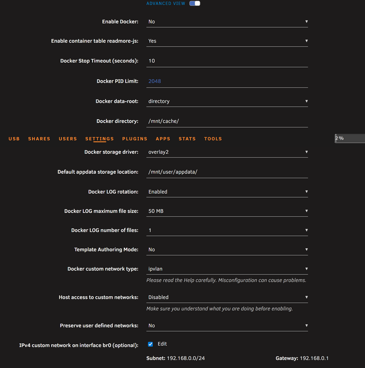

You have told docker to write directly to the root of your pool cache (/mnt/cache) without defining any share (like /mnt/cache/sharename)
You need to stop docker and remove all files and folders created by docker and change the path to the actual share you want.
Create a share named "docker". Set cache as primary, no secondary. Change Docker directory from /mnt/cache/ to /mnt/user/docker
These has to be removed.
Folders:
/mnt/cache/buildkit/
/mnt/cache/containerd/
/mnt/cache/containers/
/mnt/cache/image/
/mnt/cache/network/
/mnt/cache/overlay2/
/mnt/cache/plugins/
/mnt/cache/runtimes/
/mnt/cache/swarm/
/mnt/cache/tmp/
/mnt/cache/unraid/
/mnt/cache/volumes/
Files:
/mnt/cache/unraid-autostart
/mnt/cache/unraid-update-status.json
/mnt/cache/engine-id
Edited by Niklas
Edited path to cache pool
i will try changeing it to what you suggested and see how it goes. thank you!
Yes. You have it set to /mnt/cache and that's directly on your cache pool root, no share. You need at least /mnt/cache/sharename
Better to create a share named "docker" with cache as primary, no secondary and change the docker folder path from /mnt/cache to /mnt/user/docker (/mnt/cache/docker would also work, it will be the same share but could cause problem in the future if you want to move the docker share).
I edited my first answer, you need to clean up the docker files and folders, se my edited answer.
After deleting the folders (and the three files) you may need to delete the shares with the same names in the gui that Unraid created because it found all those folders not connected to any shares under /mnt/cache/*.
Btw, you will lose all your docker containers after this but you can easily add them back by using Apps - Previous Apps or click "ADD CONTAINER" on the Docker-tab and find your template in the list under "[ User templates ]", don't change anything and click APPLY. All settings remembered.
NEVER set any paths with no share. Like /mnt/cache or /mnt/user. There needs to be a corresponding share, like /mnt/cache/myshare or /mnt/user/myshare. Easiest way is to always use /mnt/user/myshare (name as you wish). Unraid will handle and keep track of where the data goes. Following your specific share settings ofc.
Edited by Niklas

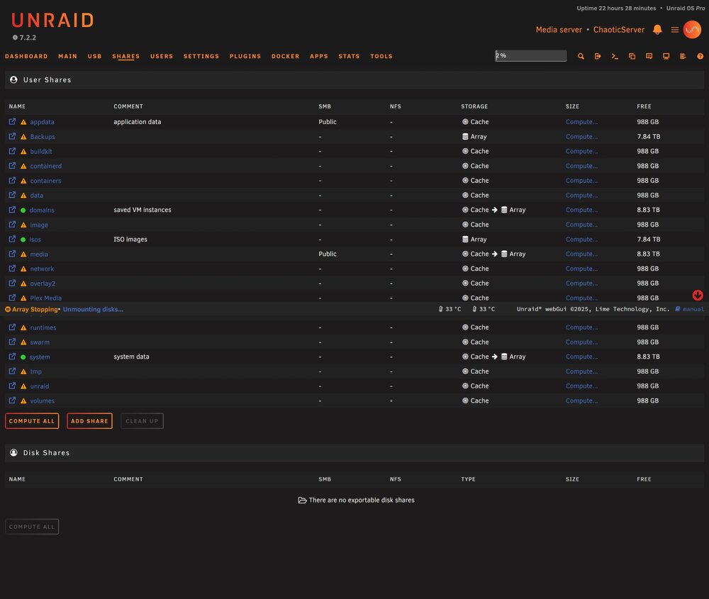

i don't even know what all those shares are from, i didn't manually create them.
I had a power spike and lost my 3 array drives and my cache drive.
I am starting fresh all new drives and no data.
I just got done resetting most things up, i guess it won't hurt to start again lol
Unraid will add every folder it finds in the root of your mounts as shares if you haven't set them up as shares. So docker has created all of them in /mnt/cache and Unraid finds them and adds them automatically with default share settings. Because you shouldn't have any stray folders (and no files) there without matching shares. :) That's good if you lost your usb-drive or config for the share. The folders will show up as shares for you to easily find them and set them back to your own settings.
Edited by Niklas

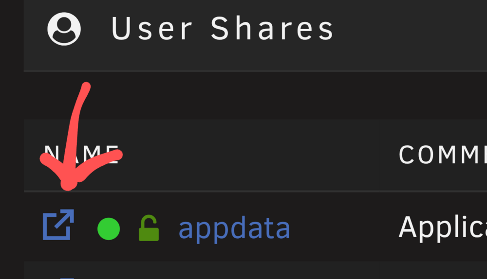

Yes. You can only delete empty shares (folders). You can use the built in file manager in the ui.
Edit
This strange icon will open it (I would like to see something like a file cabinet). Don't forget the files placed directly in /mnt/cache. It should only have folders, no files.
Edited by Niklas
Just now, trurl said:
I find that one strange too. 😆
