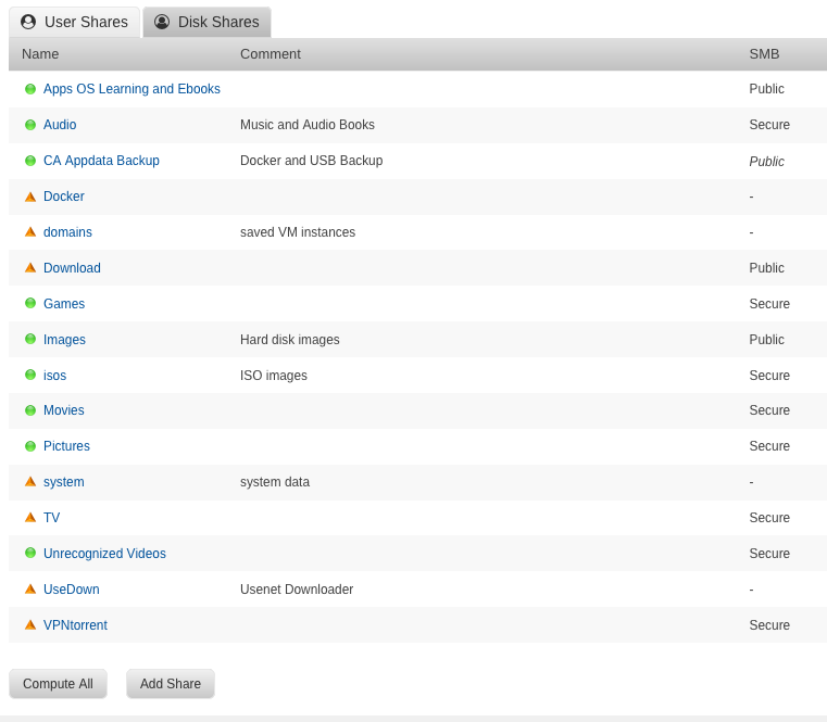

I'm receiving an error that my "Default docker appdata location is not a cache-only share" what's strange is I wasn't getting this error before.  I'm not using the appdata share, instead I'm using a share called Docker, that is set to cache-only, and is set as the "Default appdata storage location" within Docker advanced settings.  I've ignored the error for now, but find it odd that this wasn't an issue previously.
Edited by sureguy
ok.  I see the problem.  FCP has been assuming that the default location refers directly to a share, and not to a folder within a share.  In this case, it appears that you've also got an appdata share which is set as use cache "no", and since your subfolder off of the Docker share also happens to be the same name as a share it's getting looking at the share settings for appdata, and not Docker.
You must've just recently made some changes that triggered this, but I'll update FCP to account for it as there is nothing wrong with your docker settings.
I don't have an appdata share - I've attached a picture of my shares - unless the "CA Appdata Backup" share is confusing things
Edited by sureguy
Well, you did at some point (and recently or added the subfolder to the docker config recently)
/boot/config/shares/appdata.cfg exists and is set as use cache no.
Nevertheless, the issue is in FCP, and will probably get fixed tomorrow.  That test hasn't changed at all in probably over a year.
Ahh - I did fat finger something when setting up a docker, and then just removed the folder via ssh.  Sorry for the confusion.
Removing the appdata.cfg fixed the issue.
Thanks for the help and your work.
Edited by sureguy
