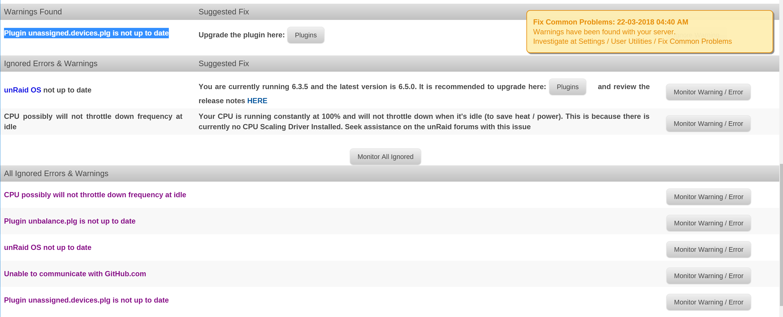

What's not ignoring?  Your diags show 3 problems, all ignored and then it appears you re-monitored the plugin not up to date
Mar 22 16:08:38 raid_01 root: Fix Common Problems: Warning: Plugin unassigned.devices.plg is not up to date ** Ignored
Mar 22 16:08:39 raid_01 root: Fix Common Problems: Warning: unRaid OS not up to date ** Ignored
Mar 22 16:09:06 raid_01 root: Fix Common Problems: Other Warning: CPU possibly will not throttle down frequency at idle ** Ignored
Mar 22 16:10:07 raid_01 root: Fix Common Problems Version 2018.03.21
Mar 22 16:10:10 raid_01 root: Fix Common Problems: Warning: Plugin unassigned.devices.plg is not up to date
Mar 22 16:10:11 raid_01 root: Fix Common Problems: Warning: unRaid OS not up to date ** Ignored
Mar 22 16:10:26 raid_01 root: Fix Common Problems: Other Warning: CPU possibly will not throttle down frequency at idle ** Ignored

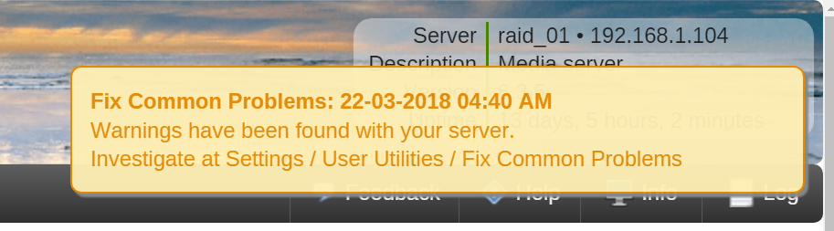

Not sure I understand your question exactly but will try and answer below.  Meanwhile, is there a simple way to get rid of the message with no dismiss mechanism?
Per the alert message I looked at what it was complaining about and it was the 'Plugin unassigned.devices.plg is not up to date' so I set that one to ignore since I'm running v3.5 and it can't be updated until I move to a later rev.
Then I updated the Fix Common Problems plugin and without reading carefully thought it might handle that condition so re-monitored the unassigned.devices.plg
For whatever reason the Fix Common Problems plugin page seems to show a warning for the the unassigned.devices.plg as well as showing it being ignored.  Note the alert that cannot be dismissed is blocking the 'Ignore warning' button in the screenshot.
It seems the fix common problems plugin is in a confused state at the moment on my system.
Edit the file /config/plugins/fix.common.problems/ignoreList.json on the flash drive (use an editor like Notepad++   Notepad will not work correctly here.
Add this line to the top, but after the opening brace
"Plugin unassigned.devices.plg is not up to date": "true",
Your final file should look something like this:
    "Docker Application Netdata has an update available for it": "true",
    "Community Applications not set to auto update": "true",
    "This plugin (Fix Common Problems) not set to auto update": "true"
This one is is out of my hands, and is purely a webUI thing.  TBH, I would recommend upgrading your system to 6.5.0, as support for 6.3.5 is basically finished.

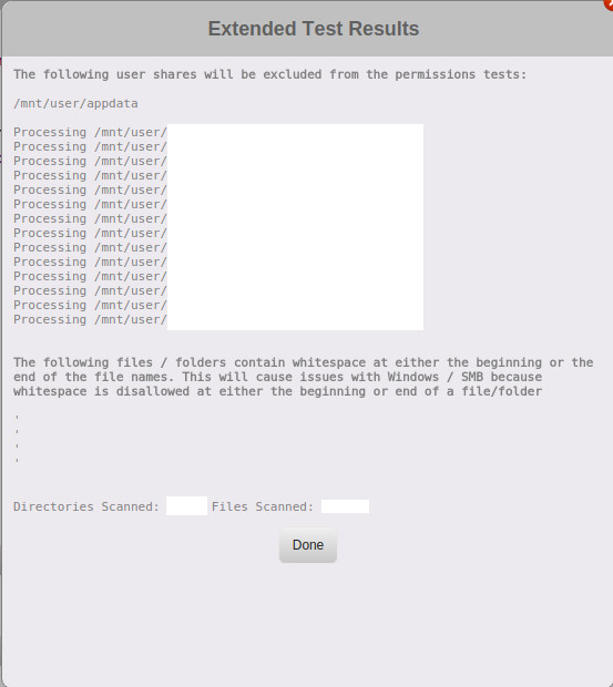

When I'm running the extended test I always get errors, but I can't find the files/directories with issues. See the picture below.
How can I find them?
Thanks,
Thomas

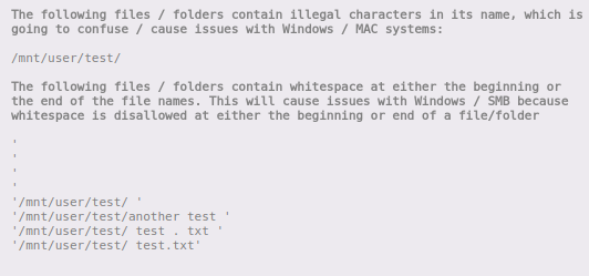

from the command prompt,
ls -ail /mnt/user/......
should show you something there...  if not, I'd need you to PM the output of that command
ls -ail /mnt/user/.... > /boot/squidTest.txt
I created some files with whitespaces and they are properly identified. See the results below.
5ab851410826e_Screenshotfrom2018-03-2521-42-27.png.cc52754c4b35673d03094976022a95d2.png
LE: I found the files with the problem. See below. Now there are no issues. Thanks
Edited by thomas
Found the issue

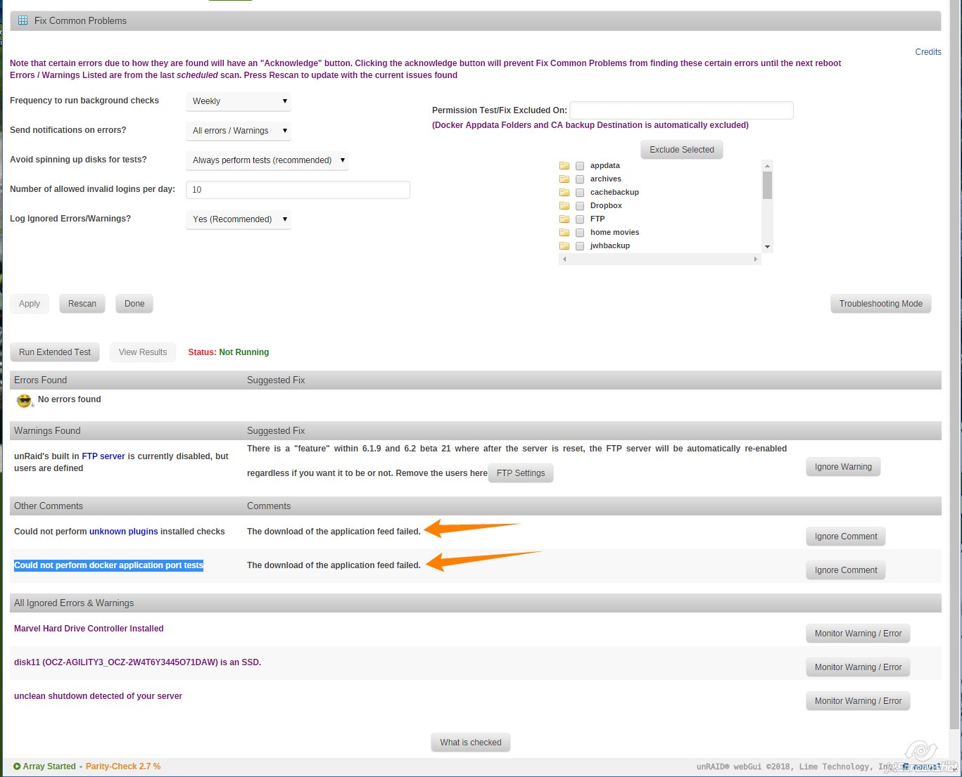

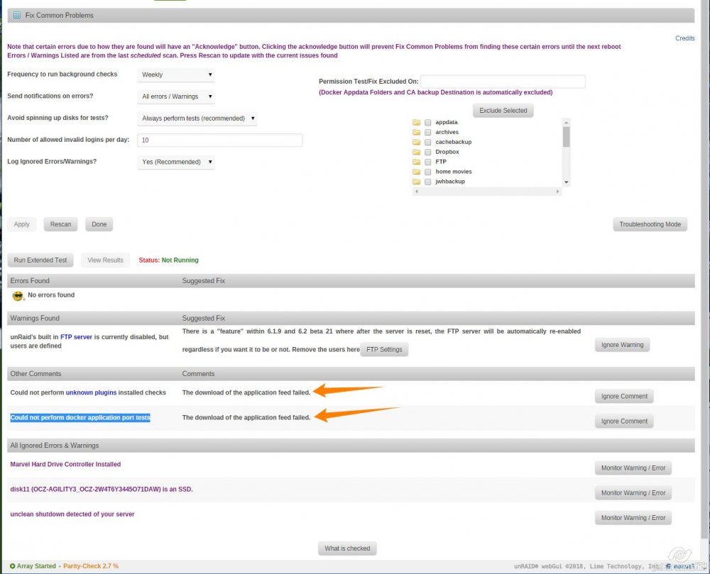

I'm getting a couple errors in fix common problems.  Not finding the errors in any forum.
Shows up in "Other Comments"
Could not perform unknown plugins installed checks	The download of the application feed failed.
Could not perform docker application port tests	The download of the application feed failed.
Thanks in advance!
Thanks in advance!
There are multiple threads where it's mentioned that the app feed for CA is down. You will have to wait until it's back up to clear the errors.
Our server with the app feed is down caused by the block storage of Digital Ocean being down.
Ah, I was searching on the actual error message, not the app feed.  Thanks for the insight.  I'll go into patience mode... ;)
