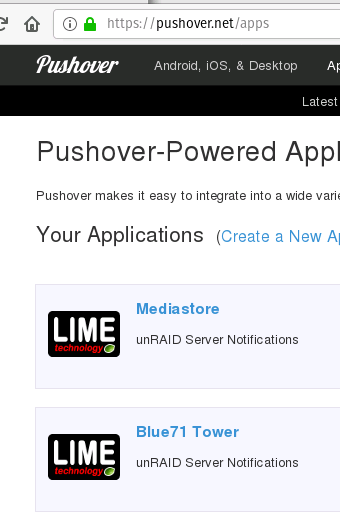

@Squid, is it possible to add the hostname of the server to the notifications that Fix Common Problem sends out? I'm using Pushover for unRAID notifications but me having 4 unRAID servers, I have to go to all servers to check which one produced the notification. See attached screenshot.
Is it possible for you to add the hostname to the notifications or maybe with a toggle to enable and disable it showing the hostname?
Thanks!
@Zandor300 This is not an FCP issue.
Go back to your Pushover API page and  make one application for each of your unRAID servers.
then edit the config on each unRAID server to use the the correct application token
kinda like mine is setup
