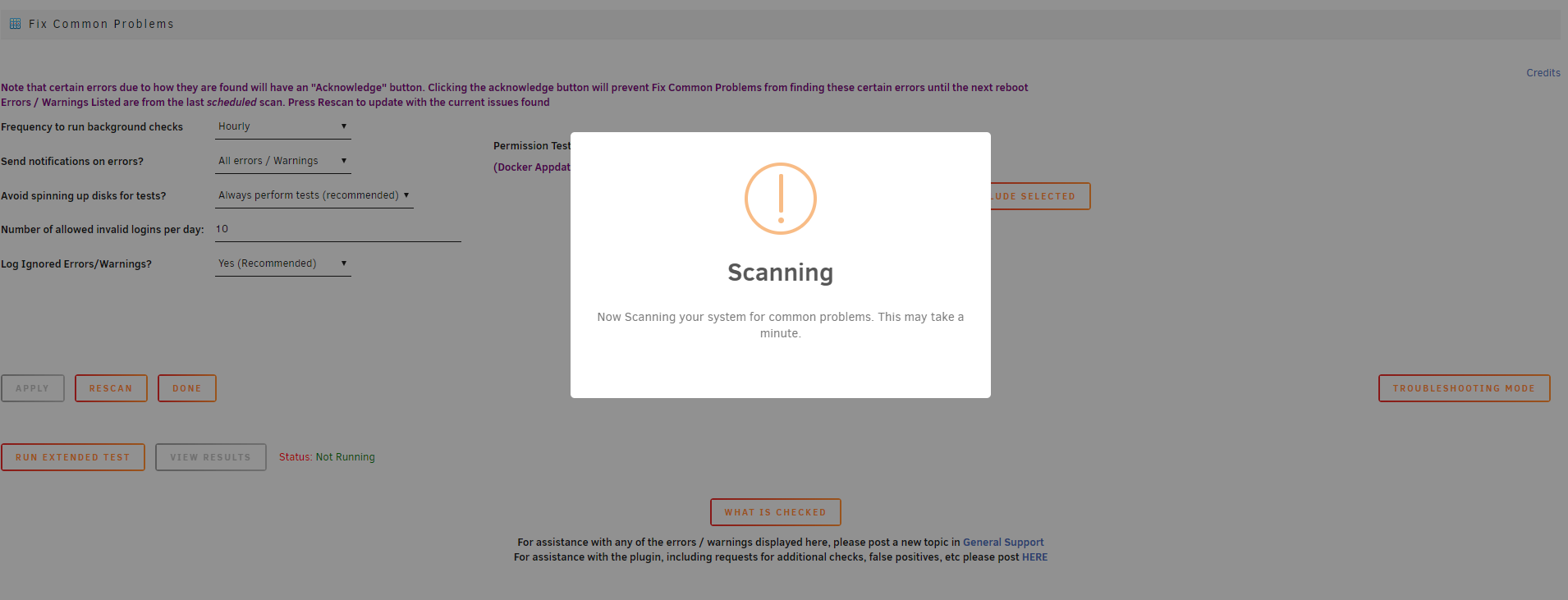

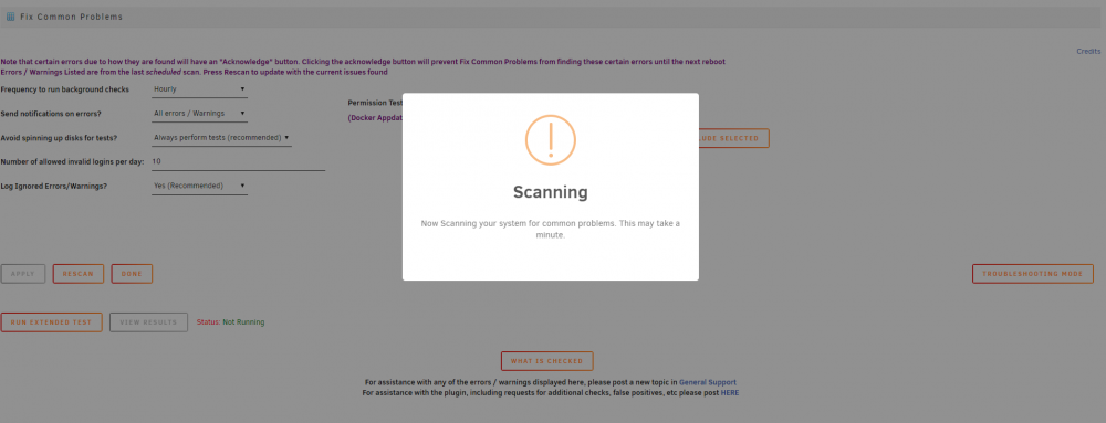

Hello there,
the plugin is hanging at scanning my system and I can't alter the properties. Does anyone have a clue?
Edited by pappaq
Due to the nature of unRaid 6.6, on any of the pop-ups that look like that one if the process does not complete in 120 seconds then it will never close automatically.  Close the browser window and then re-open it and the list will probably be populated
Didn't work, but with another browser I was able to disable the scan for spun down disks. That was all that I wanted. It can scan and notify me in the background now.
Thanks anyway.
1 minute ago, pappaq said:
another browser
What is the original browser?
Maybe I should give you a little bit more background information. The original browser is Chrome and the browser I could make the change with is Opera, but I was only able to change the setting due to the popup not initially showing up. After I changed it the popup appeared and it didn't disappeared like in chrome.
Maybe I uninstall the plugin until later releases.
While changing around how the popup works (to avoid the 120second thing) is on the todo list, it is definitely not a high priority.  It should complete within about 10 seconds tops, unless you've got tons and tons of drives and they are all spun down and the cumulative time to spin them up sequentially exceeds 120 seconds.
TLDR: Don't expect an update anytime soon
This is not the case. I don't know what is causing this behaviour and at the moment I am too lazy to get to the bottom of it. I will let the addon run like this for now. The option I wanted to set is now set and the rest works.
It's not that bad that it doesn't have a high priority. I can wait.
Many thanks for the quick answers and on a Sunday! Have a nice weekend!

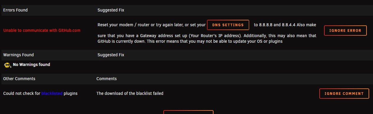

Overnight I began receiving this error about communicating with github and being unable to download the list of blacklisted plugins.
I am using the google DNS and I am able to browse github without issue from my browser.  I also tested pinging github and got a response fine, so I'm not sure whats going on.  I've attached diagnostics if its helpful.
tower-diagnostics-20181130-0721.zip
same issue here
Same issue here.
Also:
- Ping github works
- traceroute github works
- I was able to install a new random app from the community apps tab
Typo on my part when doing maintenance on CA.  All fixed up now.
