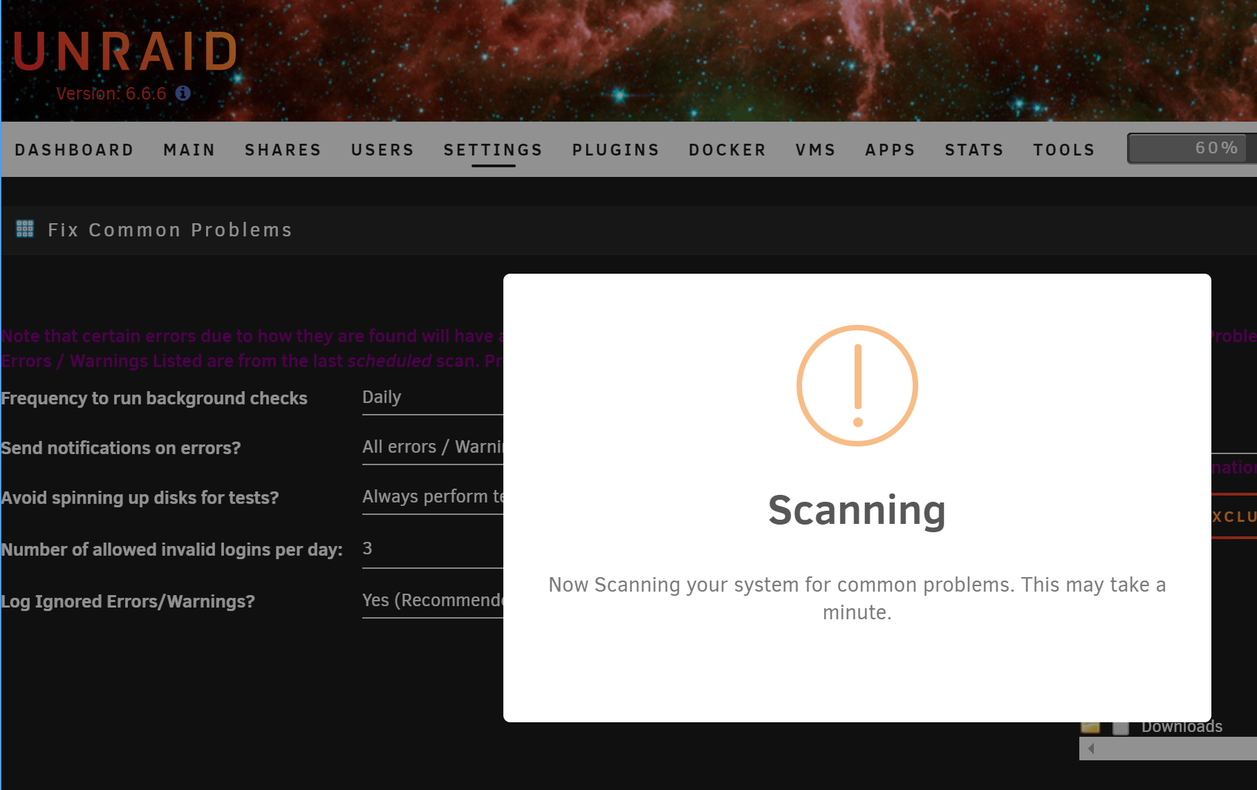

For the past week, this plugin has been hanging on my system. Sometimes, it eventually times out and no results are found. It appears that the daily background check isn't running either.
This behavior persists across reboots. I've also removed the plugin and reinstalled, same condition.
Edited by geekazoid

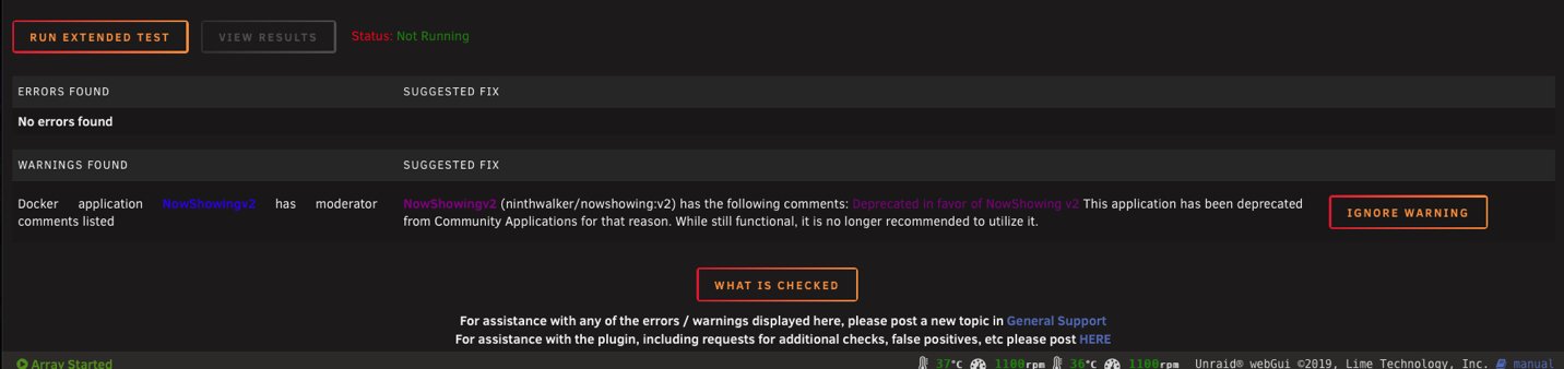

FCP is generating an erroneous report regarding Now Showing V2 docker-
Now Showing v1 was deprecated, not v2. Not sure if this is an error in a template by @ninthwalker or an error with FCP? This just started for me when I installed RC3 but I believe I saw a report in the docker's support thread about someone getting the same error in RC2.
brunnhilde-diagnostics-20190209-1844.zip
Ok  I see now that they are the same repo, just different tags   will rectify
FCP is still hanging after update. Squid?
 Get it to hang again then post your diagnostics
There isn't much in here about FCP. I've tailed every log I could find.
fluffy-diagnostics-20190217-1051.zip
ok  Saw what I wanted (and expected to see).
Do this
cp /tmp/fix.common.problems/errors.txt /boot/errors.txt
And upload here errors.txt and /config/plugins/fix.common.problems/settings.json from the flash drive
If there are no errors in the list, the script runs automatically when you access https://<unraid>/Settings/FixProblems. I watch for this process:
/usr/bin/php /usr/local/emhttp/plugins/fix.common.problems/scripts/scan.php 1
I moved some files from the cache recently which triggers an error in FCP. This actually helps me see what's going on.
In /tmp/fix.common.problems/:   errors.txt is generated 3mins after execution. The moderations and templates files timestamps are also updated.
Watching process:  scan.php closes in 4-5mins however the web page does not update, so the splash remains indefinitely. Refresh page after script is complete and its normal (not scanning again). This is new behavior today.
/tmp/fix.common.problems/errors.txt becomes errors.json after execution of the script. See below. Not very exciting.
Contents of errors.json:
    "errors": [
            "error": "<font color='red'><b>Default docker appdata</b> location is not a cache-only share</font>",
            "suggestion": "If the appdata share is not set to be cache-only, then the mover program will cause your docker applications to become inoperable when it runs (6.1.x). Under 6.2+, this setting should not affect the operation of the application, but it will definitely impact significantly the performance of the application.  Fix it via <input type='button' value='appdata Settings' onclick='window.location.href=&quot;/Shares/Share?name=appdata&quot;'>"
    "warnings": null,
    "other": null,
    "ignored": null
Contents of settings.json:
    "frequency": "daily",
    "notifications": "all",
    "disableSpinUp": "false",
    "hacksPerDay": "3",
    "logIgnored": "yes",
    "excludedPerms": ""
8 minutes ago, geekazoid said:
3mins
And that's the problem.  120 seconds is the maximum time unRaid allows for something to execute using the process I am.  Some year I'm going to change how this all works.
Changing FCP to avoid disk spinups will probably fix you up.
On 2/17/2019 at 3:41 AM, Squid said:
Probably fixed on today's update.  But, it's a corrupted XML file.  A new test will show which one.
Thank you. I confirm the release fixes the error for me.
Tried that, no change.
The problem seems to be the scan.php not running in a timely fashion (it used to run for less than a minute) and not refreshing the page by clearing the 'scanning' splash.
Other than that it seems to be working. But this behavior is an irritating change from the norm.
