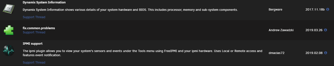

Hi, first post here.  Thanks for all you do, Squid, I've been successfully using your plugins thanks to the SpaceInvader vids since I got my server up and running about 6 months ago.
Just got the server back online (I'm running 6.6.7 stable) after having the USB drive die (without a backup, was able to copy the config folder, at least).  It seemed that some of the plugins may have become corrupted in the USB's death, I'm not sure.
I noticed my app tab was missing this morning when I went to add an app, and then saw these four plugins were missing due to errors:
I was able to get Community Applications installed and running again.  I went to re-add FCP, and it confirmed that it successfully installed, but it appears like this on the plugin page:
Clicking on it leads to a blank page under the settings header.  FCP does not appear on the settings page.
From my system log, the first four entries are all red, for errors.  I'm not very good at reading this sort of stuff, but I think it also shows where I tried to remove the FCP plugin around 9:03, and reinstall it around 9:04.

Without knowing the exact chain of events, the easiest solution is a simple reboot
Okay, rebooted, and the FCP plugin is showing up same as before with the file-type name instead of the display name.  Clicked remove, this was the feedback:

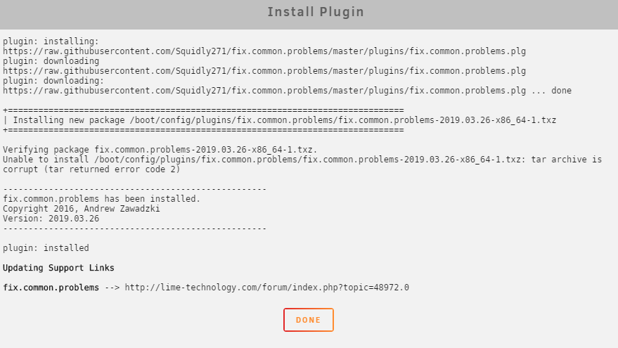

Reinstalling the plugin this time I noticed a line about the tar archive being corrupt:

Delete the .plg from config/plugins on the flash drive and the .txz from config/plugins/fix.common.problems reboot and reinstall
Sent via telekinesis
That seemed to be the trick, I now have it running the extended test.
Thanks again, for everything!
