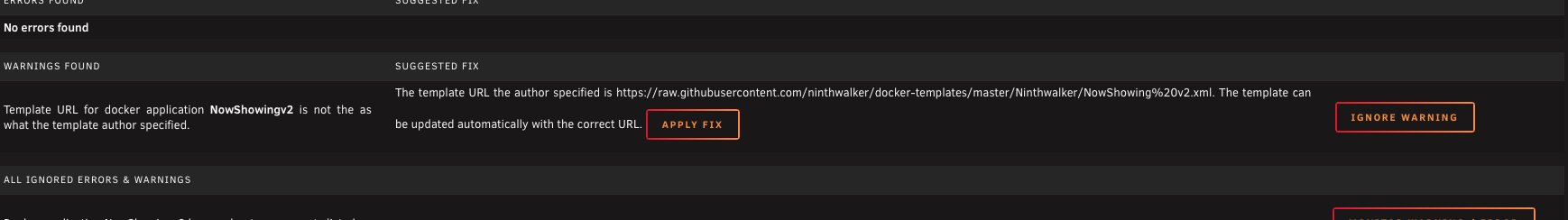

I am getting the warnings seen in attached screenshot.
Where does this plugin find the urls suggested? Sorry if I seem a bit paranoid, but I get red flags adding stuff from repos that doesn't seem associated with the main projects :P
Also, was this check recently added to the plugin, or did something suddenly go missing from my install?
Thanks

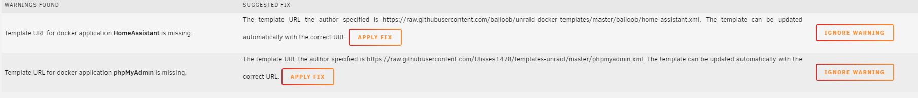

  • Implied Cache Only shares do not have files / folders stored outside the cache drive Cache Only shares do not have files / folders stored outside the cache drive Array Only shares do not
Just hit apply fix. The template guys weren't filling out the field properly so CA is now doing it automatically for them
Sent from my NSA monitored device
Okay, thanks for the reply.
