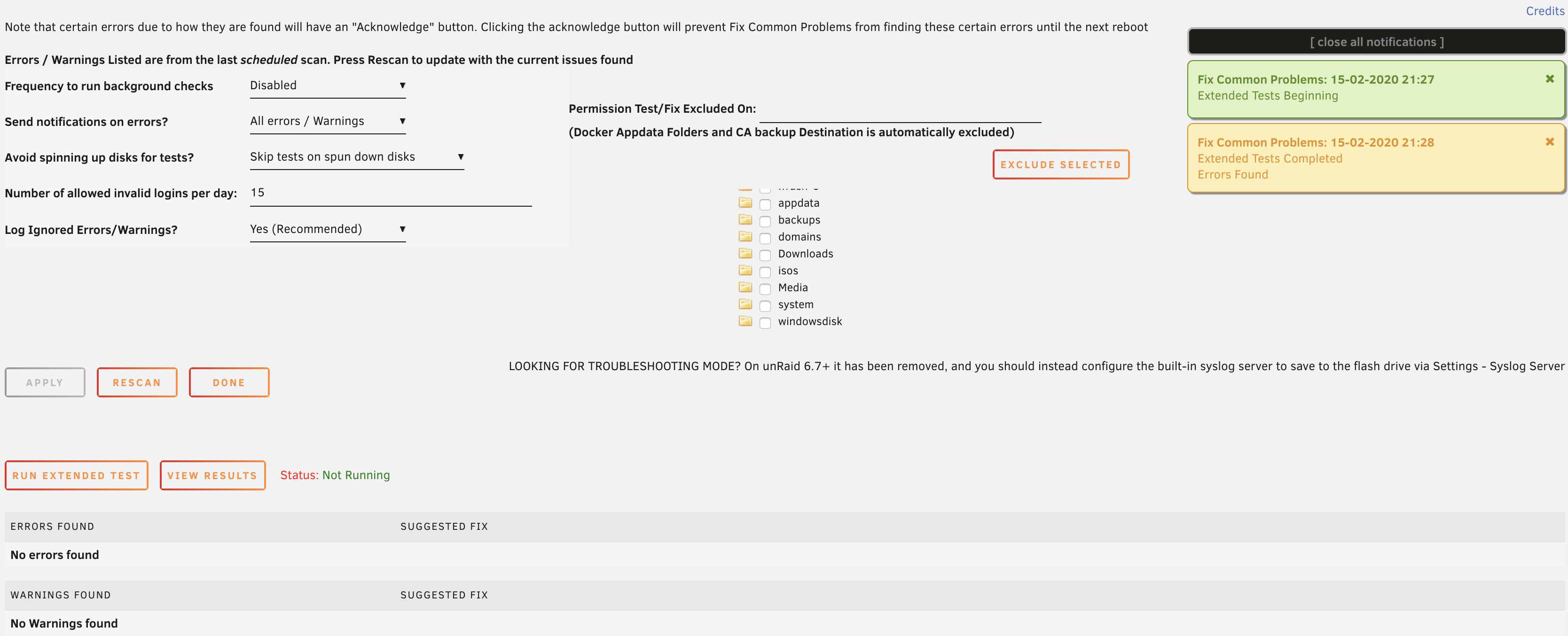

I ran an Extended Test on my server and after the test was completed it gave me a notification: Extended Tests Completed. Errors Found.
But the Errors tab doesn't show any errors, neither does my syslog. How should I diagnose the problem?

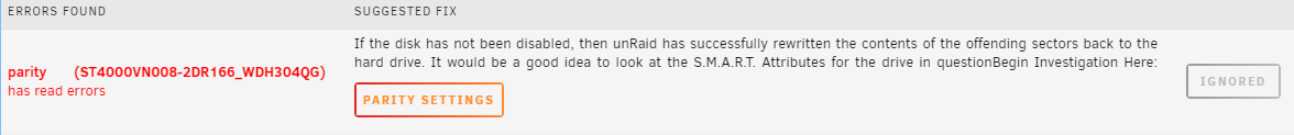

Hello all,
I had a smart reported issue on a drive, that has been nicely reported, but now, I'd like to acknowledge it instead of ignoring it so if the error triggers again it will show:
Any tips please?
Thank you
3 hours ago, Reynald said:
Hello all,
Any tips please?
Thank you
That is just showing there were read errors and suggested checking the SMART. Did you? If so what was the exact SMART issue reported? Some are more serious than others and would be better dealt with by replacing the disk. So no recommendation without more information.
@trurl I checked 2 Reported uncorrect on parity disks while disk rack was hot after a parity check after reboot.
No pending sector or reallocated. I ran parity check and it hasn't reproduced.
Now I'd like to ack/reset the error in FCP without ignoring it. Is it possible?

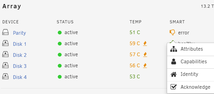

Click on the SMART warning on the Dashboard.
Ohhh...
Perfect, thanks !

Anyway, Fix Common Problems still report the read errors even after the above acknowledgement...
Read errors reset when you reboot.
Or if you hit Clear Statistics on the Main tab
Clear Statistics did the trick.
Thank you @Squid and @trurl
