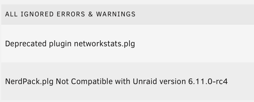

How do I actually get rid of these? They're not on my plugins list.
I would expect them to be listed on your Plugins tab. If not, please upload your diagnostics.zip (from Tools -> Diagnostics)
Note that is really not advised to run rc releases so long. You should upgrade to 6.11.5 or 6.12.3

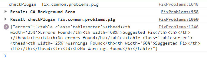

The plugin does not scan, it stays on this screen indefinitely. Any solution ?
Unraid 6.12.3
 Works for me no problem.
I'd suggest closing all browser tabs open to the server.  But, after a couple of minutes even sitting on that Scanning popup, the scan would still continue in the background and the next time you load up FCP it should be populated.

I got this too. You get the "Now Scanning your system for common problems." popup, but it never goes away. Reloading later doesn't show any completed results either.  Multiple computers, both with and without Incognito. Previous version worked fine.
Edited by OverlordQ
RM'd the
/tmp/fix.common.problems/scanRunning
file dated 4 days ago and then the pageload started working again.
