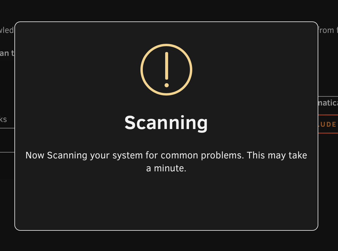

On 8/19/2023 at 2:38 AM, HHUBS said:
Yesterday, it was working then today it just stuck on this. Anyone having the same experience? image.png.dd24b79f0eb2d2a5f26163dd2c3c394e.png
Same here. This started a few days ago for me. It's not local cache as I get the same issue while in Incognito mode. I did upgrade from 6.12.3 to 6.12.4 three days ago, but I feel like this plugin worked after the upgrade. But I could be mistaken. And unlike @yogy, I'm still getting it. Nothing is appearing within my logs either.
EDIT: Does not appear to be related to the 6.12.4 upgrade. I just upgraded my secondary unraid and it is still scanning, plus it's adding the line Fix Common Things to the log.
Sep 14 10:55:44 unRAID root: Fix Common Problems Version 2023.07.29
EDITED EDIT: A reboot appears to have resolved the issue. Time will tell now. As mentioned before, I don't recall seeing the issue immediately after the upgrade and running this plugin is something I do right after an upgrade. But there could be a number of factors involved. I'm also trying to move VM's off my cache pool to reformat it and was getting errors with that. Or the move was showing a state of completion at over 120%.

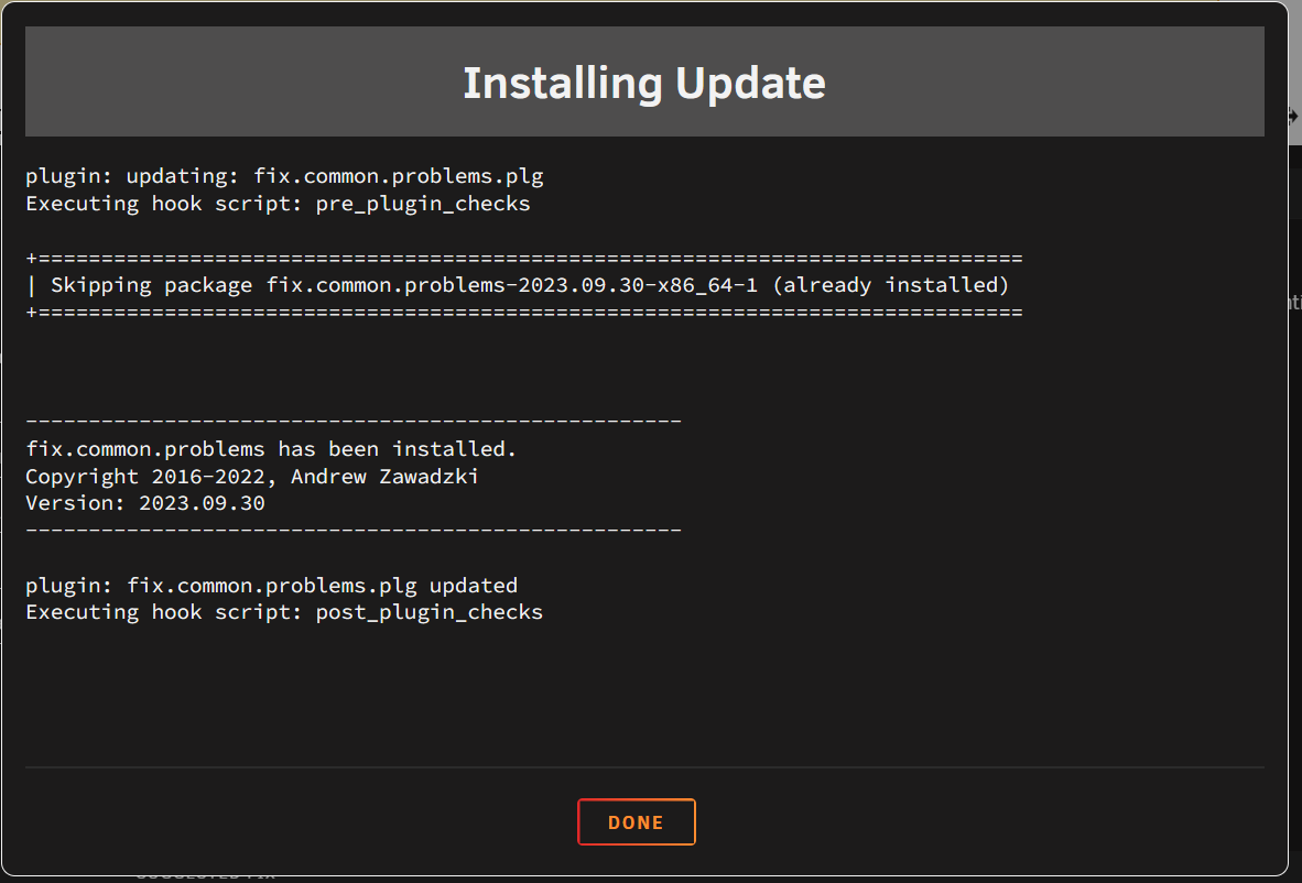

says update is available when going to settings > fix common problems but when trying to update it is not updating to this new version and just says it's up to date 2023.09.30 is already installedimage.thumb.png.f0fad1ac9a5aadf19c4c35b580f8ec5d.pngimage.thumb.png.ca7070e7e8c2f87ad5cb9fc513f833f9.png
I'm trying to figure WTF happened since everything looks ok

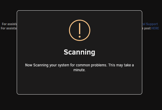

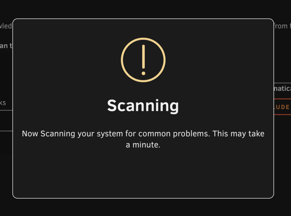

Similar to @HHUBS and @UncleStu, FCP has been working fine on both my servers. After this last update, when I go to the FCP page, the "Scanning" pop-up displays and just stays there.
But, on my third server, after the newest update, it still works fine.
As above seems to die doing the scan since latest update.
I can't replicate this.  If you let it sit for a couple of minutes does it begin?   If after a couple of minutes if you reload the page does it try to start up a new scan or does it have items already populated?
I let it sit for 30 minutes or so on two different systems. If I refreshed the page and tried again it did the same thing.
All that being said, it now works absolutely fine on both. Go figure!
