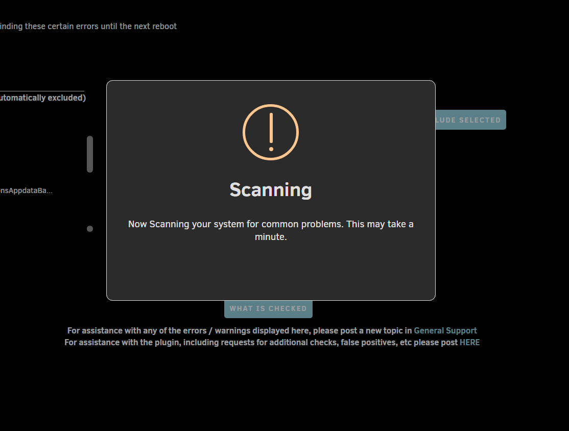

I am having the same issue after upgrading. Letting it sit for a couple of minutes and then reloading the page just shows the same message. After several hours the scan has not completed.
I will not be upgrading to 6.13 immediately after release. I can provide diagnostics or logs if they will help make this plugin work again on 6.12.6.

On 12/24/2023 at 8:52 AM, smileybri said:
This happened to me also since the update. Let me know if more logs or diagnostics would help.
Same issue here.
Resolved for me with these steps:
1 - Uninstall plugin
2 - Delete temp file (rm -rf /tmp/fix.common.problems)
3 - Reinstall plugin
4 - Scan
Edited by wndq8h21

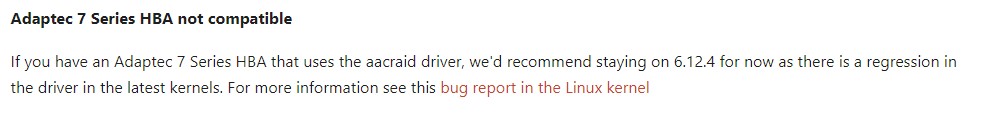

Hi there.
Is it possible to add a HBA Adaptec check into Update Assistant ? I upgraded to 6.12.6 without knowing it had problem.
https://docs.unraid.net/unraid-os/release-notes/6.12.6/#known-issues
Would have been nice to know beforehand. Just wondering if it's a possible thing to lookout if there's an Adaptec HBA installed in the server and warn the owner.
Thank you for your time
