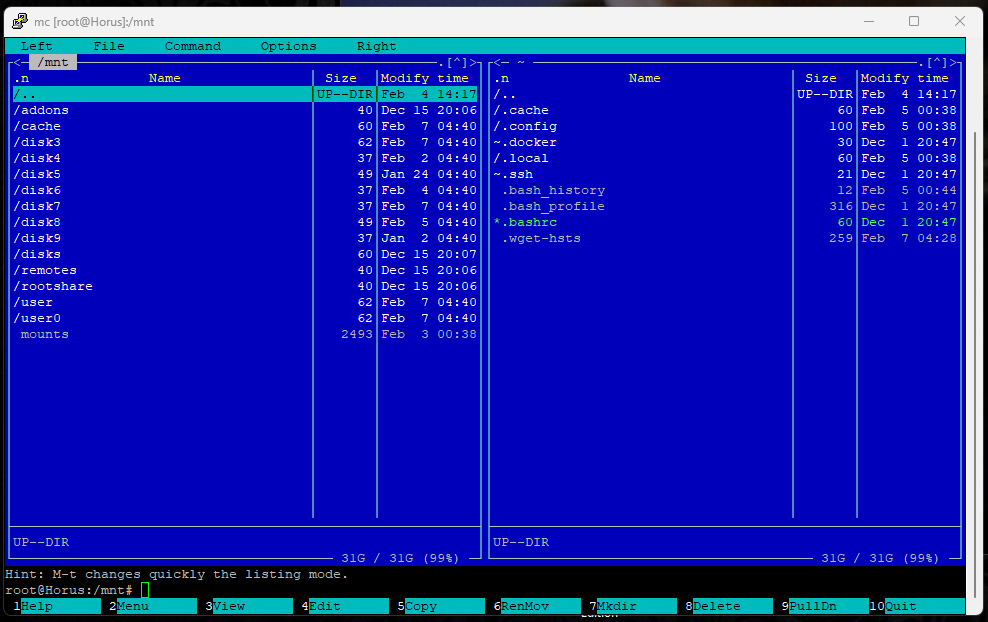

5 hours ago, itimpi said:
That message means that there is something under /mnt that should not be there.
Running the command:
ls -l /mnt
should give a clue as to what is (and therefore what might have done it).
Hi itimpi,
thanks for this info
I checked it and found... nothing (?)
There are some folders:
.) addons... empty
.) remotes... empty
.) rootshare... empty
These folders are new but dont ask where they come from 🤣
Can i delete this empty folders or do they have some functions?

1 hour ago, Zonediver said:
Hi itimpi,
.) addons... empty
.) remotes... empty
Those are all expected - they are used by the Unassigned Devices plugin.
Ok... so whats next? Is it a false positive? Maybe...
I will ignore it 🤣

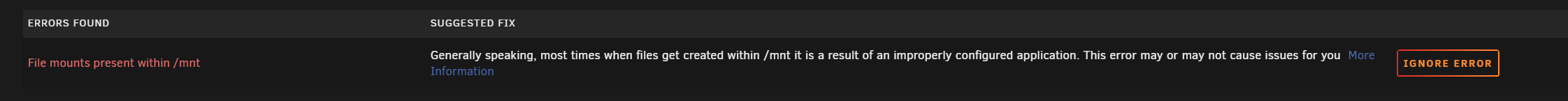

Receiving the following error:
Fix Common Problems - homegrown: 03-02-2024 04:40 AM
Errors have been found with your server (homegrown).
Investigate at Settings / User Utilities / Fix Common Problems
FCP states:
File mounts present within /mnt

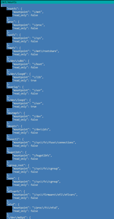

Can't figure out what is causing this issue. It may be related to how I have Google Drive mounted with SMB? There is a "mounts" file in /mnt, but I'm not sure if that's expected to be there. Or maybe related to /mounts folder? Other possibility is perhaps I need to exclude /mnt from Recyle Bin plugin? Not sure.
Diagnostics attached. Any help is appreciated. Thanks in advance
homegrown-diagnostics-20240205-1957.zip
Edited by ramair02

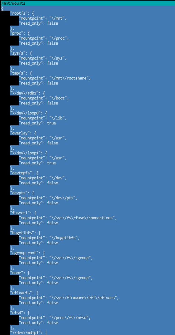

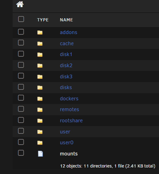

You have the file ‘mounts’ which should not be there.   You must have something creating it.   It is also not normal for the RecycleBin folder to be there - but that may be an artifact of whatever is causing the ‘mounts’ file to appear.
There should be nothing manually mounted directly under /mnt.   if you are manually mounting anything then it should be under /mnt/addons.   If you use Unassigned Devices plugin to mount anything it will appear under /mnt/disks or /mnt/remotes as appropriate.
This makes sense. How can I figure out what is creating the 'mounts' file? It contains a bunch of mountpoint information about all of my disks. Here's a snippet of the file contents. Entire file attached.
image.thumb.png.30b73f820024f6cd39ac8a202d3e397a.pngmounts.txt
Edited by ramair02

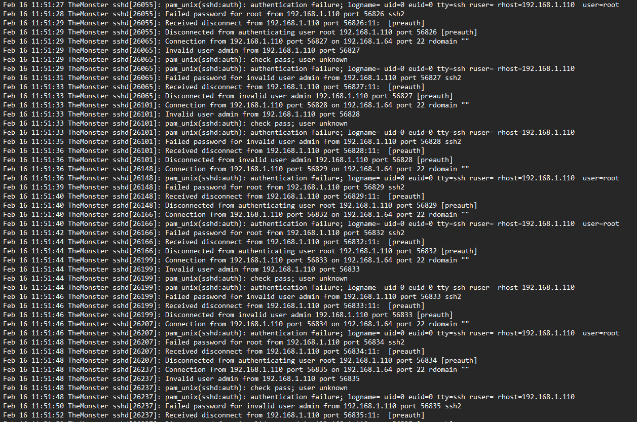

Possible Hack Attempt - "On Feb 16 there were 69 invalid login attempts. This could either be yourself attempting to login to your server (SSH / Telnet) with the wrong user or password, or you could be actively be the victim of hack attacks. A common cause of this would be placing your server within your routers DMZ, or improperly forwarding ports."
I've gone through my port forwarding in my router and disabled everything except Plex and Jellyfin several weeks ago and this is become a daily occurrence. I've validated the IP address to my Unraid server is unable to be accessed outside of my network. I do use OpenVPN to remote in to my network outside of the home.
themonster-diagnostics-20240216-1624.zip

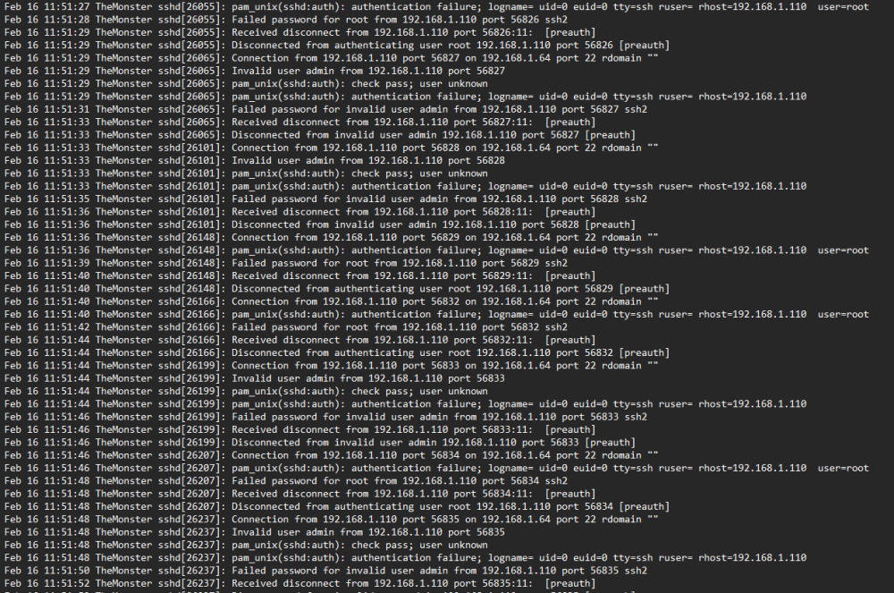

I just looked up the syslog and it appears my main home PC is causing the "hack attempt" warnings.
Not 100% sure why it's doing this though. I mapped one of the raid shares to this PC so I can access movies and what not if need be. How do I fix this?
Probably your antivirus software is attempting to hack any device it finds on the network to alert you to any open services. Personally I find this practice disturbing, but it seems to be a thing with certain antivirus programs and even routers.
You know! You're absolutely right! My AVG antivirus is probably doing this. This is absolutely annoying!
