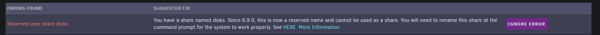

On 6/6/2024 at 6:30 PM, Nibbles said:
I'm seeing this Reserved user share disks error, but I don't have anything named 'disk/s' at all? I do have one for Windows Disk, but I don't think that's an issue?
nibsbox-diagnostics-20240606-1827.zip
What is the exact error FCP is saying?
You do/. A share exists named "disks".  Likely being created via a docker container, rclone etc due to misconfiguration.
ls /mnt/user/disks
May offer some glimpses into what is creating it.
ls /mnt/user/disks
Well I thought I got rid of that, but I guess I didn't. It /was/ rclone, due to you're right a misconfig, but I fixed it and thought it removed the folder, but it didn't.
Thanks for catching that. I removed it and we're good now. So sorry to waste your time with that oversight lol

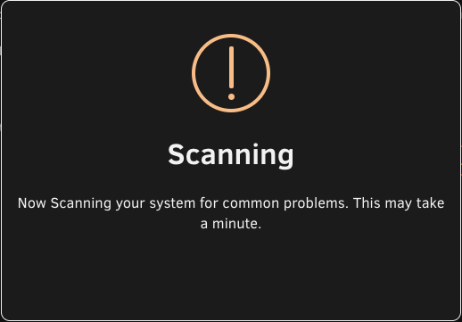

Recently, I have had a problem with the Fix Common Problems app. When I try to run it, all I get is the "Scanning..."pop-up, but the progress never increments. The only way to get rid of the pop-up is by pressing the Esc key.
Got that when the plugin got updated last time. Also, the check didn't run the scheduled time. Reboot solved it.
Edited by Niklas
Unfortunately, I have rebooted a couple of times, and it still isn't working for me.

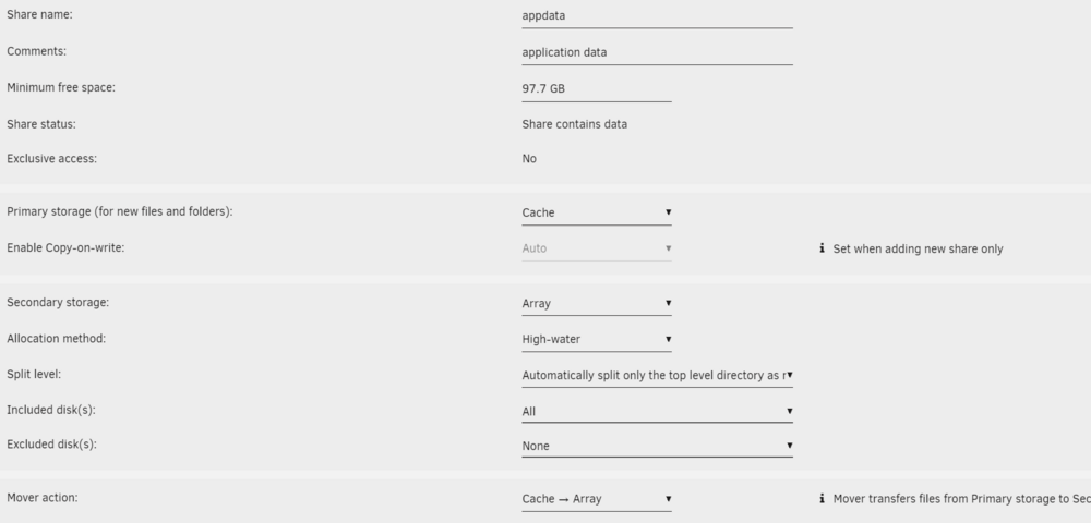

I guess I don't know what the hell I'm doing! Got this message:
"Default docker appdata location is not a cache-only share"
Seems self-explanatory. But when I try to "fix" the problem, I cannot figure out how to do it. My Appdata is located at:
/mnt/user/appdata/
I have ONE cache drive. A 1TB NAND SATA SSD.
I have ZERO idea what to do when it says the Appdata location should "reference a share that is set to be either Use Cache: Prefer or Use Cache: Only." WHERE do I set this? I don't see it in settings/docker. Do I have to set aside ("waste") a single drive in the array to put the Appdata on?
I don't remember getting this error until the last few weeks though my server has been running constantly since 2021. Why would it just start giving me this error? I don't recall changing anything but maybe I somehow screwed things up. I would appreciate any help.
Edited by TrainWreck
grammar error
Shares>appdata
43 minutes ago, wgstarks said:
Shares>appdata
 Thank you.

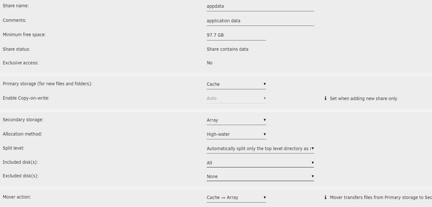

I have that setting to: screenshot-192_168_0_200-2024_06_25-17_07_25.thumb.png.b2a4b6199ade458e965f0a3c2ad11ec5.png
although I have no idea how to reset it if I need to. I tried stopping the array and looking for a way but couldn't find it. And according to the setting above, it appears that I DO have the share set to the cache (first) before it is copied to the array. SO I am confused why I am getting this message.
Here are the settings when I click on the Appdata share:
screenshot-192_168_0_200-2024_06_25-17_05_37.thumb.png.a11c69e9790071068a62592552702da6.png
So, again .. when the post that directed me here states:
"This is a performance only error.  If you have a cache pool, it is highly recommended that the appdata location (Settings - Docker - Default Appdata path) reference a share that is set to be either Use Cache: Prefer or Use Cache: Only."
it seems that I DO have it set thusly. And is why I am so confused why I am getting this error now. Maybe I'm just looking in the wrong places for the proper setting?
No. You would need to set Mover Action to Array->Cache. Just click the little triangle to change it and then click Apply. No need to stop the array. This will be equivalent to Cache Prefer. If you want Cache Only you need to also set Secondary Storage to None.
Awesome.
I now have it set to:
screenshot-192_168_0_200-2024_06_25-18_47_30.thumb.png.539d31a1990153b47a697b9d43ca5190.png
I re-ran FCP and "No Errors" for the first time in weeks.
FWIW .. this setting of "Array ---> Cache" seems backwards to me and is probably why I couldn't figure it out. In my (obviously, WRONG) thinking, it should be first "Cache" THEN to "Array." This is why I had such trouble with it.
Thank you!
The object of the setting is not to have appdata moved from cache at all but if any has been moved to the array in the past it will now be moved back to the cache if space permits.
Odd... I just had to reboot, and this time when it came up, the Fix Common Problems App started working.

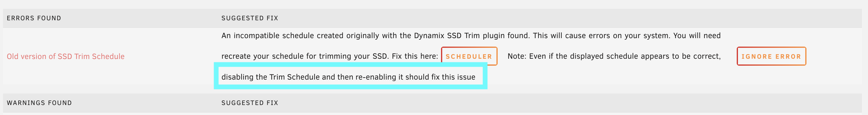

Hey guys, since the new version i receive this message now from fix common problems:
Jul 5 04:47:30 Tower root: Fix Common Problems: Error: Old version of SSD Trim Schedule
According to the changes i guess this has something to do with this:
Added: Check for incompatible cron file created by Dynamix SSD Trim plugin
But i dont have that plugin installed. How am i supposed to fix this issue now?
Same, just started getting this July 5.
Edit because I can't read clearly. In Fix Common Problems it says to disable and re-enable to fix. Did this and re-ran Fix Common Problems and it's not reporting it anymore.
Edited by jungle
I am not smart.
Also getting this new SSS Trim schedule error.
I’ve disabled and re-enabled and still have the error. Even tried changing the time.
Any help would be appreciated, thank you
Go to Settings>Fix Common Problems and you’ll see the suggested fix along with links and instructions.
The description tells you exactly what to do.  Go to settings, schedules, SSD Trim, make a change any change and hit apply.  Problem fixed
