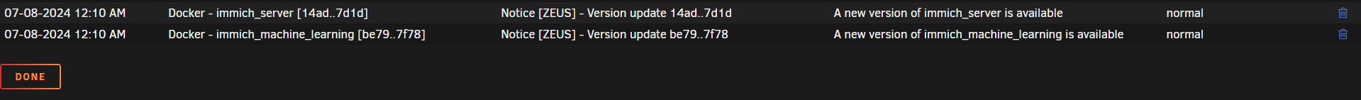

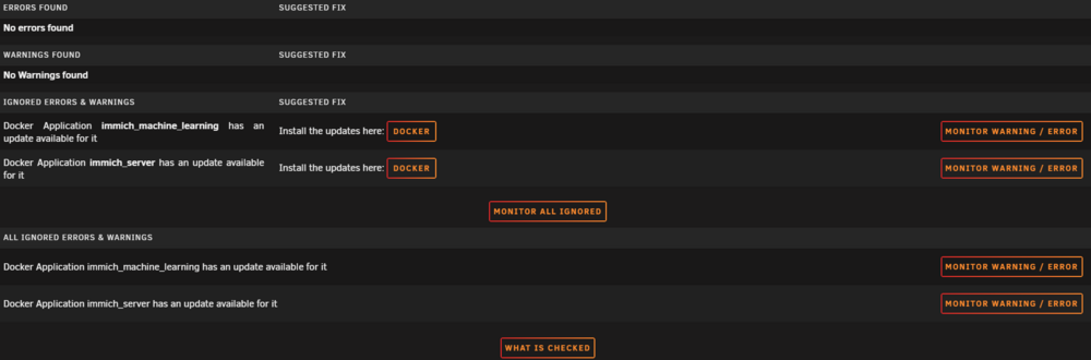

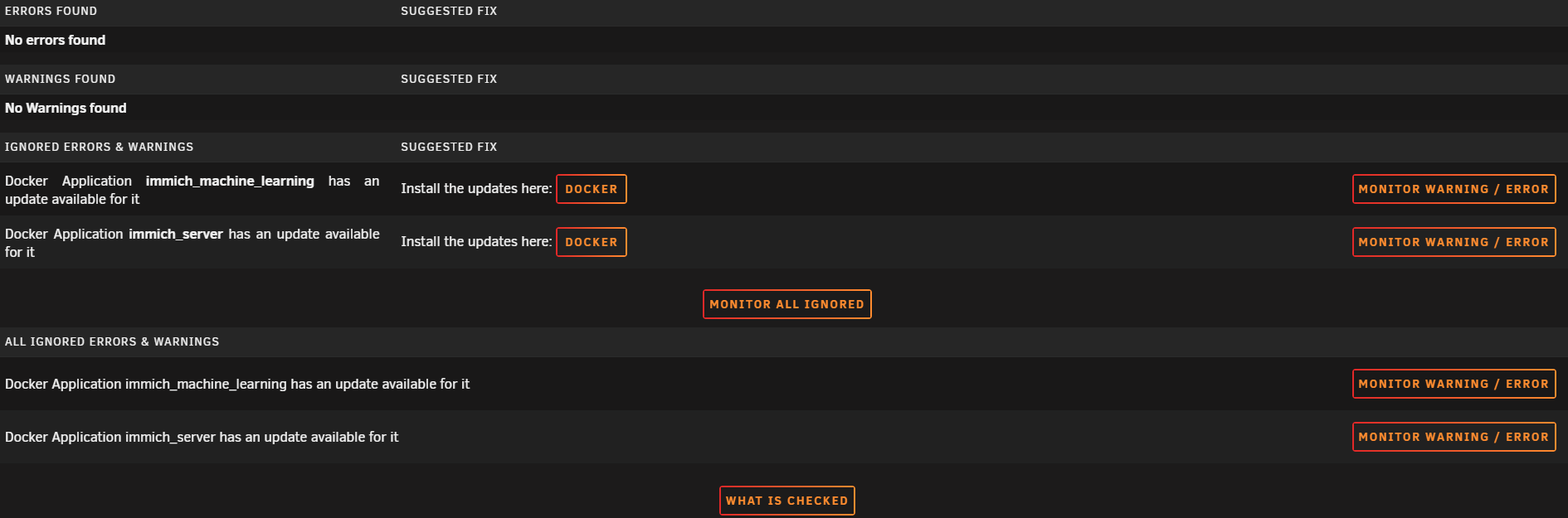

Hello Team,
I still get notifications when ignored.
I have immich installed with docker compose and have marked it as ignored for update notification and still get the notification.
Additionally, no update is available, still the docker tab shows update available.
Please provide a solution.
Thanks
Screenshot from Plugin:
Screenshot from Notification Archive from this morning.:image.thumb.png.c024f3cd739dc0db48a364aa114094cf.png
Thanks
