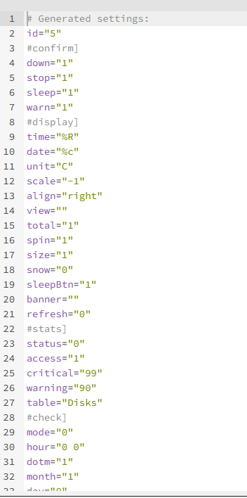

Hi All, I have just started getting the following error when running Fix Common Problems -
/boot/config/ultra.cfg corrupted
A number of things I have tried to resolve the issue -
* Renamed ultra.cfg to old.ultra.cfg then copied ultra.cfg from a USB Backup from a number of months ago, rebooted and error still appears (now is listed twice, one for ultra.cfg and another for old.ultra.cfg)
* Deleted ultra.cfg and rebooted hoping that Unraid would rebuild the file (it did not) so copied back saved copy of file.
As far as I can tell it does not seem to be affecting the usage of the server, no other errors other then in Fix Common Problems.
I can still open ultra.cfg via the UNRAID file manager and see the contents of the file.
Any ideas? should I be looking at replacing the USB with another?
unraid-diagnostics-20250119-1448.zip
It's a valid file, but for some reason PHP thinks its corrupt (due to the "]" at the end of the comment lines).

It looks like its part of another file dynamix.cfg (but corrupted).  I'd delete it

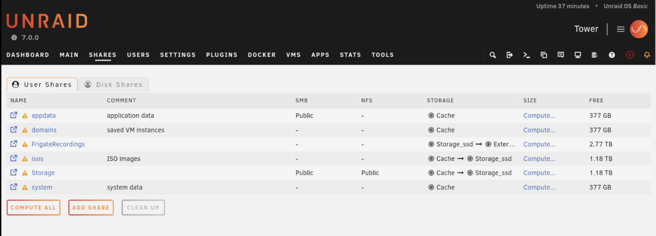

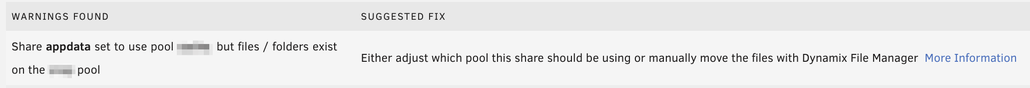

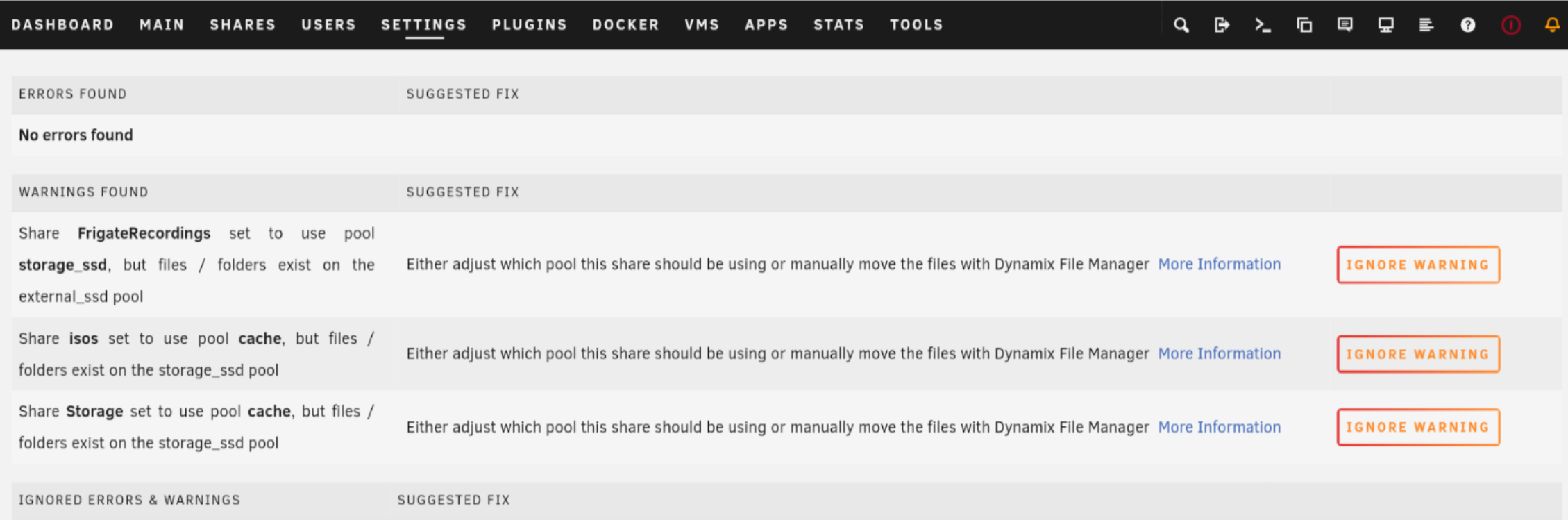

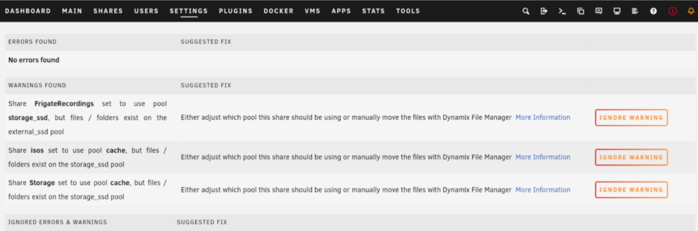

Possible false positive on unRAID 7.0:
Share XXXXXXXXXXX set to use pool cache, but files / folders exist on the storage_ssd pool

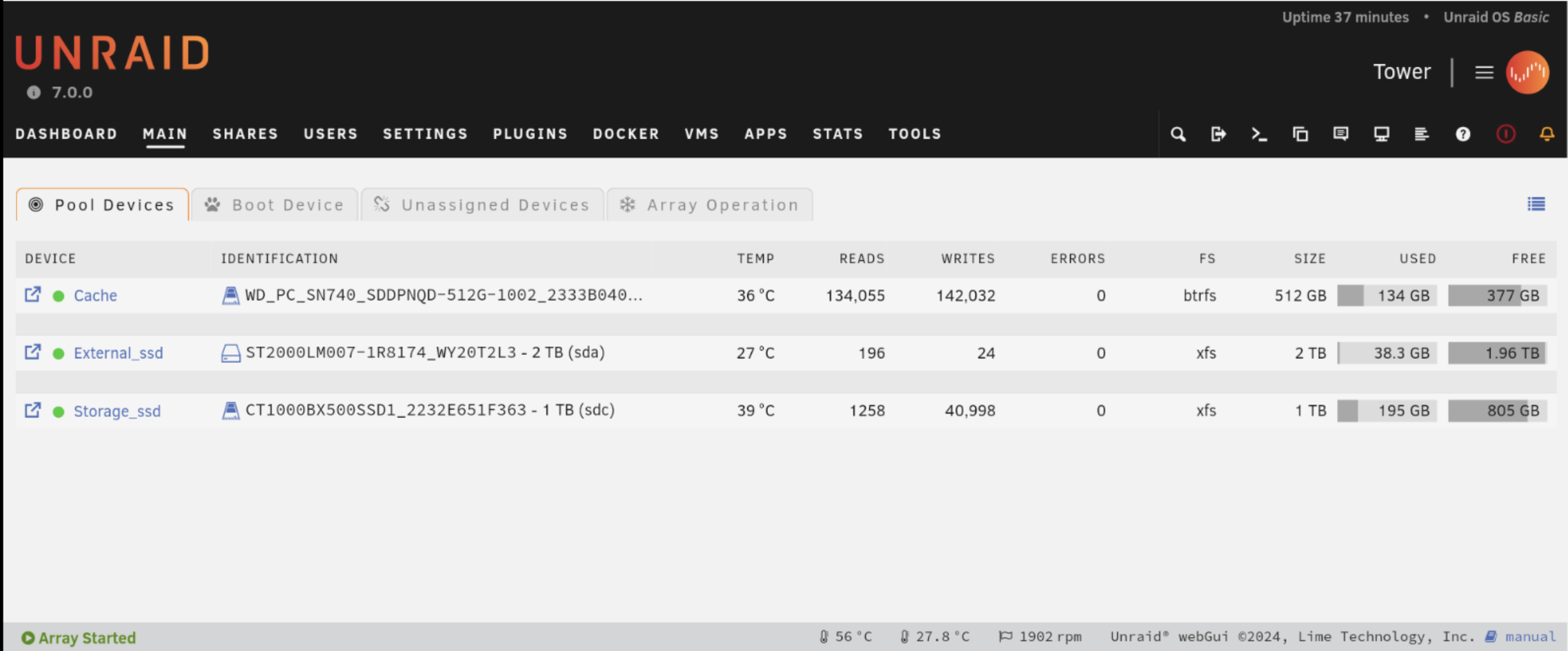

I moved to unRAID 7 this week and I now have an array-free setup on one of my servers.
I have 3 pools as below:
Cache: internal NVME drive
External_ssd: external 2TB drive for archive of Frigate recordings
Storage_ssd: internal 1TB SSD
Shares set up as below:
I get the following warnings in FCP for the shares using more than one pool:
I would have thought that this was the desired behavior and not something to be warned about?
Files should exist between the primary & secondary storage locations as per the mover settings.
shareDisks.txt:
appdata                           shareUseCache="only"    # Share exists on cache
domains                           shareUseCache="only"    # Share exists on cache
F---------------s                 shareUseCache="yes"     # Share exists on storage_ssd, external_ssd
isos                              shareUseCache="yes"     # Share exists on storage_ssd
S-----e                           shareUseCache="yes"     # Share exists on cache, storage_ssd
system                            shareUseCache="only"    # Share exists on cache
Full diagnostics attached:
