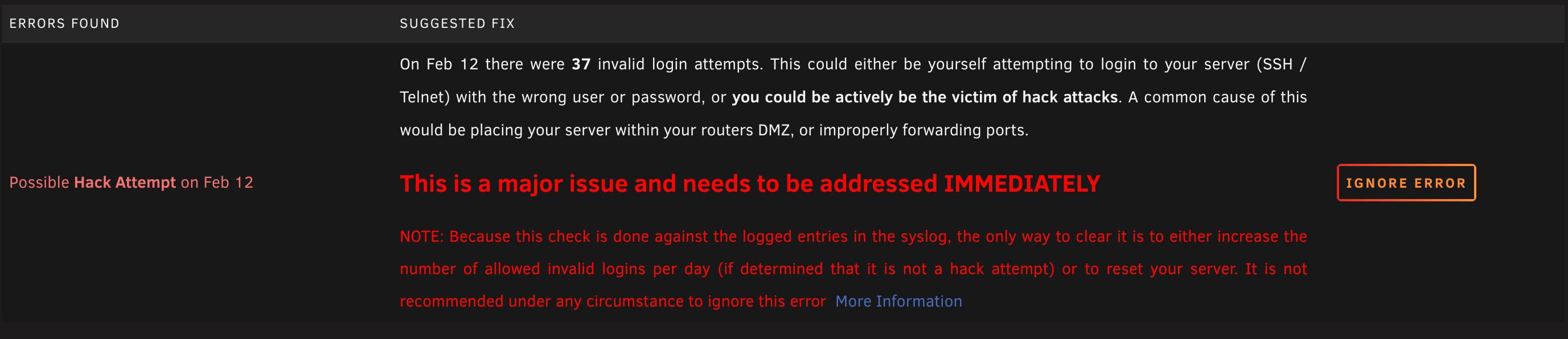

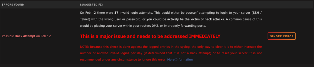

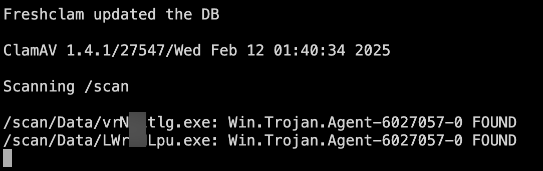

I encountered this error multiple times and ran ClamAV to remove some of the findings;  but I'm still wondering what we can do to secure and protect ourselves.   Prior, we had Connect enabled with SSL/TLS - nonetheless, we feel this caused us to be exposed as our password was plain text apparently?
I’m attaching our diagnostic as requested.
Edited by ich777
Deleted Diagnostics
I'm attaching our diagnostic as requested.
You have your Unraid webgui exposed to the public internet. what do you expect? thats like leaving your car with keys unlocked along side a sign with "free ride"
Edit: Oh holy moly, everything is publicly rachable 💀
Edited by Mainfrezzer

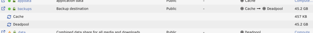

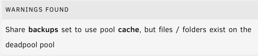

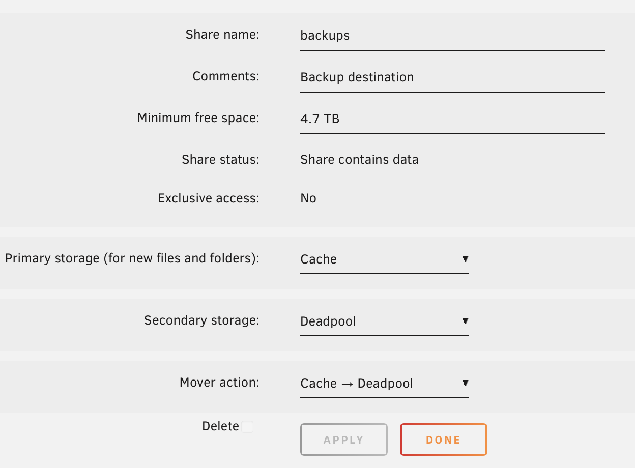

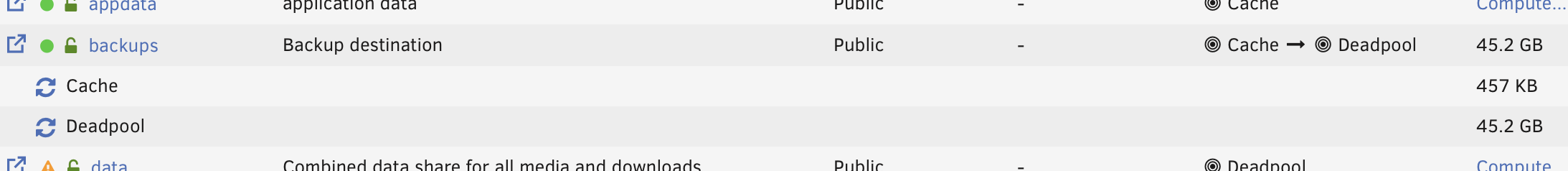

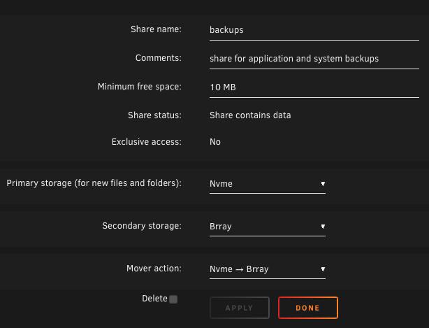

I've recently replaced my array with a ZFS pool and now I'm getting a load of "Share XXX set to use pool cache, but files / folders exist on the YYY pool" warnings. I've gone through and checked all my shares, and all my files seem to be on the correct primary/secondary storage as defined in the share settings so I can't figure out why I'm getting this warning.
For example:
And here is the configuration for the share in question:
So based on the above, I would expect to have files on both Cache and on Deadpool, and certainly when I look at the share contents this holds true:
So as far as I can tell, I only have files for this share in the correctly configured configured locations - o why is FCP throwing these warnings? As far as I can tell, it looks like I'm getting this warning for all shares that are configured to use my ZFS pool as secondary storage.
Edit: Just to add, I noticed a few posts back that there were a few other reports of a similar issue. I've checked all of my docker mapping and every single one is mapped to /mnt/user/.... with one exception which is mapped to /mnt/cache (and the share in question is set to cache-only) so I'm not sure if that's related or not.
Edited by Lumpy_BD
Just like Lumpy_BD I also just converted my server to ZFS pools and finished migrating data back to it. All my shares set to cache primary array secondary are getting a warning in "fix common problems" about files/folders existing on the secondary. Looks like the checks aren't taking into account the secondary folder at all in the scan.
alexandria-diagnostics-20250222-0723.zip
I can't wrap my head around why anyone who has switched to using ZFS pools INSTEAD of an Array is using a secondary location along with mover.
That's how you absolutely decimate your performance.
Make the ZFS pool your primary location and don't use a secondary. Set all shares to use Exclusive mode.
Edited by Espressomatic
