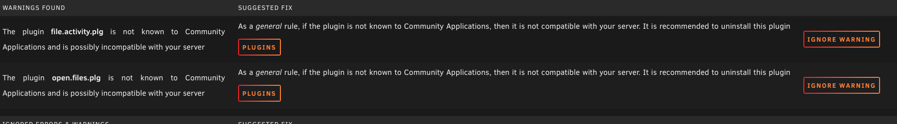

Some one is very wrong with the Plugins or the Repositorys of @dlandon. @Squid
I don't see/can find the GitHub Repositorys of this. Have GitHub are strong Bug and deleted Repositorys?
Description: Investigate at Settings / User Utilities / Fix Common Problems
Importance: warning
* The plugin enhanced.log.plg is not known to Community Applications and is possibly incompatible with your server
* The plugin file.activity.plg is not known to Community Applications and is possibly incompatible with your server
* The plugin libvirt.hotplug.usb.plg is not known to Community Applications and is possibly incompatible with your server
Importance: warning
yes now this morning I have this also.
I do not know why the author chose to delete the repositories, but that is unfortunately out of my hands, and at this time I have far too much on my plate to be able to fork and republish the plugins.
The notification from Fix Common Problems is correct, as the plugins are currently unknown to CA, but I do not see any reason for these in particular to be uninstalled as there are no compatibility or security issues with them as far as I know.  But keeping them or uninstalling them is however entirely up to you guys.
Maybe in the future the author will reactivate these plugins, but that decision is entirely out of my hands.
Thanks Squid.
Good to know fix common problems and CA are working correctly.
I'll keep an eye on the specific plugin threads that are effecting me to see if some information arises there.

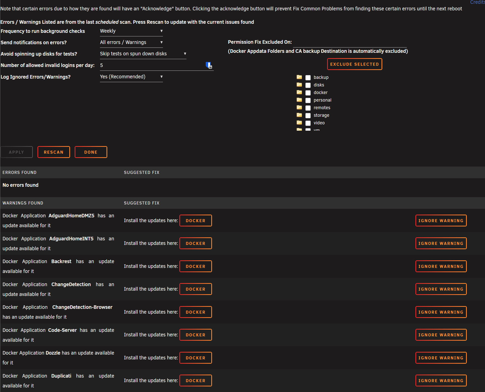

@Squid for the people using docker compose or managing dockers without unraid directly could you add a setting to ignore updates errors?
For some reason if you use docker compose Unraid is not able to read the images versions and we get this warnings all the time

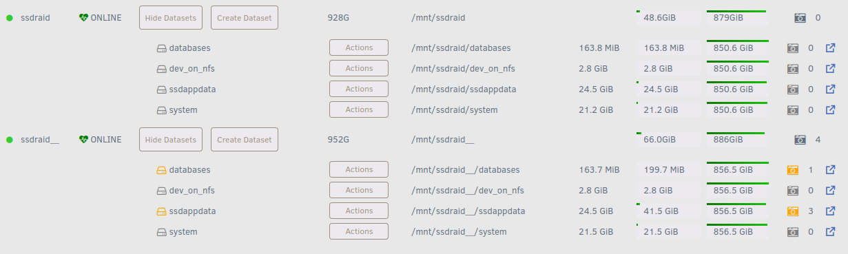

I got this warning:
“Share databases set to use pool ssdraid, but files / folders exist on the ssdraid__ pool”.
[in the message is ssdraid__ (two underscores)]

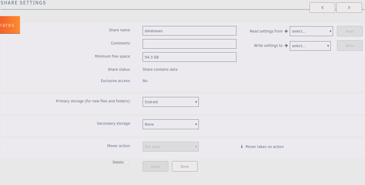

It applies to four shares. And everything happened after that:
I had a ZFS pool named Ssdraid, on it those four previously mentioned shares. I needed to swap the disk. I created a new ZFS pool named Ssdraid_ (one underscore) on the new disk and copied all the data from the Ssdraid pool. Then, from the Unraid UI, I renamed the Ssdraid pool to Ssdraid__ (two underscores), and renamed the Ssdraid_ pool (one underscore) to Ssdraid.
And now, all in all, I don't know where the error is, because in the share settings everything looks fine to me:
It may be important, but these four shares are ZFS datasets.
Edited by jaclas
ZFS is an Depuplicated Filesystem and his Datasets are an Filesystem in the Filesystem. So my wisdom.
Maybe ZFS or another are have underground processes to this files and deleted or give this free in the future. When you don't see this in the file manager, Krusader, Shell, MC, ...
@Squid knows what he specifically checks to show this message, so I'm hoping for some guidance. I haven't found anything myself by looking for links in the file system and processes.
ps. Because, all in all, I'm guessing that maybe it's a false alarm, and it's actually worth investigating to possibly correct it.

Additional key information in my opinion:
I disabled the ssdraid__ pool and the server is running completely normally (all applications data is on ssdraid pool) and the Fix Common Problems plugin shows no problems now.

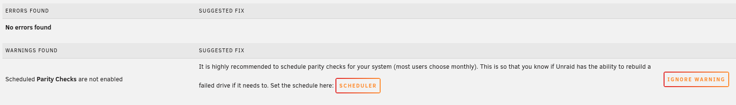

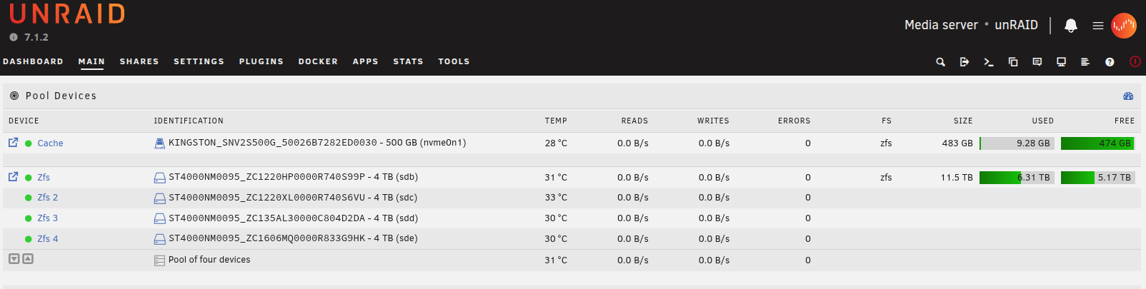

I'm on unRAID 7.1.2
Fix Common Problems: 2025.05.29

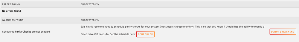

I don't have an Array
I have two ZFS Pools:
One nvme for the Cache and a raidz1 with spinning discs.
When I run the Fix Common Problems it says:
Scheduled Parity Checks are not enabled.
It is highly recommended to schedule parity checks for your system (most users choose monthly).
This is so that you know if Unraid has the ability to rebuild a failed drive if it needs to.
Set the schedule here:
In the <scheduler> I can't see the option to set a parity check.
Is that a false positives in the Fix Common Problems plugin - or is there something I need to setup?
Ignore it. I'll fix the conditions for triggering it.
Thanks for reporting :)
