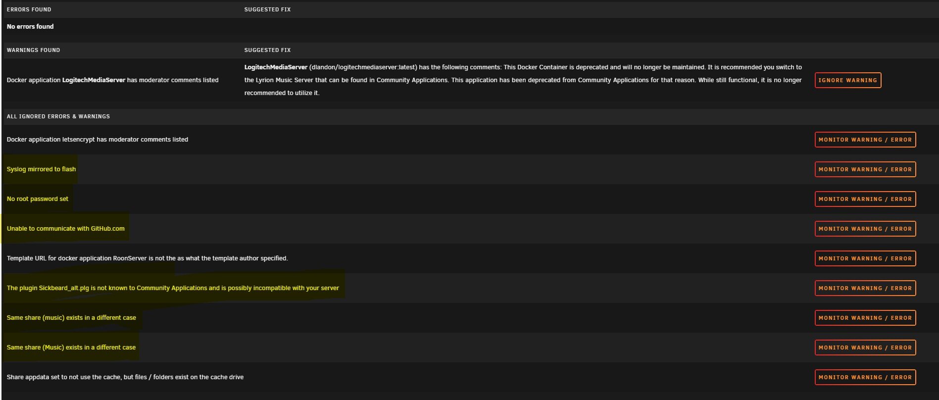

I'm getting al sorts off false errors and warnings:
  • root has no password (it does)
  • syslog is mirrored on the flash drive (it is not, mirroring is OFF and log folder is empty)
  • multiple folder music and Music (there is no 'music' anywhere)
  • deprecated plugins i havent used in years and are nowhere to be found

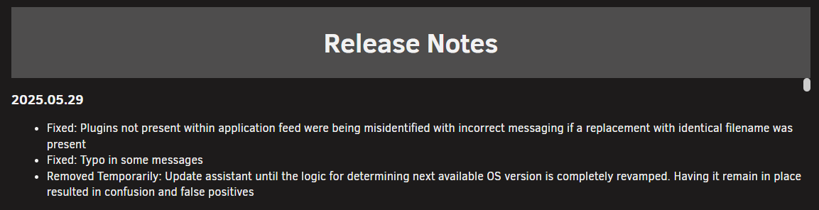

  • Mainly because my keyboard is worn out from replying "Uninstall Advanced Buttons", today's update features an "Update Assistant" which sits on the Tools Menu (next to Update OS)   This perfo
  • kennymc.c
    kennymc.c
    The included Update Assistant tool still shows 6.12.10 as the latest version. Is this a know issue as the update process has changed with the previous version?

19 hours ago, jowi said:
Is this plugin still relevant?
What version of unraid are you running?
7.0.1.
You'd have to show me your diagnostics after running a scan
I've removed the pugin atm, will re-install it later today or tomorrow and post the diagnostics.
unraid-diagnostics-20250613-1003.zip
The yellow ones are weird:
Edited by jowi
I reinstalled the fcp plugin, ran it, and created the diagnostics and took the screenshot.
The sickbeard_alt.plg it referres to has been removed years ago...
Edited by jowi

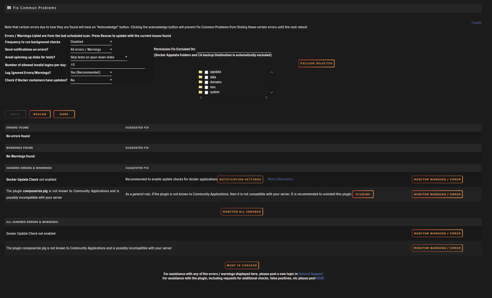

Hi folks,
I can no longer find the Update Assistant. on two Servers. Already removed and reinstalled fix common problems.
Did I miss something? Ist that feature deprecated? Or ist it just moved somwhere I no longer find it.
P.s.: Yes I searched a lot before I asked that question and read through this thread but I did not find any hint

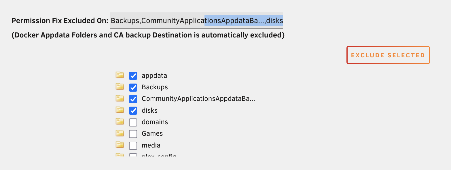

I just found a bug in the "Permission Fix Excluded On:" setting - if you select a share with a long enough name that it's truncated with an ellipse (such as "CommunityApplicationsAppdataBackup") and click Exclude Selected, the share will not be excluded, because it will include the elipse in the setting and then not match the actual share name when running the Docker Safe New Perms tool:
Also, it doesn't pre-select the right shares in the list, so it's easy to accidentally undo an exclusion when adding a new one. I guess that's less of a bug and more of a feature request.

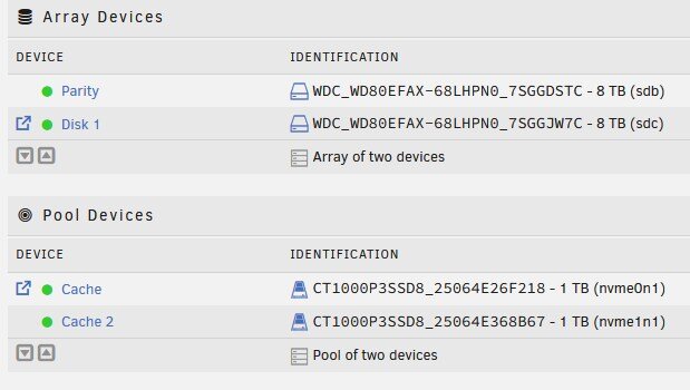

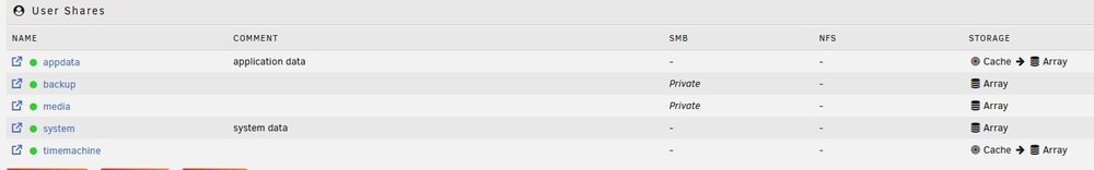

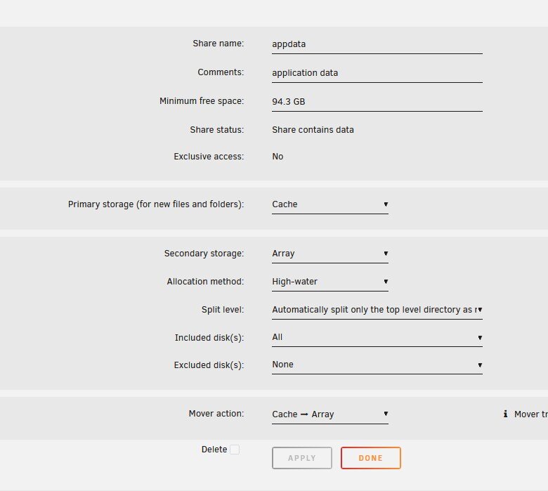

Not quite sure how to fix this but im getting this error within the plugin but dont see the option its mentioning to fix "Default docker appdata location is not a cache-only share" any help would be appreciated
nas-diagnostics-20250817-2202.zip
On the shares tab, appdata, click on the icon to the left of the share name to browse the share. You'll be able to see where each item is located. Something is still on the array. It could even be an empty folder.
If it's just an empty folder you can delete that. If there's data you'll need to get it moved and deduce why it's there if it comes back.
So do i need to redo my docker containers to then point to "/mnt/cache/appdata/" instead of "/mnt/user/appdata/"
Not explicit.
What's your Cache/AppData ... Configuration?
user is the default.
You are using Exclusive Share Mode?
Maybe its a Docker Container, Script, ... thats are using the wrong Paths.
But the Share Settings are the importants. Than we can see the next steps.
2 minutes ago, Revan335 said:
Not explicit.
27 minutes ago, sekrits said:
You don't do that!
Its better thats the System Shares are Cache only and not moved to Array or any mover Actions.
Thats prevent many issues.
You can used than exclusive Shares and the /mnt/user default Path.
Than its your issue correct.
The Cache have Files/Data and the Array Disks too. Some Files/Data/Folder are in used and than can not moved by the mover than.
And you have significant Performances issues than you have the faster Cache with Flashdisks and the slower Array HDD Disks + the Fused Layer.
You can stop all Docker/VM Services or other than have Access to the System Shares like appdata. Used the Mover for moving all of this Shares to Cache, check you have no Data on the Array. Change the Share Settings to Cache only. Check the Exclusive Share state. Double Check you have no Data on the Array from this System Shares.
Check your Paths on Docker, VM, Docker Container and Co. for the correct Paths.
You can started the Docker/VM Services again.
Check everything its working.
Maybe a Backup before this all Steps.
