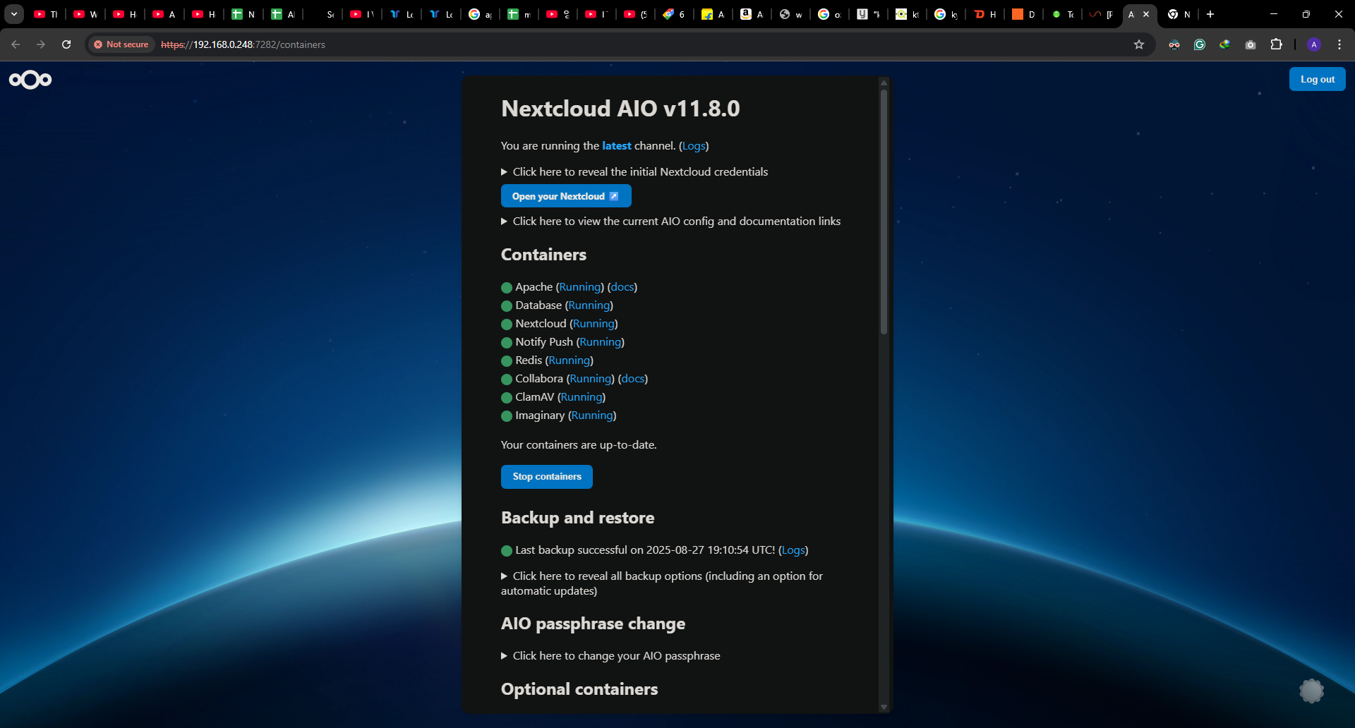

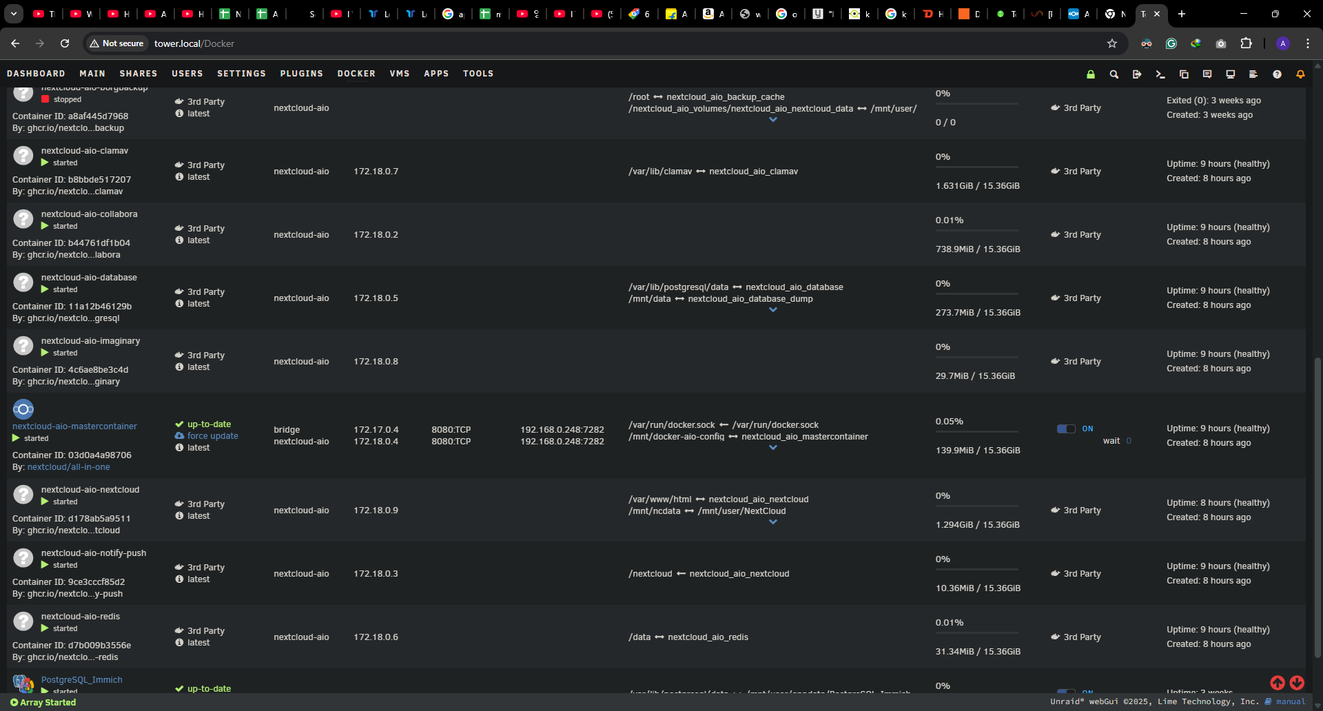

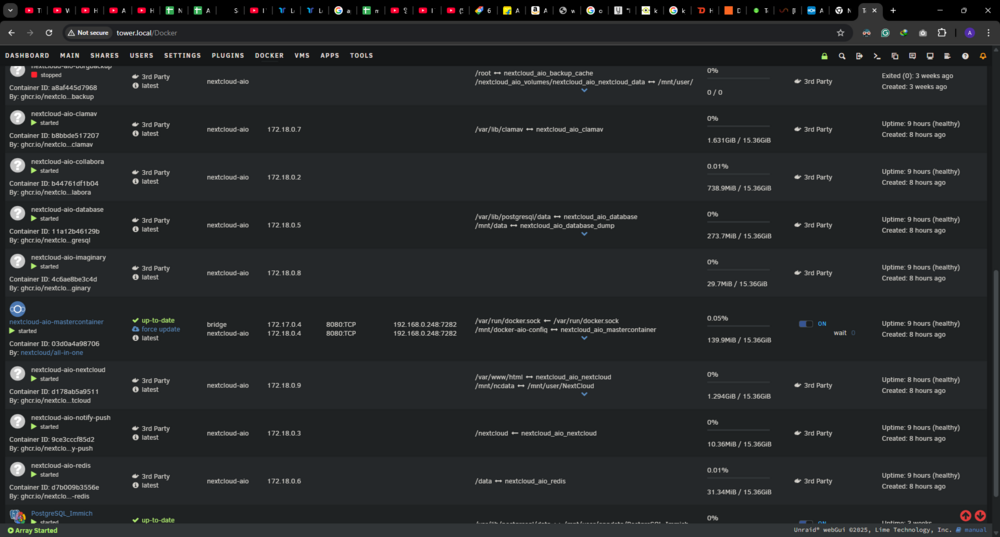

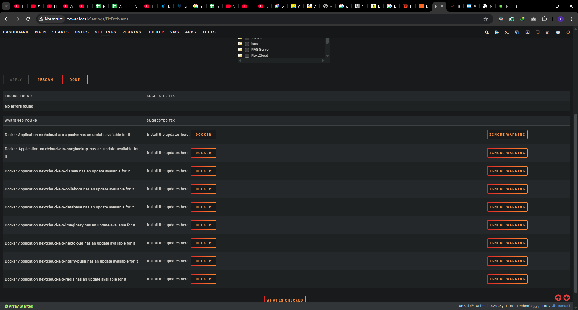

I have updated my Nextcloud AIO container on my Unraid 7.1.4 (screenshots attached). I did it from the container itself (for child containers) and the unraid Docker dashboard (for AIO master container).
Yet even after doing so, the CA plugin "Fix Common Problem" says the container has updates available. Again, screenshot attached.
Upon going through a lot of forums and Reddit doom scrolling, I got to know that CA FCP fetches update data from somewhere else, and Child containers, when updated via AIO Master Container, are not recognised. Hence, the warnings. It's better to leave it as is, else we can break the Official Update path of AIO updates.
I believe the only solution for this is to find a way for CA FCP to recognise 3rd Party updates. And if I am not wrong, it has been an issue for a really long time now. Can we expect a fix for this?
PS: I might not have an idea of what I am talking about as a Mechanical Engineer; these things are usually beyond me.
Thank you.

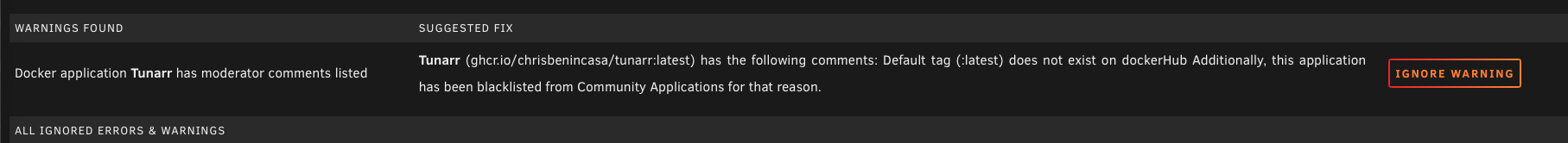

there may an issue with using ghcr.io repos? I noticed even when you use them such as ghcr.io/chrisbenincasa/tunarr it still adds https://dockerhub infront sometimes but maybe thats a template authoring mode bug, but doesn't seem to affect function except it's saying this has been blacklisted because its not on docker hub when the url is GHCR.io (GitHub repos)
perhaps this ties into a wider community app issue? not really sure

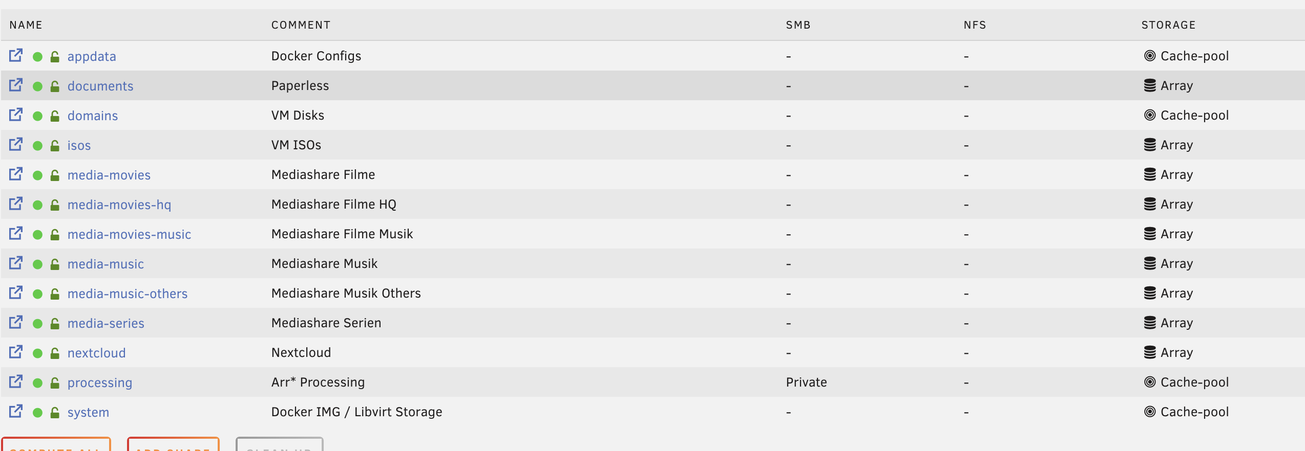

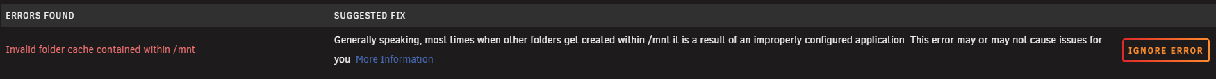

Hey, FCP reported a warning today that I don't understand...
“Invalid folder cache contained within /mnt”
Can someone help me?
diagnostics-20251102-2255.zip
Regards
Regards

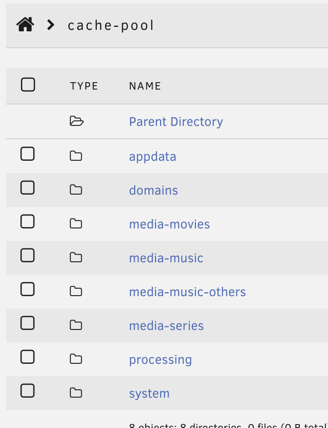

It's the (1) Share a Duplicate?
Do you have a Docker Container, VM, Script, ... that have cache in his Template? And created this after his Start.
When I see its right, its your Cache Drive Cache-Pool.
Edited by Revan335
Sorry, but what do you mean by “(1) Share”?
I don't have any duplicate shares.
I found an appdata config that pointed to “cache.” I fixed that. Unfortunately, the error is still there. What I don't understand is why the “media-*” shares are located on the cache pool. There are only a few folders/files in there.
Edited by nzane

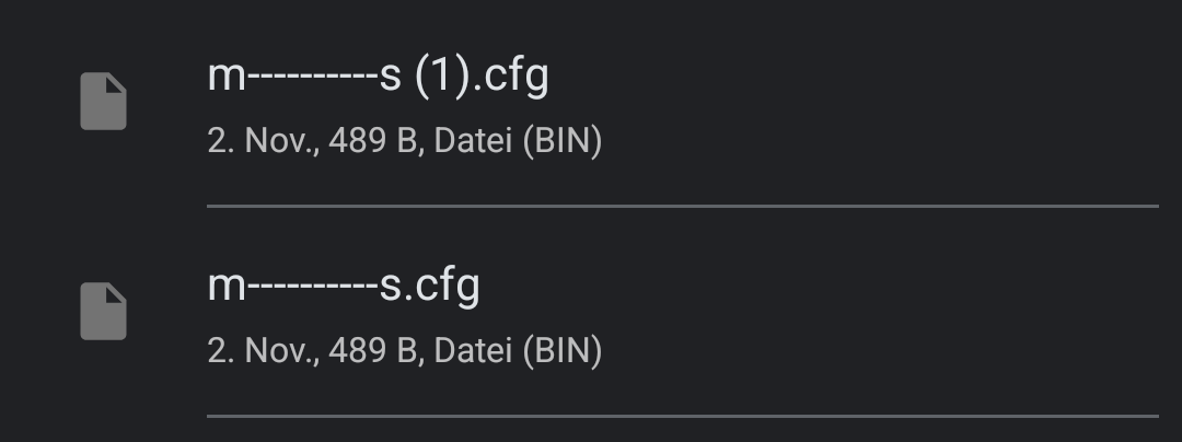

I mean this:Screenshot_20251103-000808_Dateien.png
We fixed this?
Change the Docker Template?
Do you deleted the empty/wrong Appdata Folder?
And than Rescan the Fixed Common Problems to check is the Message persist.
Maybe you write to the Cache Pool and than moved the Mover this (for Example the media Folders) to the Array.
Edited by Revan335

I would understand that with the mover if I had a share with second storage. But in my case, the shares are either only on cache or only on array.
You have a ZFS Cache Pool.
When the media Folders not created through a Docker Container or others and not up-to-date for example today or so, than this maybe relics from the past.
Was this Folders or Shares in the past a Part for example Cache = preferred?
You can tried with the mover to moved this Folders to the Array. You can change the Share Settings temporary for that and than start the mover.
When the mover don't moved this completed to Array than its that maybe ZFS Datasets.
You can removed/destroyed this for example with the ZFS Master Plugin or the Terminal Commands for ZFS.

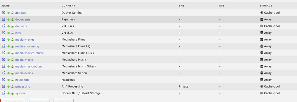

Hello, the server has been up and running for four days. I first configured the cache and array and then set up the shares. I have no idea how this could have happened. I then installed all the Docker containers.
I have now set the affected shares to cache -> array and moved the folders using the mover. In the end, I changed everything back.
Now the cache is clean and only contains the 4 shares that should be there. However, the error is still there. Attached is a new report.
nzaunraid01-diagnostics-20251103-1254.zip
You have no media Folders under Appdata or on the Cache?
All Cache Shares are only on the Cache?
All Array Shares are only on the Array?
Only the Shares that have Cache > Array, have Folders on Cache/Array?
In VMs, Docker Templates, Scripts, ... is no incorrect Folder Locations are set? For example a Folder Path to Cache directly but Cache is not exist than his Name was Cache-Pool for Example.
No.
Yes.
Yes.
I don't have any shared folders that are tiered or moved from cache to array. Cache-only and array-only shares.
I don't have any VMs or scripts (yet). I've just gone through all the Docker templates. All paths point to /mnt/user/...
EDIT: Rebooted Unraid and error is gone... Thanks for your help.
